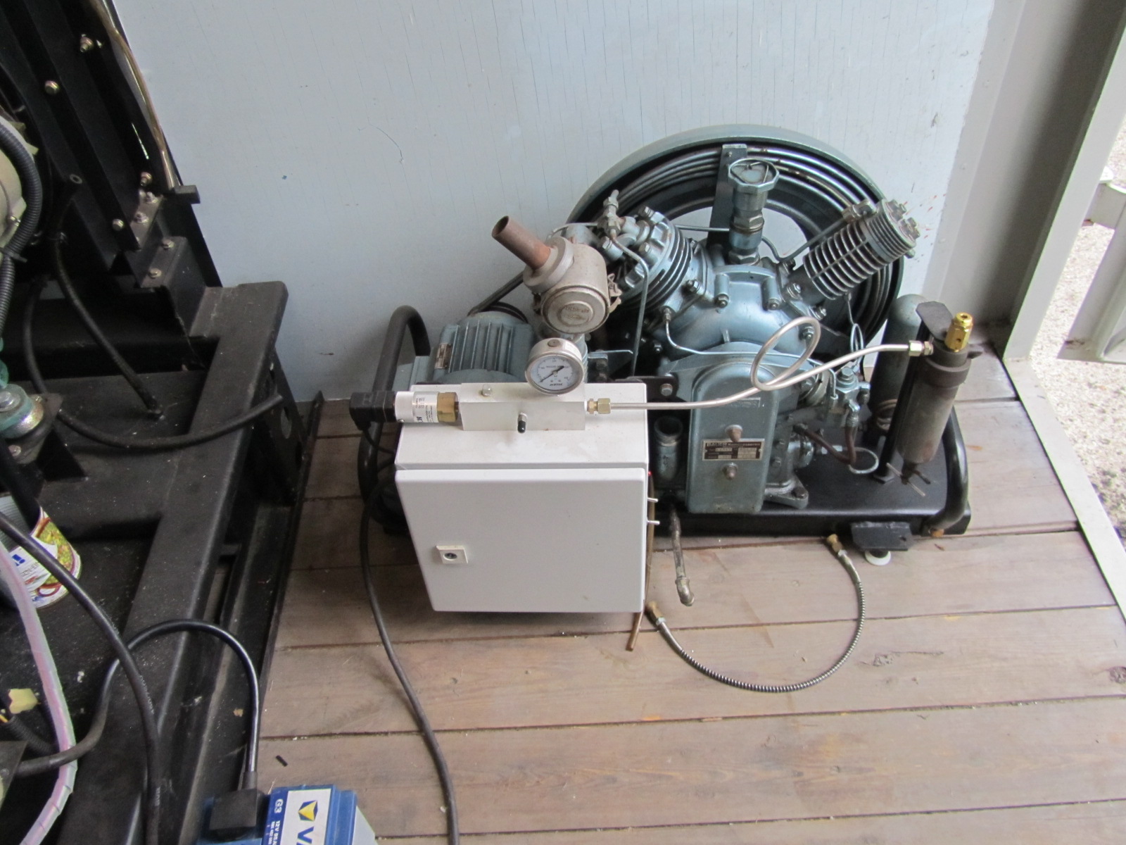

I will tell the story of my Bauer. I found just the pump laying in the mud at a scrap dealer in around 2000. I did not need it then, but for $150, I bought it anyway. I stuck it in the back of my garage. When I started shooting PCP, I decided to resurrect it. I first designed my controls then ordered all the parts. That took the most time, as I shopped world-wide to get the best parts at the best price. My pressure control switch came from California. My safety valve came from Australia. My electronic chassis and electrical enclosure came from Germany. I built a DC power supply out of parts I had on hand. I used a step down transformer I also had on the shelf. Because most houses in Europe have a 400 volt 50 Hz 3 phase service, I used a spare 1600 watt 4 pole 3 phase motor. I used a 24 volt DC 3 phase relay to power the motor I also had on hand. I made some extra SS tubing to connect my self made output manifold to mount my sensors, pressure meter and a male Foster fitting. I placed all of this on a piece of steel C channel with 2 carry handles. I estimate a total cost of less than $1,000 and a little labor.
This is not so unique ether. About 5 years ago, a friend gave me for free a professional compressor from a Dutch scuba club that had seized because it was left running without any attendance for a weekend. The pro compressors are usually 4 cylinder units and the forth stage seized. I repaired it in about an hour and sold it in an auction for 1200 Euro. These things are around and can be found. Consider the service carts that are used to charge the nitrogen landing struts on aircraft are often scrapped. They are called high Packs in the trade. I guess for those folks that do not know the business end of a screwdriver, need not participate, but for everyone else, this works really well and it is affordable.
