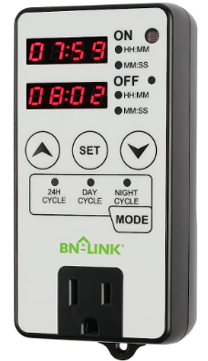

Or if you want to fill bottles, get a GX and a timer, like this.
The main thing is to ensure the timer can handle the pump amperage. The above works.
If you use a timer, how do you release the pressure? Aren't you supposed to open the relief/bleed valve before you start, so it doesn't start under pressure?
A good question. If you allow that timer to restart without opening the bleed valve on most compressors you are going to have a problem. It is also not possible to stop and restart the GX compressor motor this way as it has a momentary switch on the motor. Unless you rewire things, which I would not recommend on the GX series, the compressor motor will not restart after power has been removed and rea-applied. The cooling fans will, but not the compressor. You would have to manually open the bleed valve and restart the compressor motor each time.
Also, shutting off the GX at the power source after it has been running for a while isn't supposed to be done if I am recalling correctly. It is going to be fairly warm and that heat needs to be continually dissipated after the compressor stops. I don't know how much harm to the seals might occur when shutting it down abruptly with no fans running. On a Yong Heng, I routinely shut the compressor off completely while it is running, but I keep the coolant pump running so there isn't a spike in heat.
I don't see a problem using a timer or a wifi switch to turn off the compressor motor as long as the fans keep running, but any setup that starts the compressor motor automatically on the GX and many other compressors, is not OK. You would need to bypass the factory power switch on the compressor to do that. You would definitely need to have a good idea where the pressure is on a long fill so as to not go too high with an automated shutoff system.
