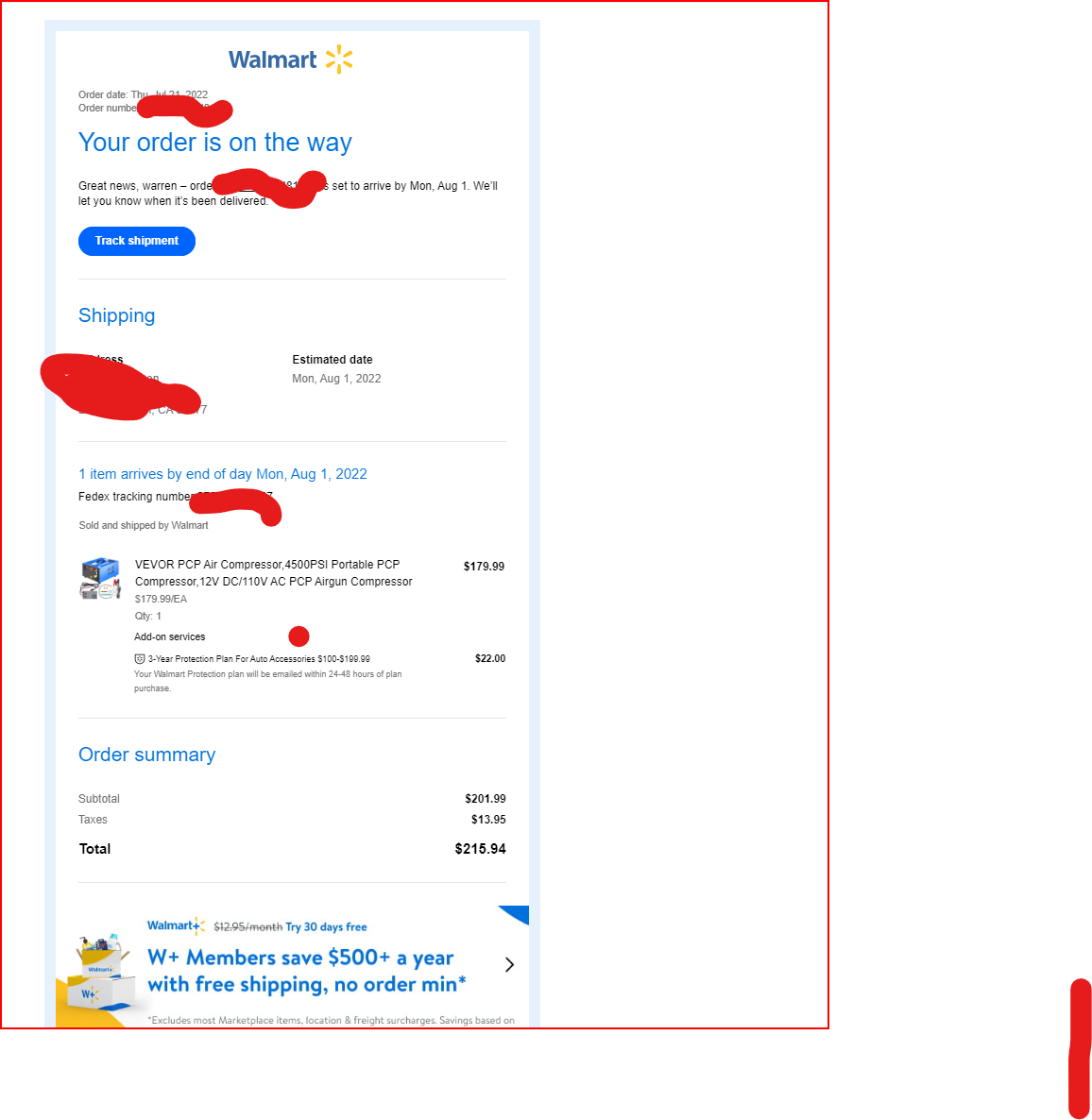

You are spot on my friend! Snobs. The smartest compressor buy I made when just getting started was this cheap Vevor from Walmart with the 3 year warranty. Lasted 14 months through hundreds of fills, and I have 7 airguns of which I shoot 5 days per week. Lasted until this weekend, I don't blame the unit. Applied to get my $ back yesterday. I am seriously considering upgrading to GX since Forge is available for support...and I'm getting most of my money back. 🤣😁
