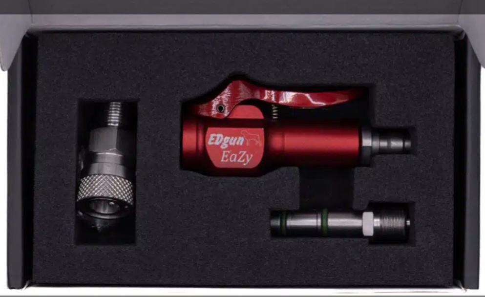

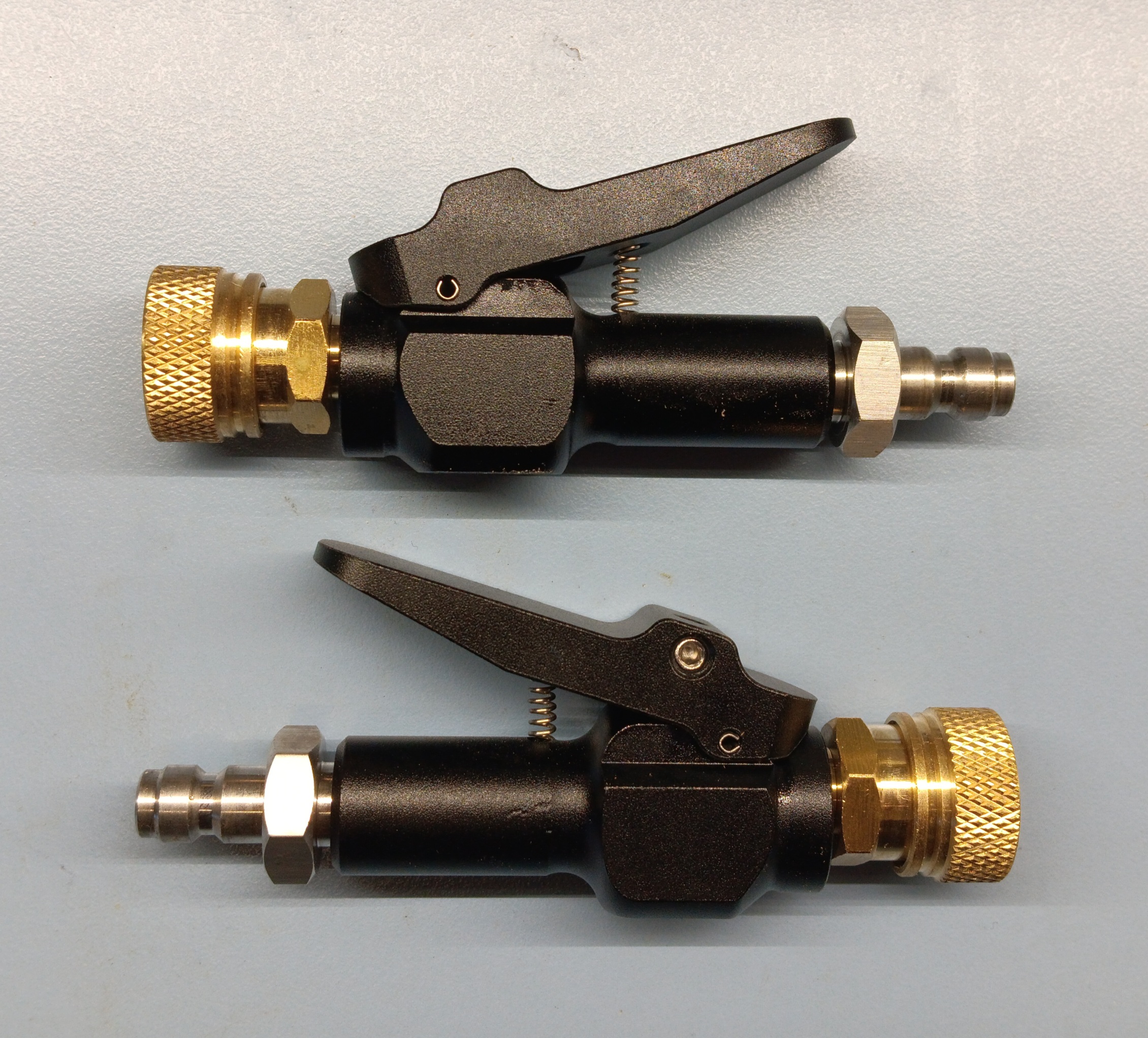

Would you mind sharing the tweaks to the AE one's? I have 2 Eazy fills the should be dying shortly.
Two comments:
I'm wanting to start an EaZy Fill rebuild program, the rebuild kits are complete and fantastic! It's the adjusting that ruins their confidence in the hardware.
There is no one-adjustment fits all adjustment. I have three of these cheap fillers from AE, I gave one away after I got it so others could see for themselves that it work as well as the EG one. I still have my EG one and I have rebuilt it twice due to poor 2*1.5mm o'rings that both the EG and AE fillers are struggling with.
The first thing I do after taking them out of the package is to tear them all the way down to parts and replace o'rings that are already chipped, shaved and broken upon assembly at the factory.
Once I have good o'rings in place, I use a good amount of good o'ring lube on all internal parts and reassemble very carefully. The filler will not work correctly the first press, no matter what I do, it will unseat and not reseat or not unseat fully. I frankly waste a LOT of air adjusting the grubs while flowing air into a bottle.
Sadly, the EG filler and the AE internals are not the same, the EG kist will not fix the AE and vice-versa.
