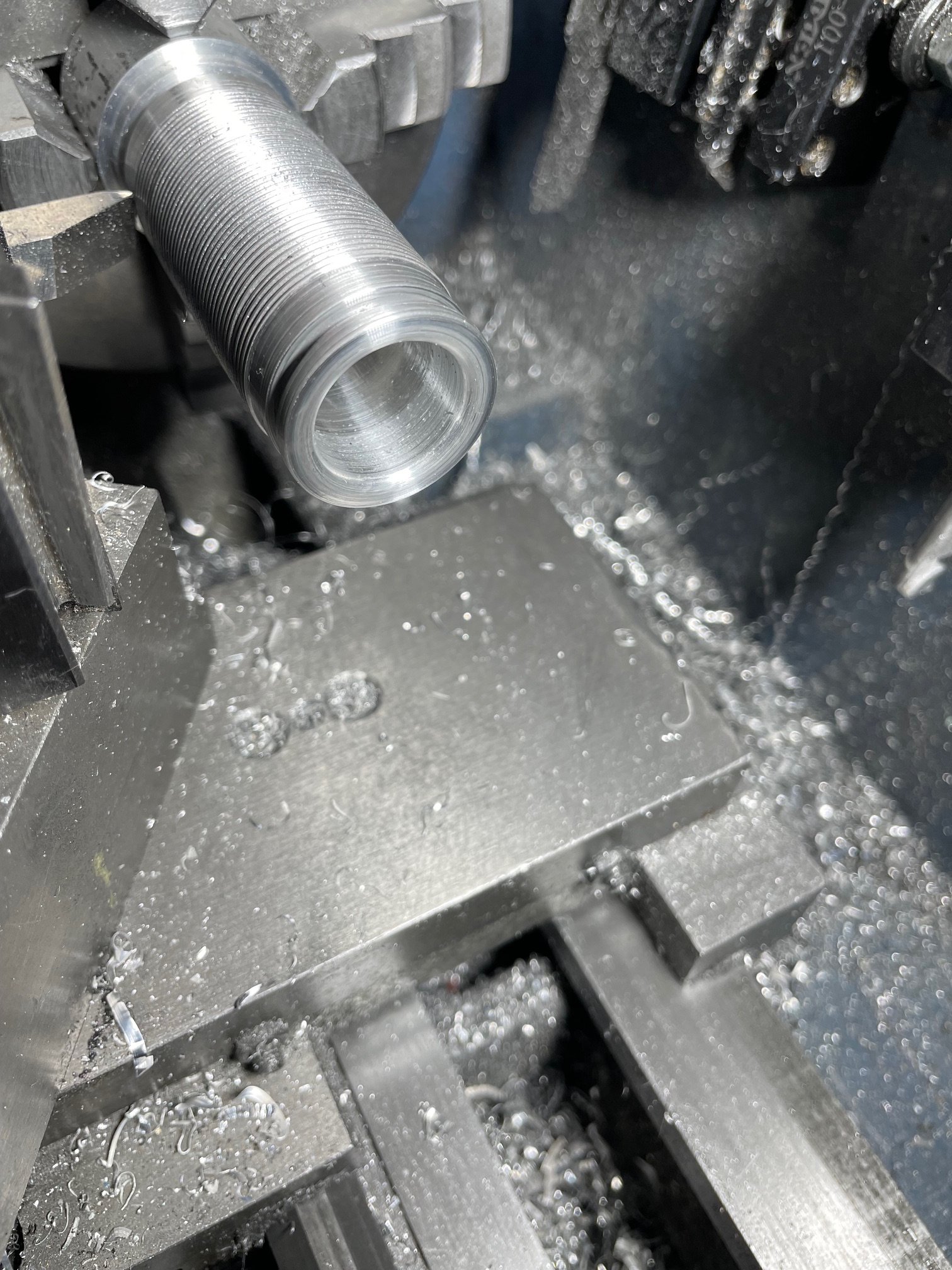

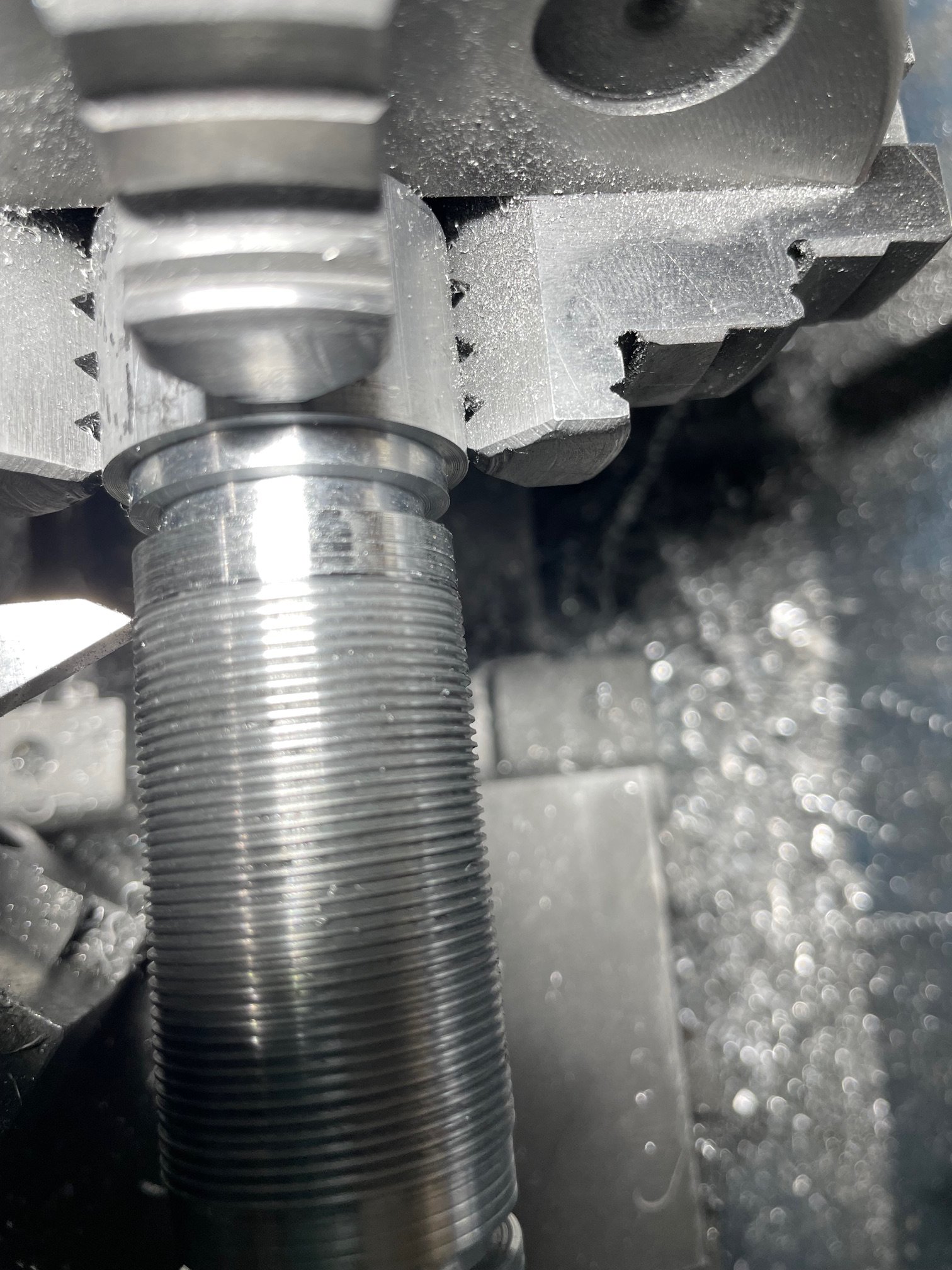

Still waiting on my Altarus reg. In the mean time, I'm making a coupler for one of my Gamo Urban tank to add 100cc capacity for more shot count.

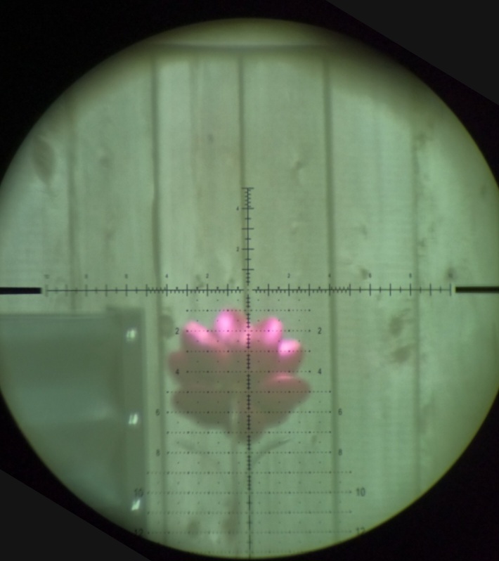

Put in a FX Heavy 1:16 500mm in my Maverick Compact, just because I could, was trying to see if it's shoot 22gr hybrids, yes it does but not as good as I want, but on the other hand, the AEA's 18.3's perking along at 940 are absolutely a pin driver at 30 yards SD of under 2.0...BUT using the slug port and a slug probe and 97ish (don't rightly remember) bar. Note to self, self DO NOT MESS WITH IT anymore.

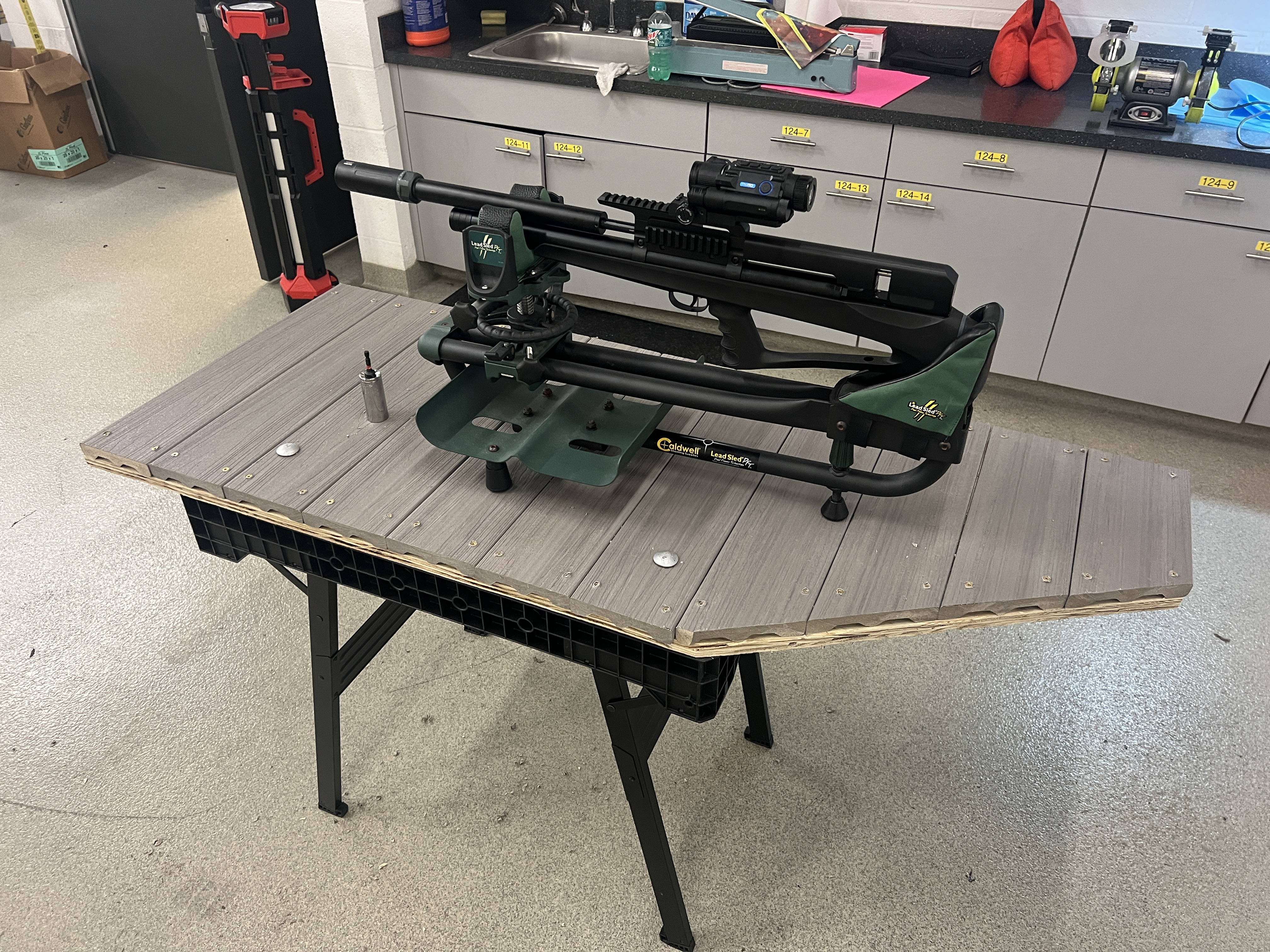

I put in a replacement huma regulator in my Concept Lite, I hope it solves the leak it has developed.
Just so I have it documented, because I didn’t have my Airgun notebook with me
Reg is set between 140-145 and at max TP setting I am getting 867 fps with 18.1 gr FX pellets. It’s within 10 fps of what I was getting with the old regulator that didn’t have any indicator marks for pressure on it. I will tune the hammer spring when I have the time.
The new reg for the first 25 shots was doing low 870’s, then settled right in to 867.
