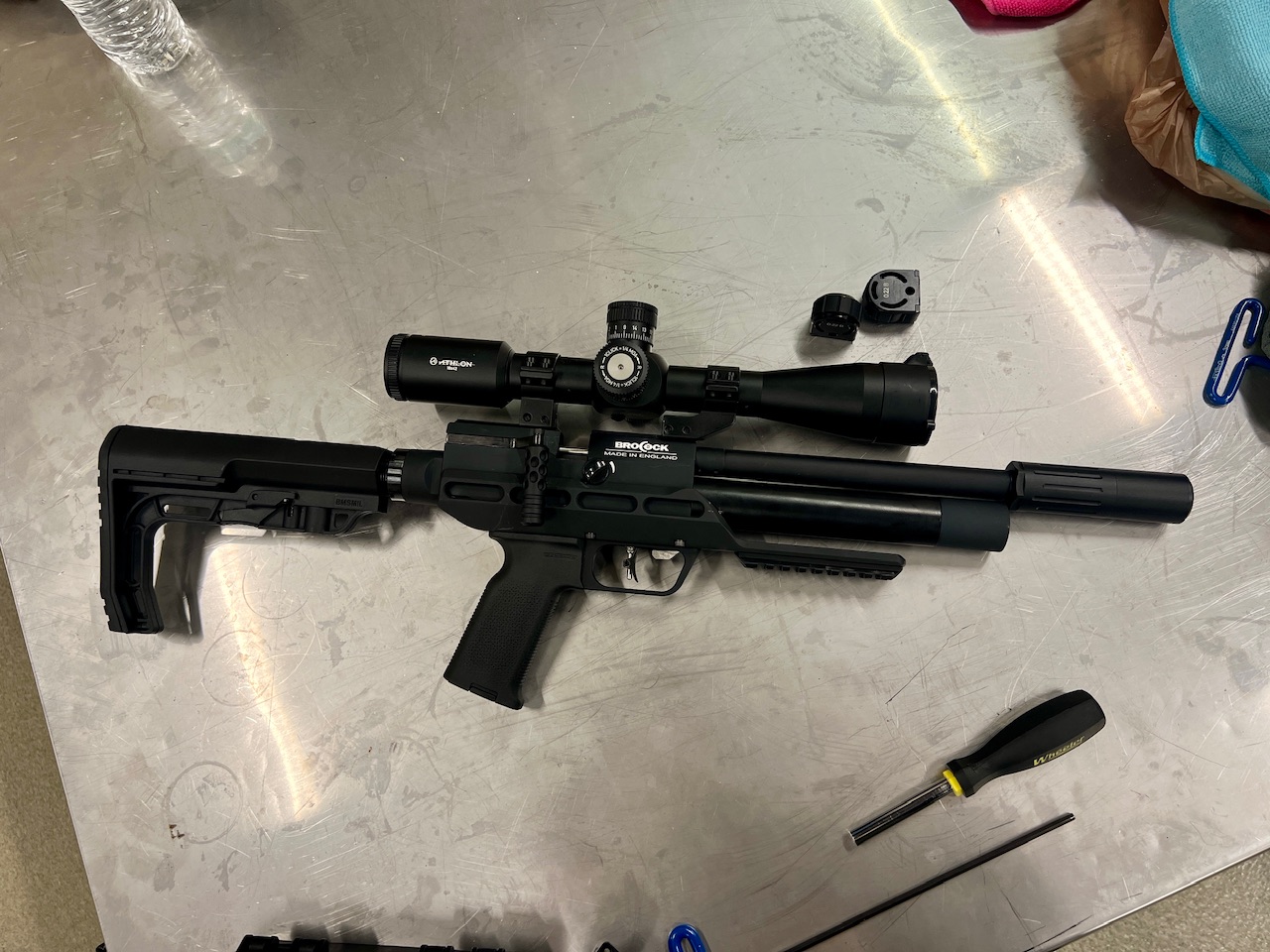

Spent a lot of time this weekend moving scopes around on different airguns - quest for the "right scope" pairing with each and everyone of my airguns. Learning that i like lower scope height whenever possible - except - bullpups seem to be more comfortable to me with a higher scope height.

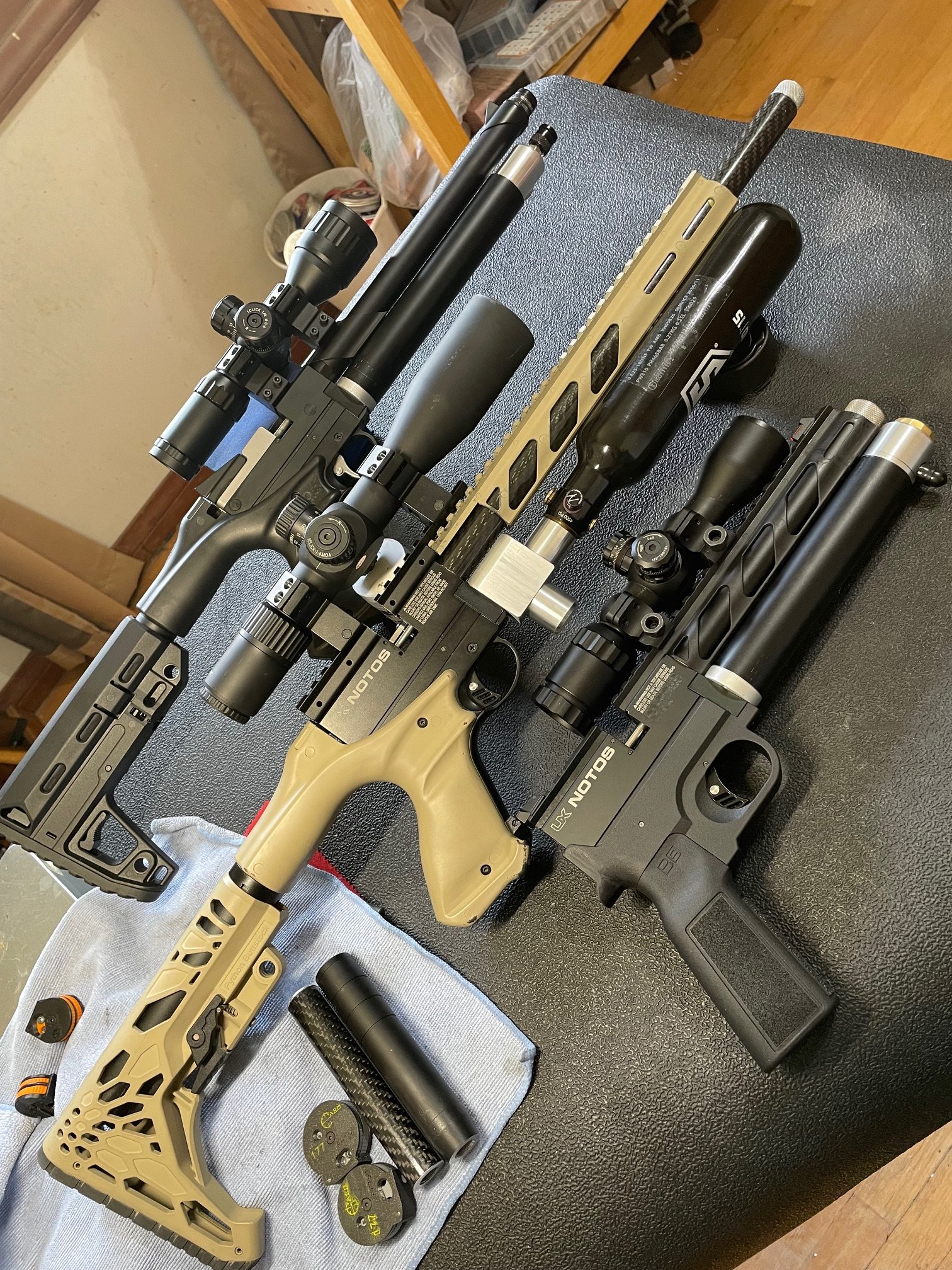

I'm trying to turn my Notos into a low power lizard killer. I cut two sections of the HS off and turned the reg down to about 1000 psi. Its still early in this process. I will see how it groups tonight.
I didn't have it set up the best for chrony, I was just hand holding it in pistol form today. Just some fast and quick to see approximately where I am. I am going to bump up the reg a little. I'd like to be at 10 FPE.

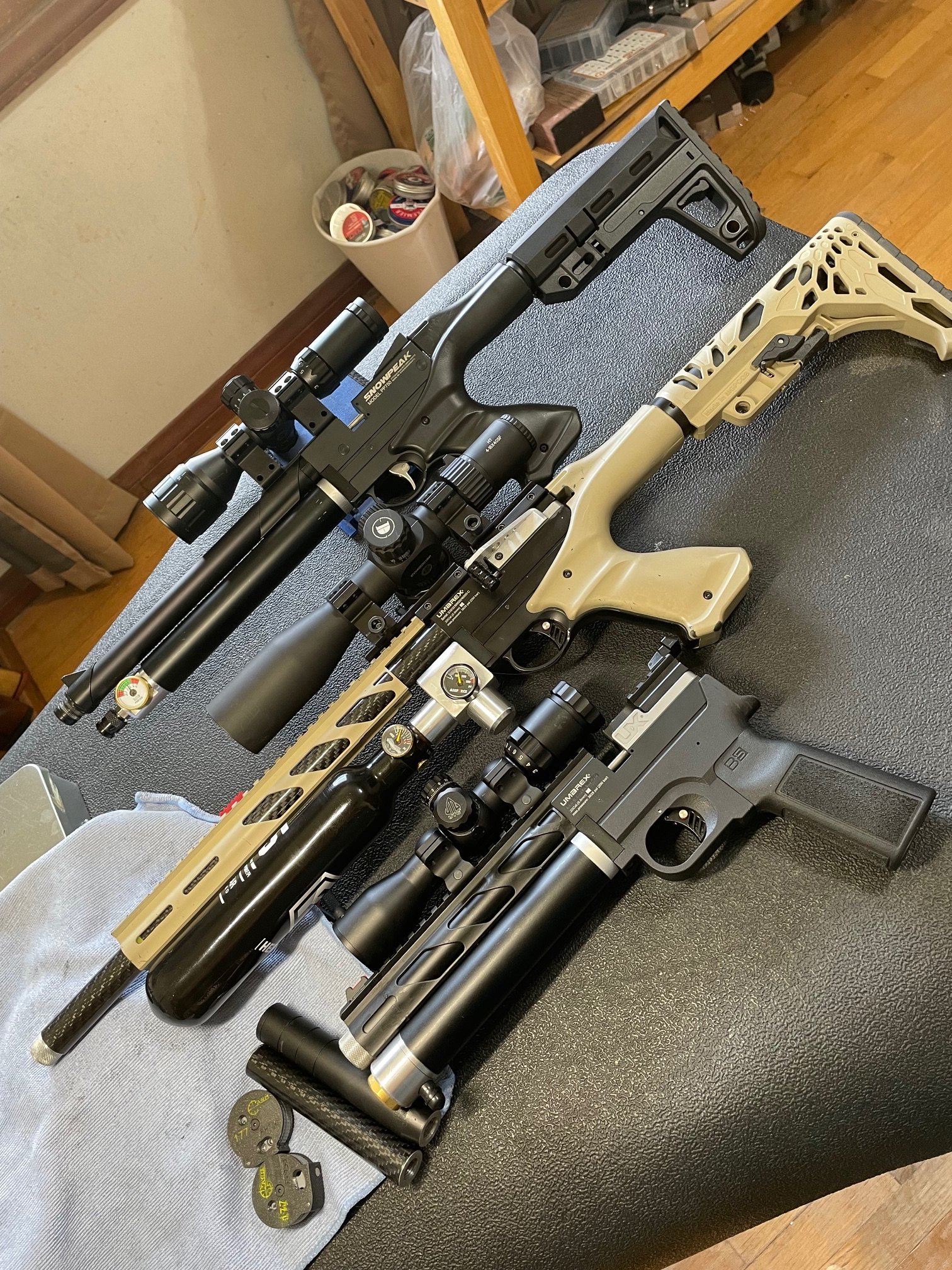

I put a scope (UTG 3-12x) on my Notos pistol to get better grouping. This is set to 13 fpe currently, can go to 16's but losses shot count. Will get it zeroed this morning.
The buttstock is from Wess @ Airgun Archery Fun. I bought some FDE paint from Amazon and the barrel (.177 cal) is a take from my Kral puncher. I had to lengthen the 12 mm step to 40 mm long on my lathe.
That' wicked! Did you use the lathe to also make a probe or did you just take material off the factory one as well? I have a 1:14.6" .177 barrel I would not mind putting on my Notos 😅
I forgot to say, also from Wess it's same as the pp750 .177 probe. I did make one for my 25 cal and also the experimental 30 cal.
