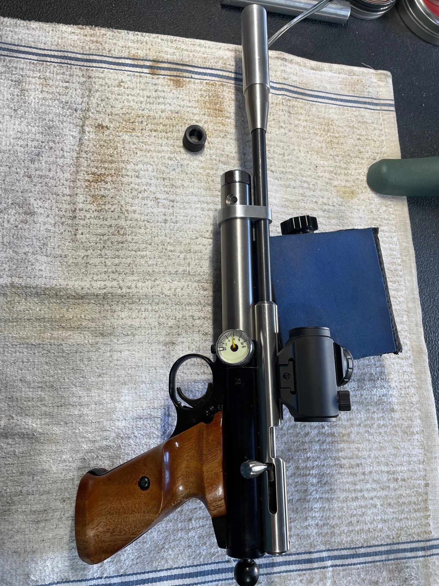

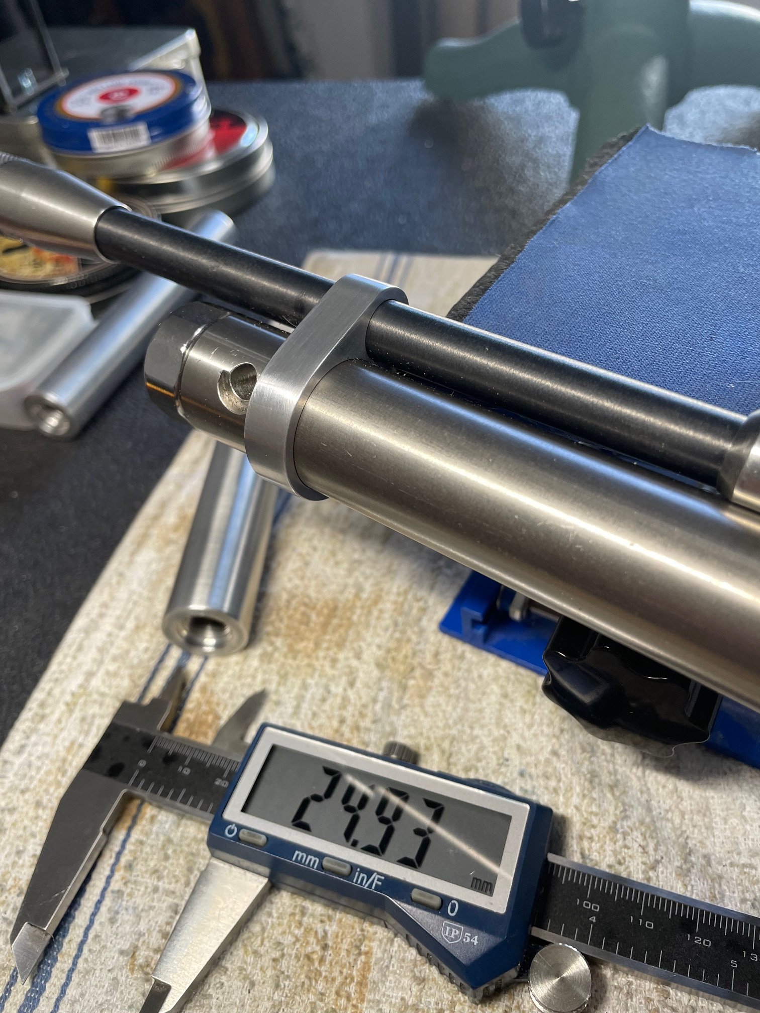

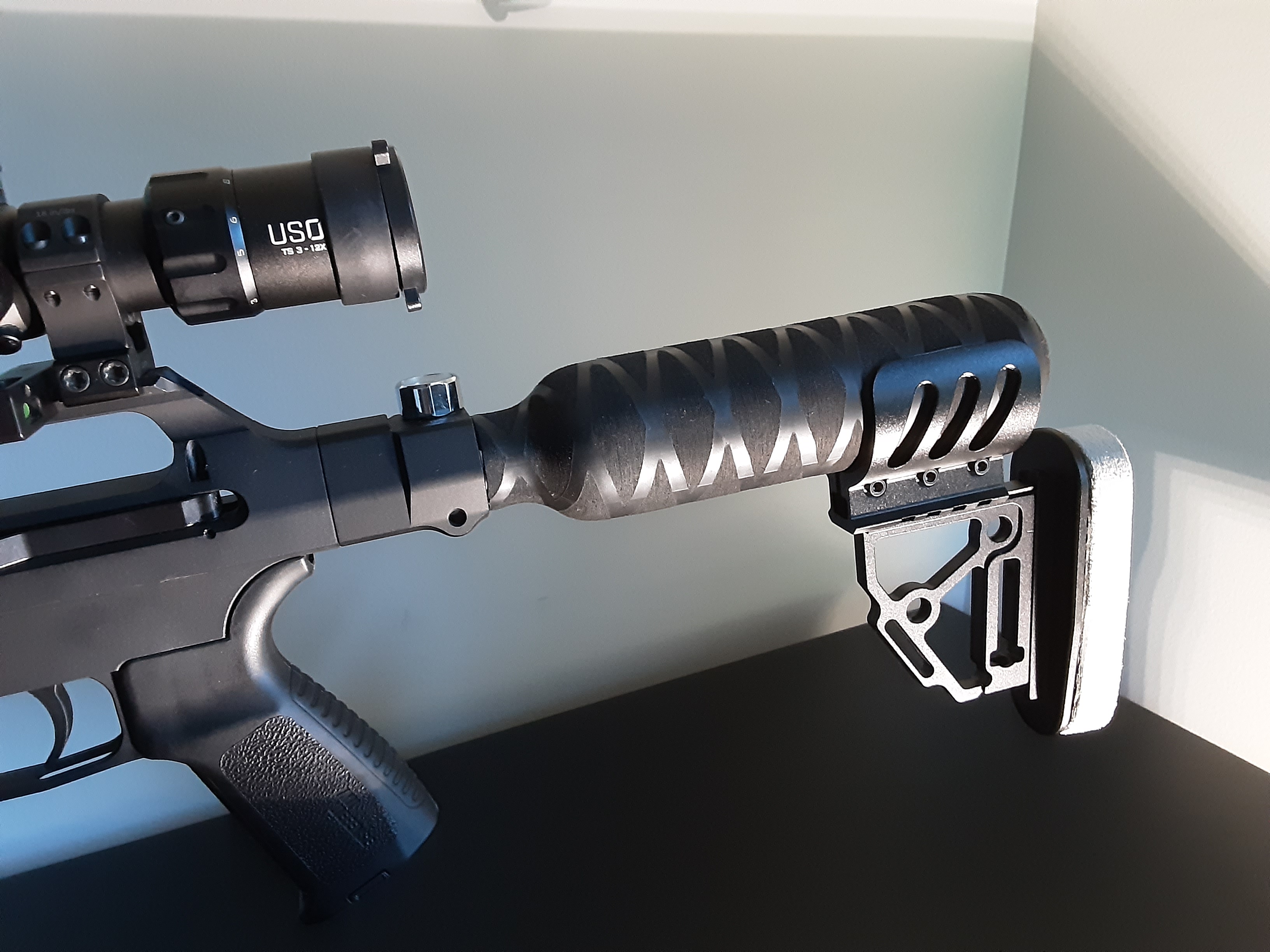

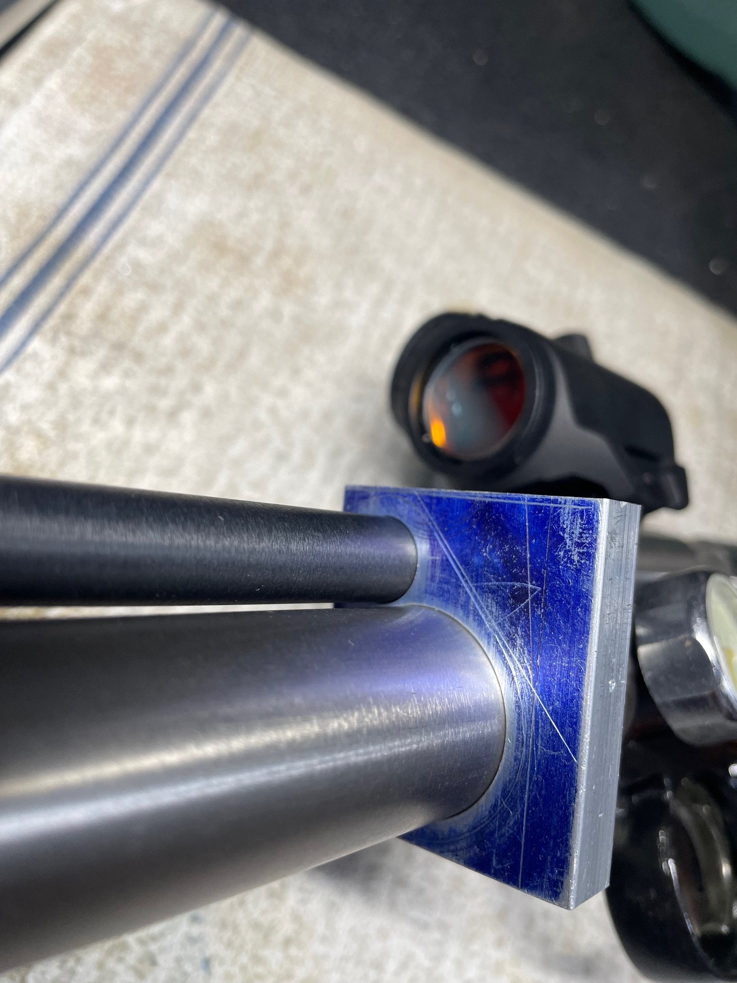

Shot the HW44 for earlier, then put another coat of true oil on the pcp pistol build. Then begun making the barrel band for it. Test fit it, will mill the profile later.
This project is 98% done, just need a week for the true oil to fully dry and buff it. I made the large bore a little too tight, so I'll leave on the end. Don't want to damage the finish.

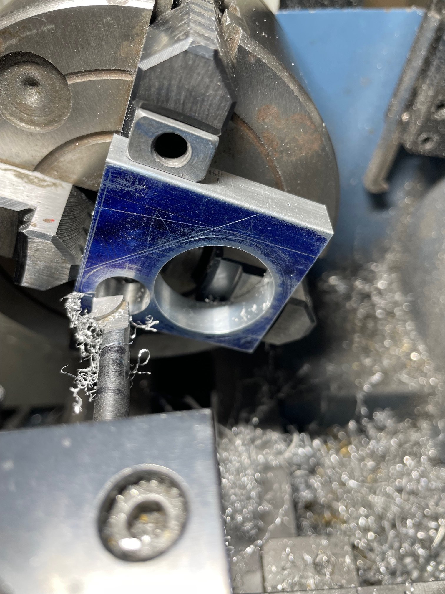

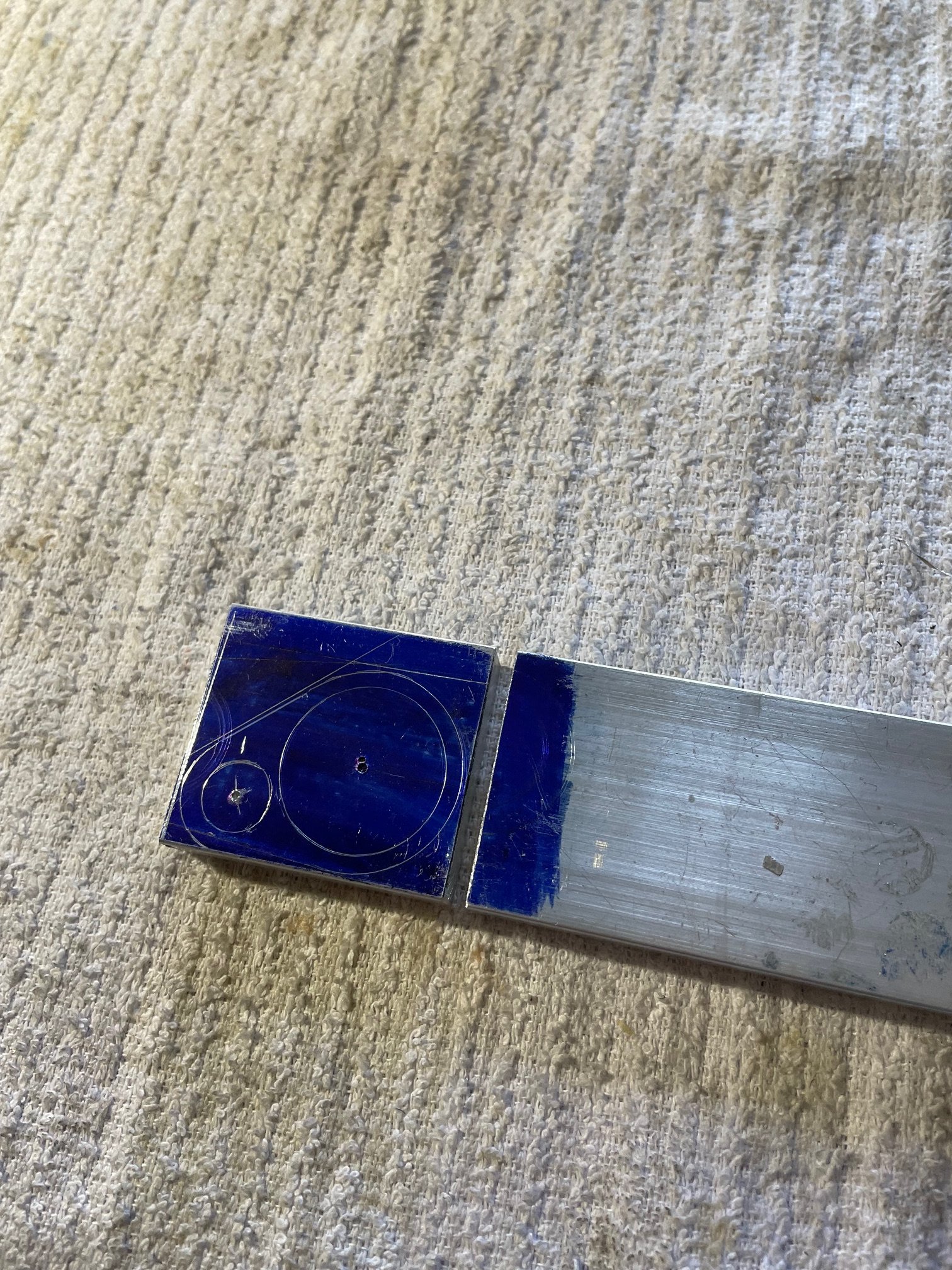

Beautiful barrel band. How did you finish the barrel band? Saw the picture of the boring on the lathe. And the scribe marks. How did you finish it up? CNC? Manual? If manual, how did you do it?
It's all manual machine, I use rotary table on the Bridgeporth. After this, I buff with rouge wheel.

Beautiful work. (y) Have a smaller mill, and RT, thinking about doing this kind of stuff. Do you install the work piece on sacrificial material on the rotary table? Or a spacer?
I have a set of imperial expanding collets, I use 31/32" for this on the big end. Yes you can machine something soft and split it after tapping the center to expand it or McMaster sell emergency collets you can turn to the diameter needed. Gets pricy after a while.

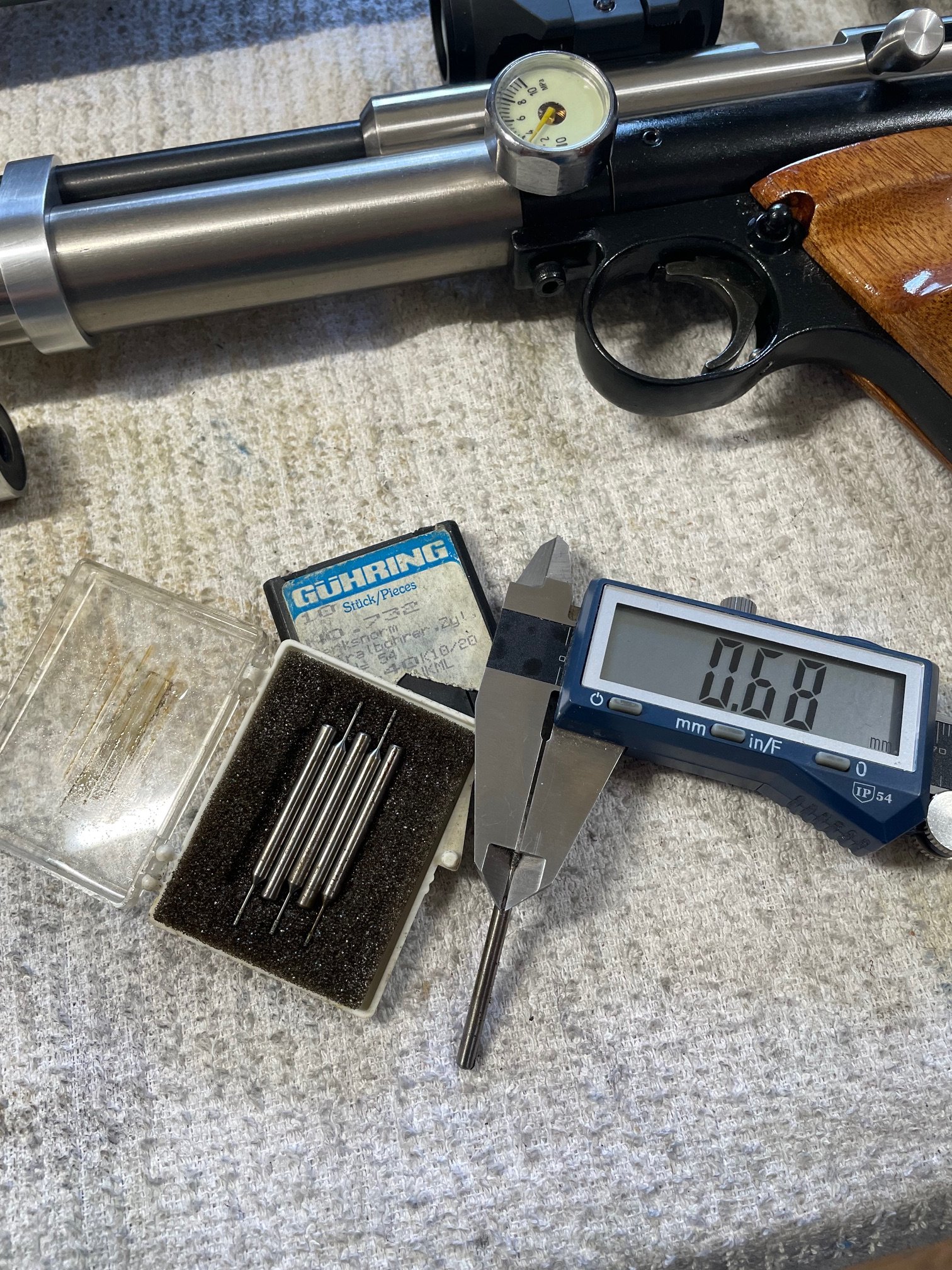

Quite familiar with the pricey nature of machining and tooling! Made a sensitive drill recently, because I was too cheap to buy one. Even so, it cost me about $100, a good micro-chuck (Albrecht 0-3mm) and (Jacobs JT0-1/2" shank) arbor were $95, and maybe $5 of stock. Fact is, sometimes it's way cheaper to buy than make. But sometimes they simply don't make what you need, (or want) at the price point you desire, so you make it.
Getting back to my question, you use the expanding collet on the rotary table? Do you have a picture of that? Guess I'm interested in how you center the part on the RT, with the sacrificial spacer, so it can all be clamped down. Somehow having trouble visualizing it.
Yah, 30+ years in micro machining. Now retired, used to dress this micro grain carbide drills on Ewag WS11. Now I use this to make regulator orifice. Smallest I use is 0.40 mm.
It's similar to this, you clamp the shank on RT. The tolerance might stack up and give higher T.I.R. but it's okay for this type of work.

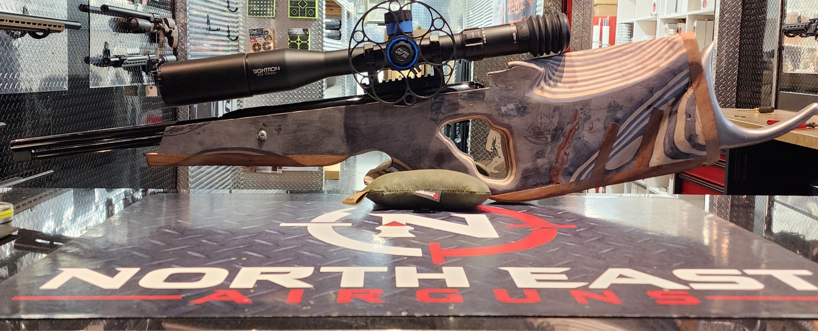

Spent the whole morning practicing HFT and working out the details of my new Sightron S6 SSED 10-60x56 MF-FT scope
