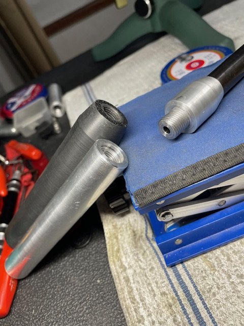

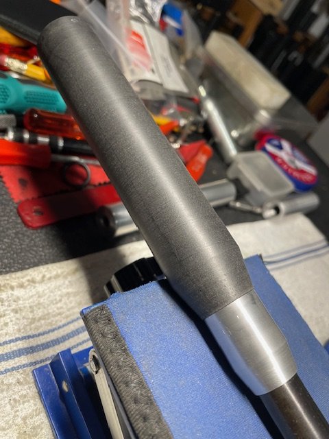

Took my tech force 79 apart again to modify valve housing. Drilled 2 holes 1.5mm dia. to increase supply to the exhaust valve, this brought up the speed to 677 fps, up from 523 fps. Then made a aluminum over sleeve for better moderator alignment. Also the report more than doubled, so I turned down one Notos moderator after taping it 1/2x20. Next up will be a pin type pellet pusher to increase flow from the transfer port.

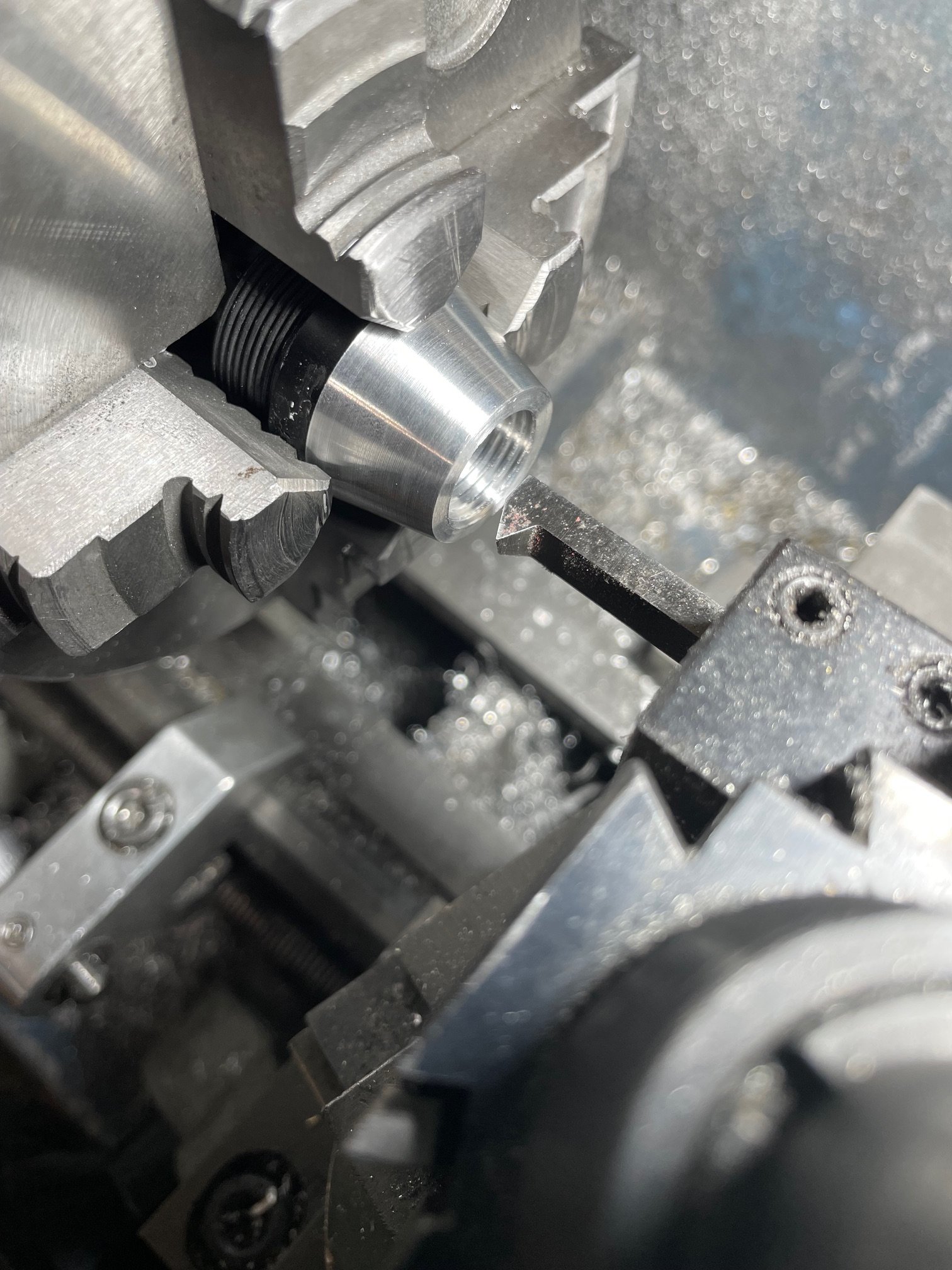

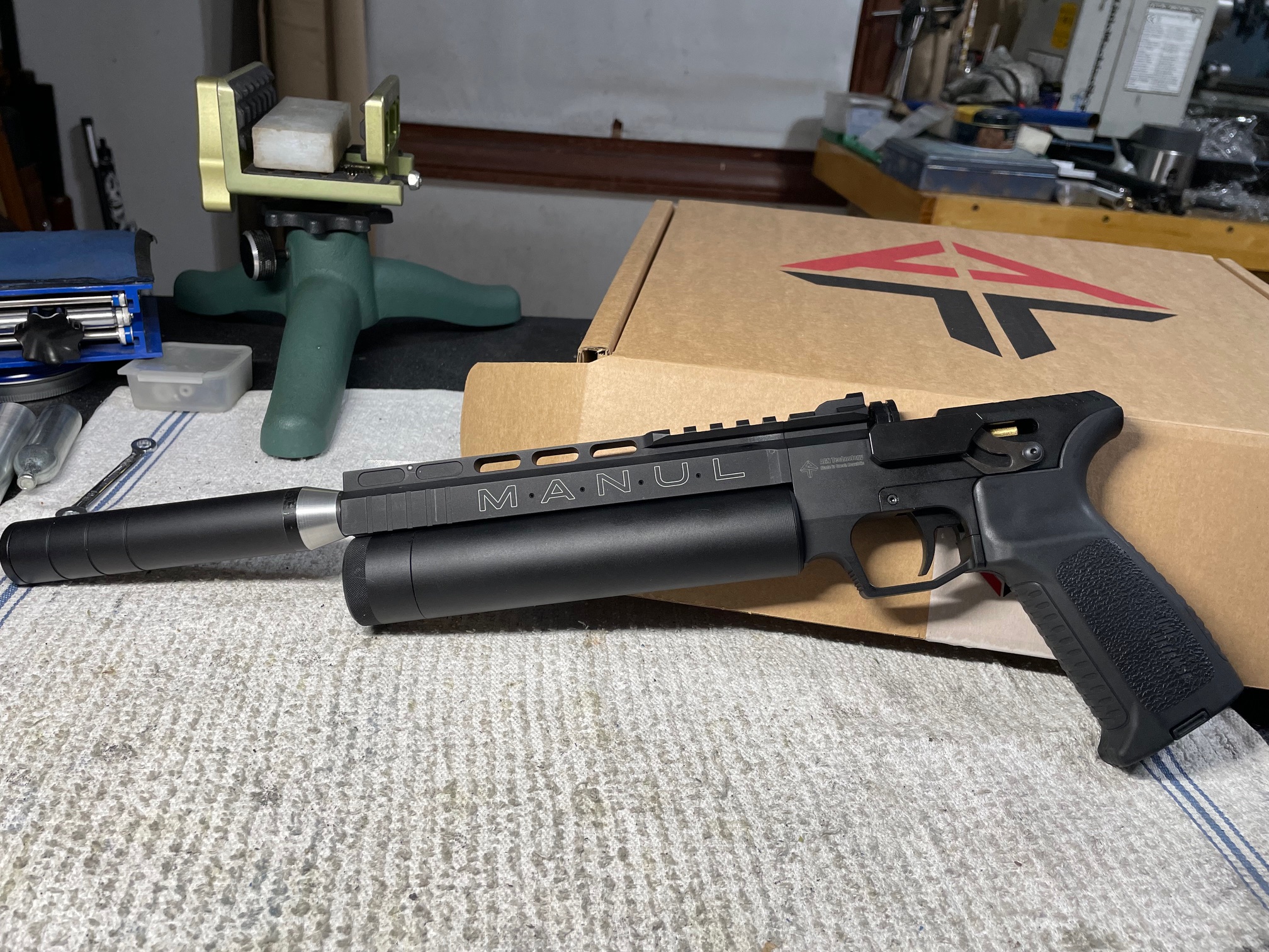

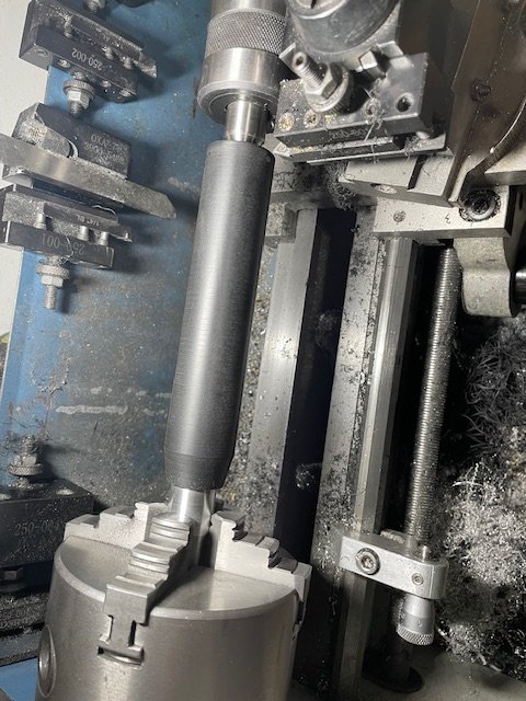

After a very agonizing 3 weeks wait, finally got my Manul pistol in .22 cal. The report is too much, so I modified an Stormrider moderator for it (M14x1.25) on the lathe as I don't have this tap. Very effective at moderating this pistol, now I will have to order more spare for future projects, lol.

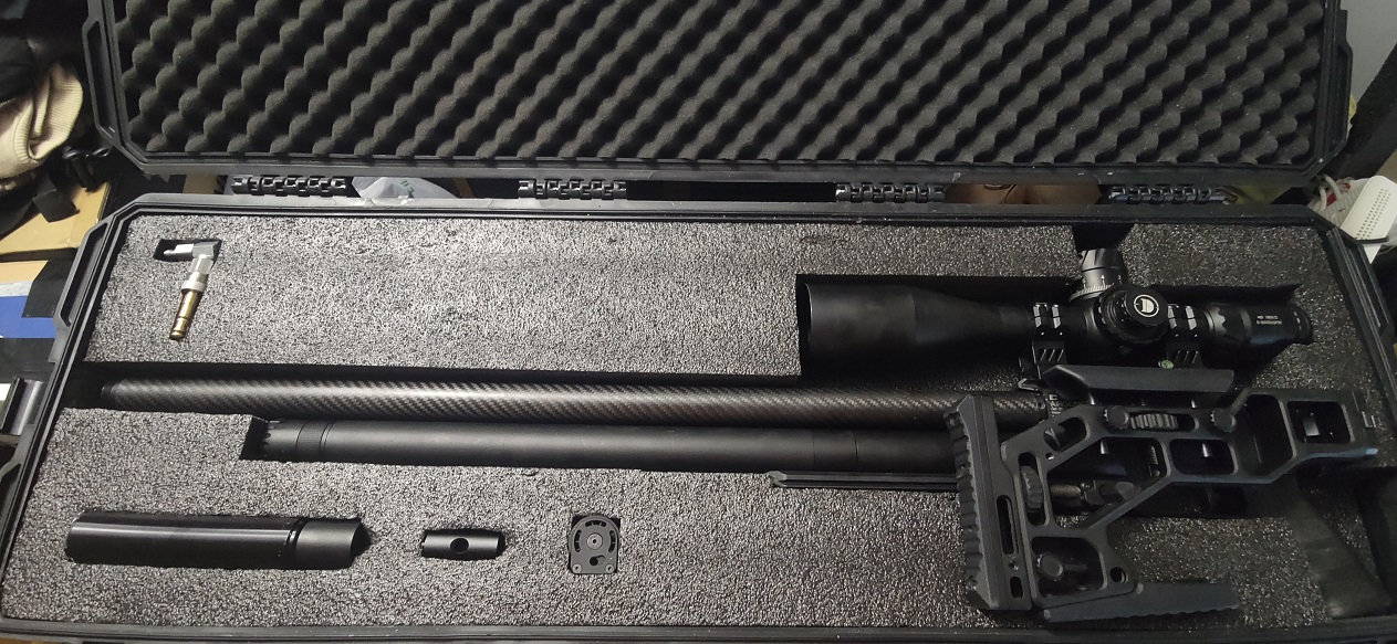

Not really today, but more like a few days ago.
But have installed new foam in case for Epic Two
Still need to make a cutout but need a new case to put in that cutout to hold various must have Two things, not least spares
This case, at least with a 30 mm bottom foam, borderline thick enough to house a folding stock rifle.
Also had to cut a little into bottom foam to be able to rest rifle flat due to scope turret and cocking lever.
The cutout top foam is 50 mm thick.
I do have to push down a little on the case lid to close it, so i will call this a " light press " fit
