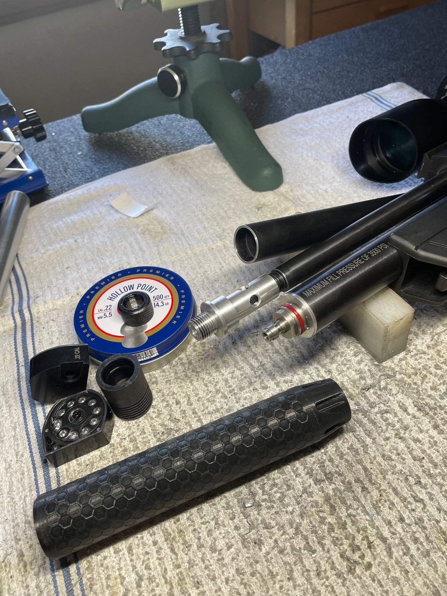

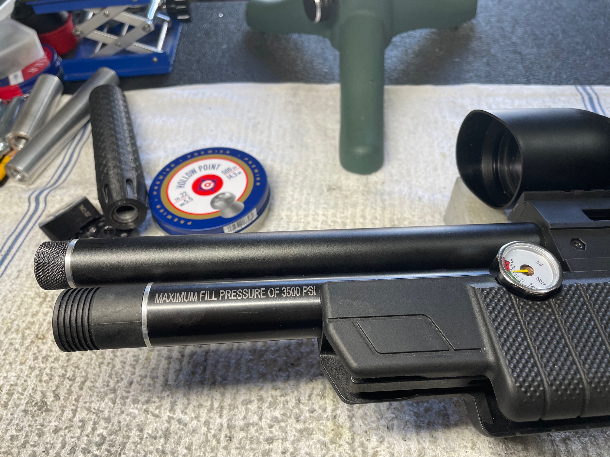

Started to work on my nephews Beeman 1362, this is his 1st pcp airgun he bought with his money. It's very loud for backyard use. So I'm trying to quite it down and also shorten the LOP for him. Discarded the plastic and moderator, made an air striper tensioner in place so he can use any moderator he wants. Making a new rubber butt pad to reduce LOP 1/2 inch, also shortened the trigger link rod 3/16" to shorten free travel. Adjusted the sear to 0.030" as it had too much creep. Well, it went from a lousy trigger to an acceptable one ( 5.5 lbs. to just over 2 lbs.) OAL is now 28" without moderator.

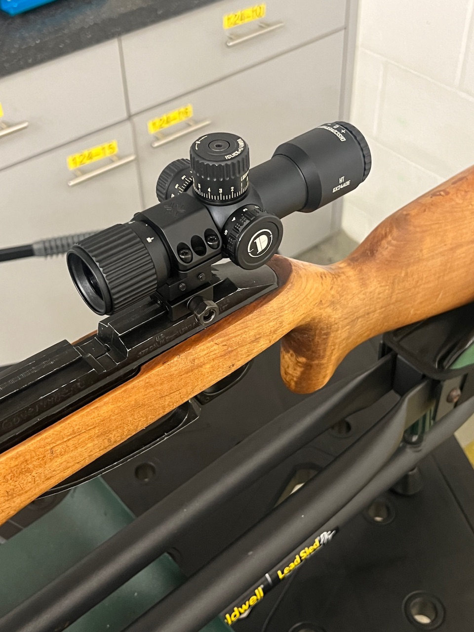

Today i i confirmed one of my scopes went nuts ! three times i reset to optical zero and three times i ended up with no bottom and no right adjustment but crosshairs right on target BULLSEYE ! this was on two different guns , the scope is only a UGT bug buster so not much loss and i sent in a request for a repair . then i shot my little Diana 23 , very hard to cock this springer , had to use both my third and little fingers to get the job done .
