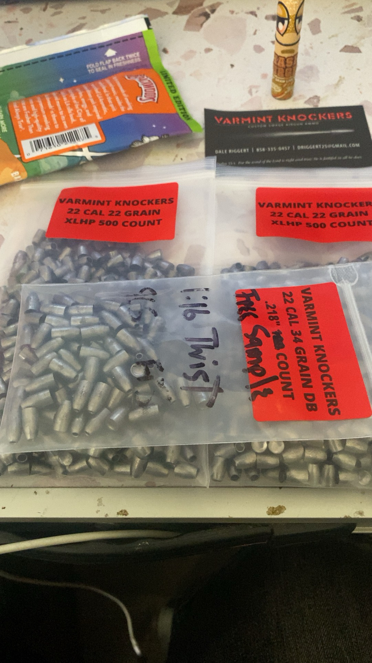

Received my slug shipment .22 22g XLHP from Dale today. Looking forward to trying these out. He also threw in some .22 34g samples to try as well.
Seems like a good place to shop , and being as you can't do a return I think yeah whatever you buy there must have to work otherwise it would ruin their name. I once bought a refurb from Pyramid , and it was such a nice straight shooter , but it was my first regulated rifle , and the the regulator was not working. The reg screw was broke , so I assume the previous owner tried to adjust it down when it was full of air. I had a feeling it was not a refurb they just sent it out. When I called the Lady there said all the reg screws are broke like that. Anyway they gave me my money back , but I have never even looked at that site again.

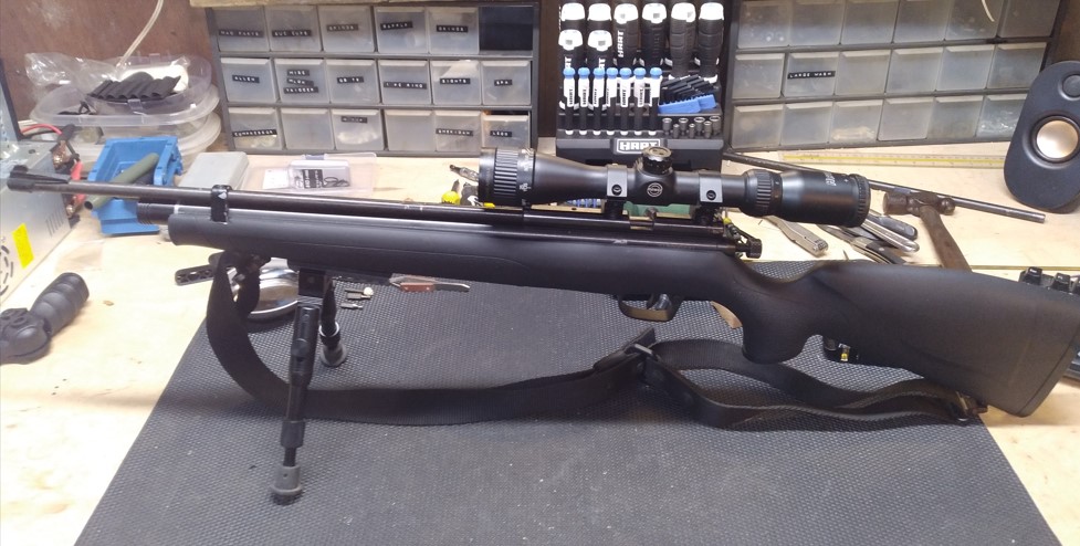

Put my fake "lego" 3622 back together with a new poppet. The guts began as a 2260 tube drilled to pin a Disco valve. I chopped and crowned a 362 barrel and modified a Maximus stock to make the overall 36" length of the gun with a pica rail for bipod. I notched the stock for a barrel band. Also used a Disco trigger frame. And a Challenger power adjuster. Topped it with a Hawke 2-7X32 AO scope and added sling studs.
It's a great lightweight back yard 2k pester/plinker. It's loud and proud.;)

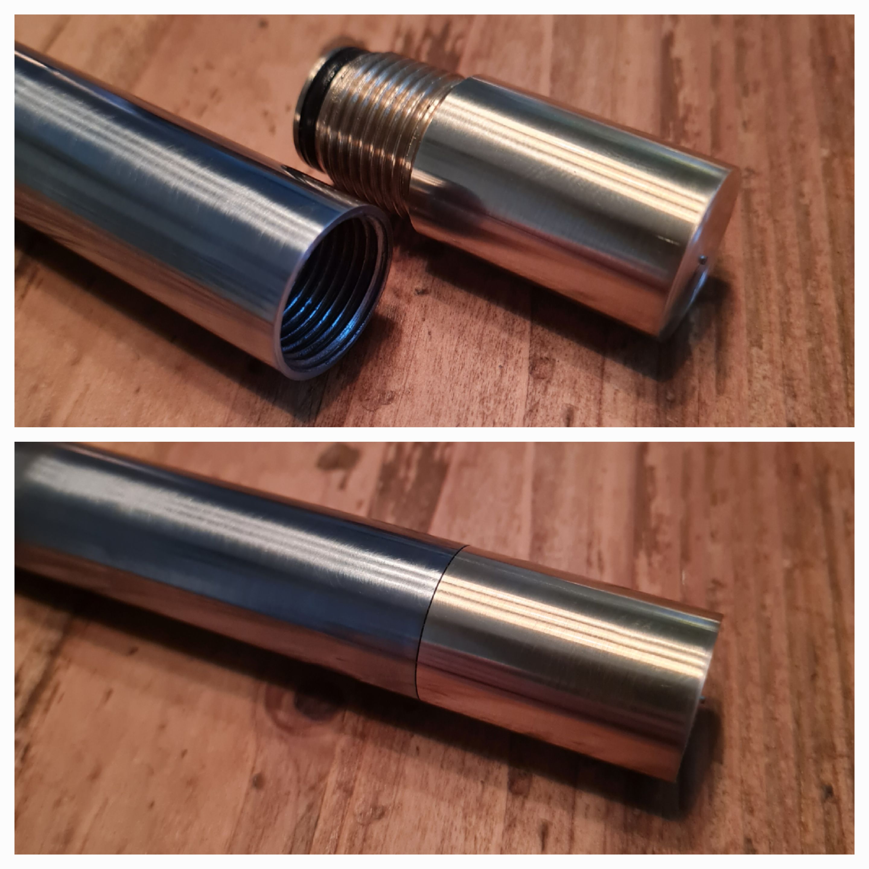

You're a step ahead of me techna! My lathes about 70yrs old and manual feed, so those threads were done (carefully and slowly) with taps and dies. Came out OK though, considering.....
