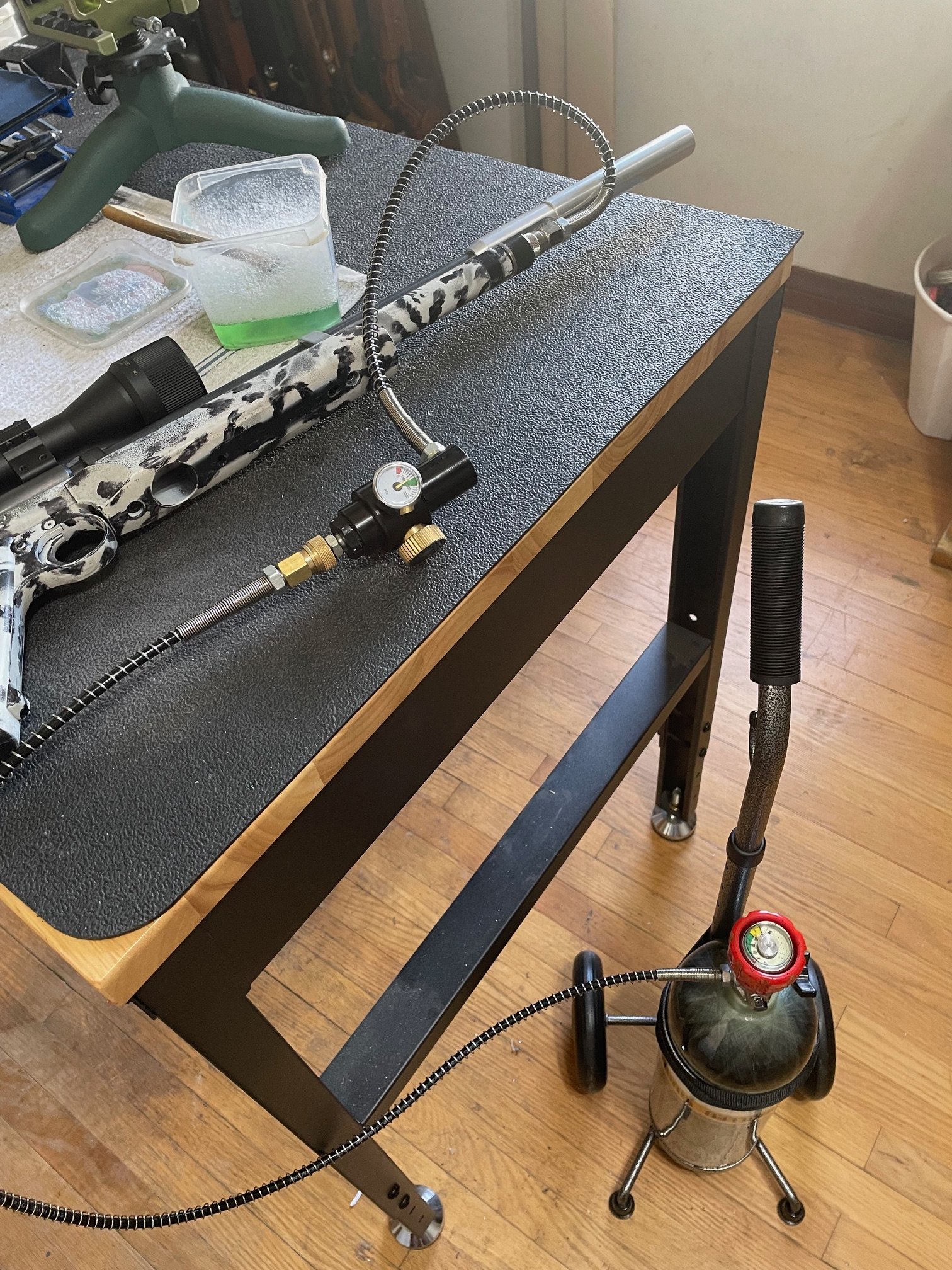

Received the fitting I ordered last night. Re-tap a couple to M10x1.0mm then ass'y. Did leak test, all good, then used my old test mule 2260 crosman for different pressure setting. This gun works best at 1450 psi.

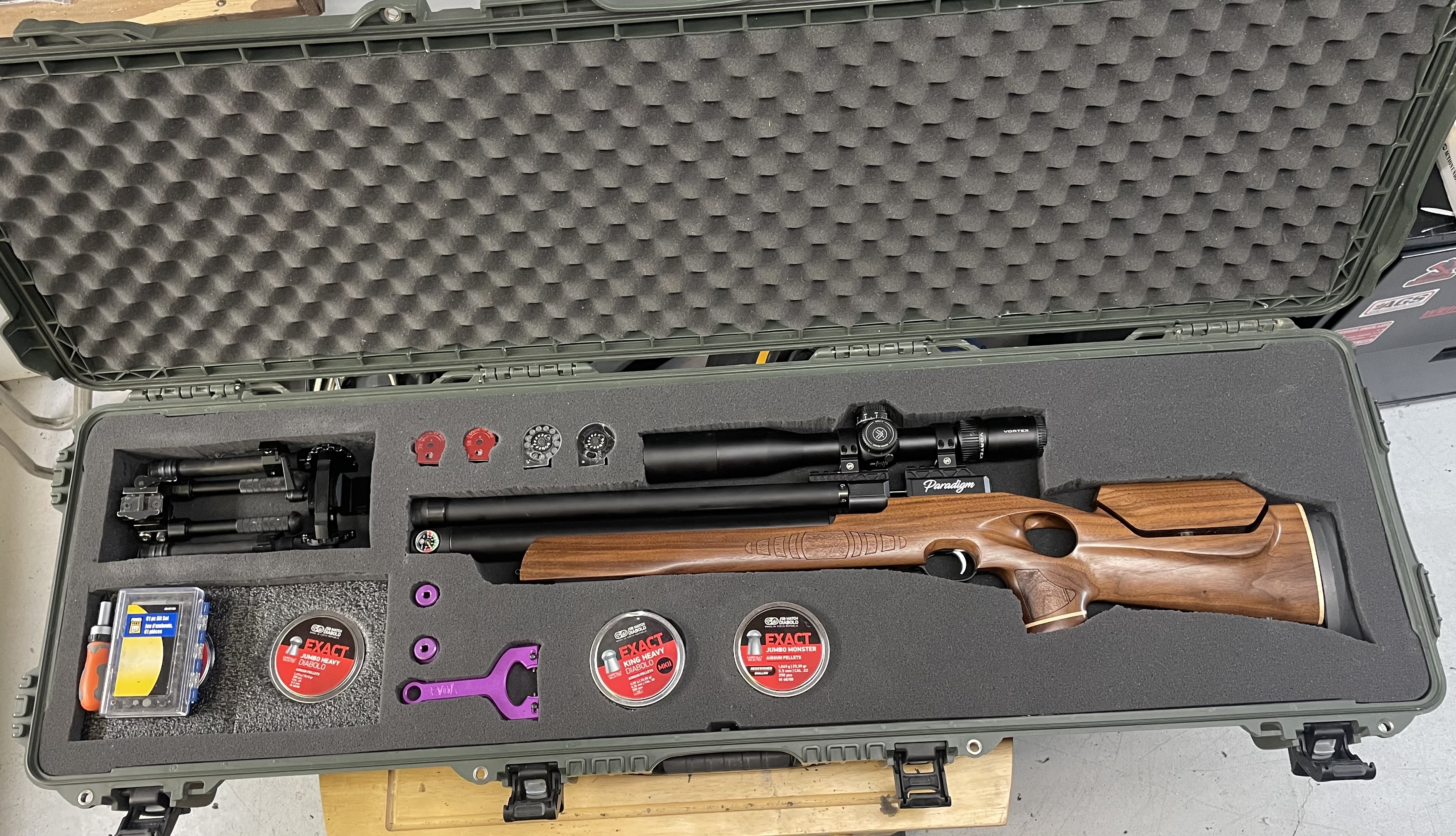

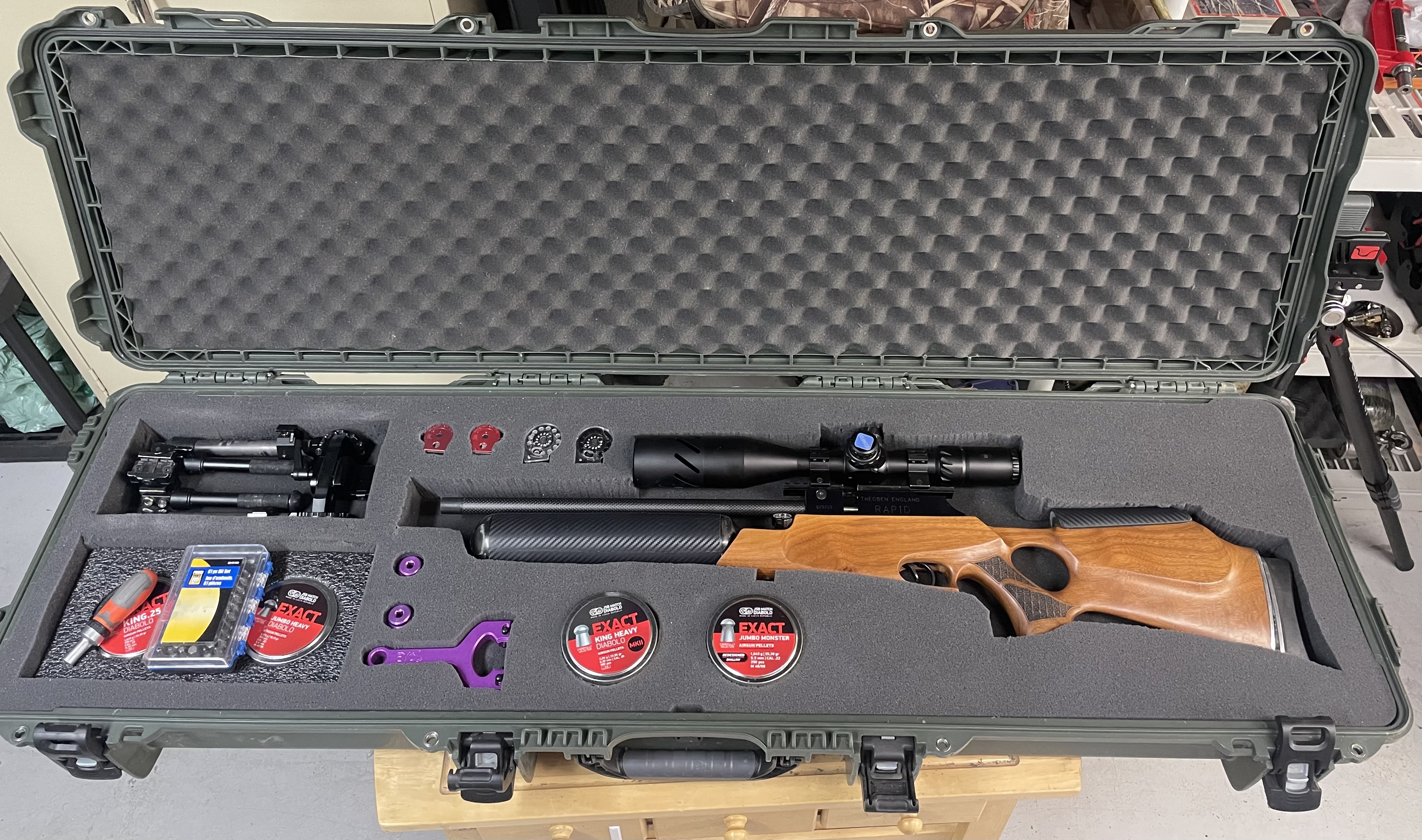

Finished up the padding in the Nanuk 995 rifle case. Worked out rather well and is multi rifle cut out, this one for the Paradigm and Rapid MK2 . I have a few top foams and can switch rifles , double Hw100 , and a CZ457 PB . The case is heavy empty but has rollers which help.

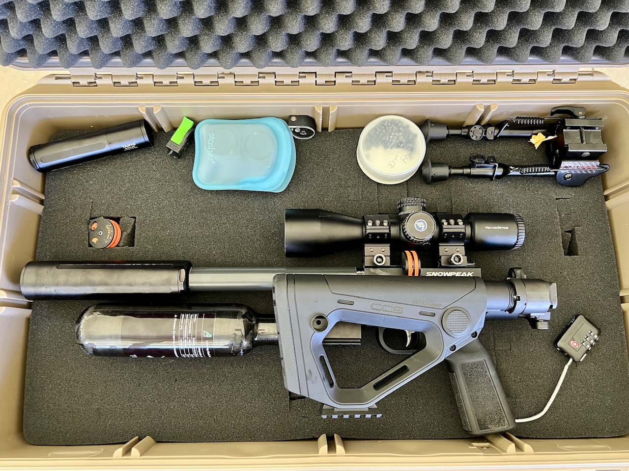

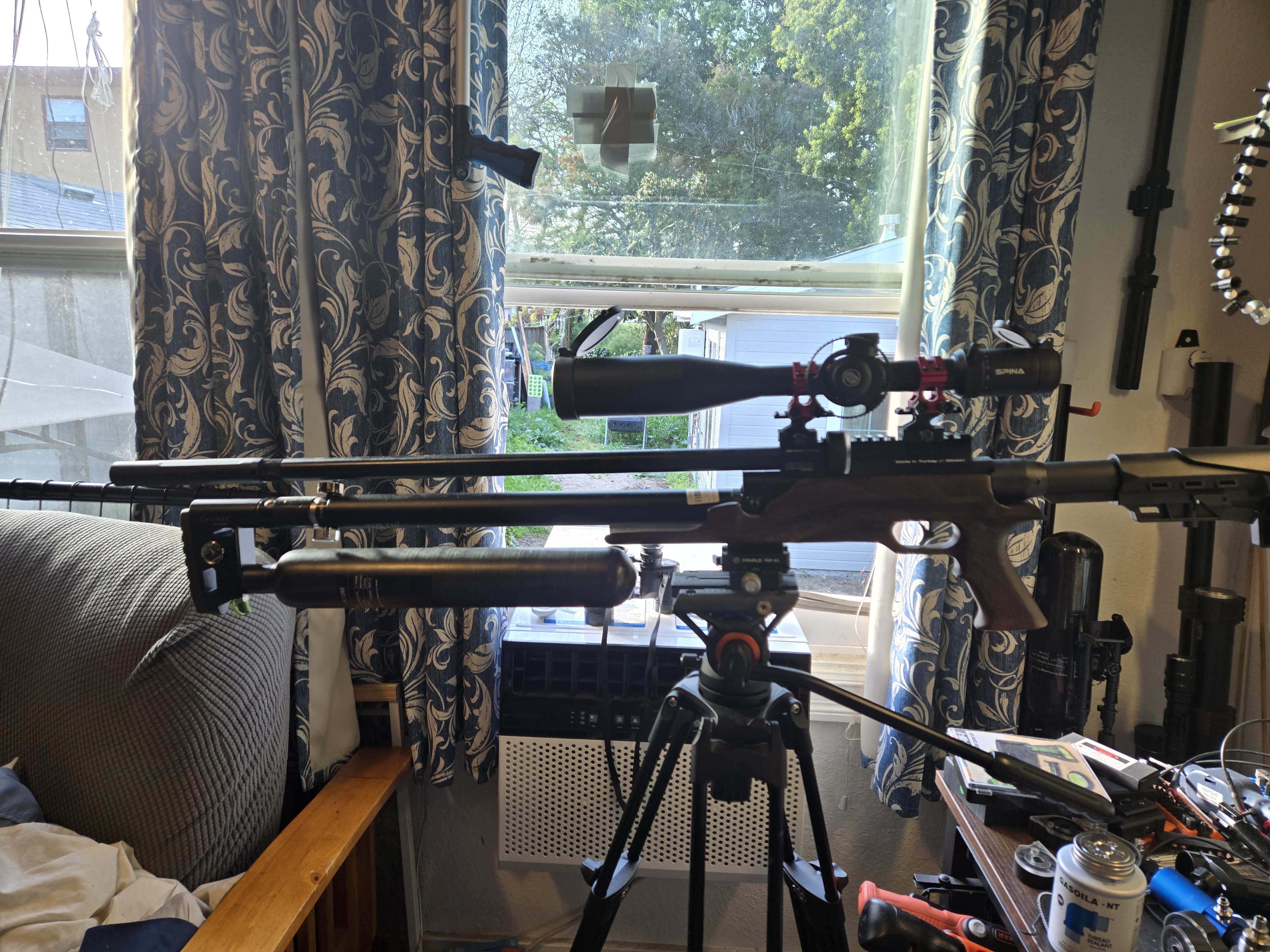

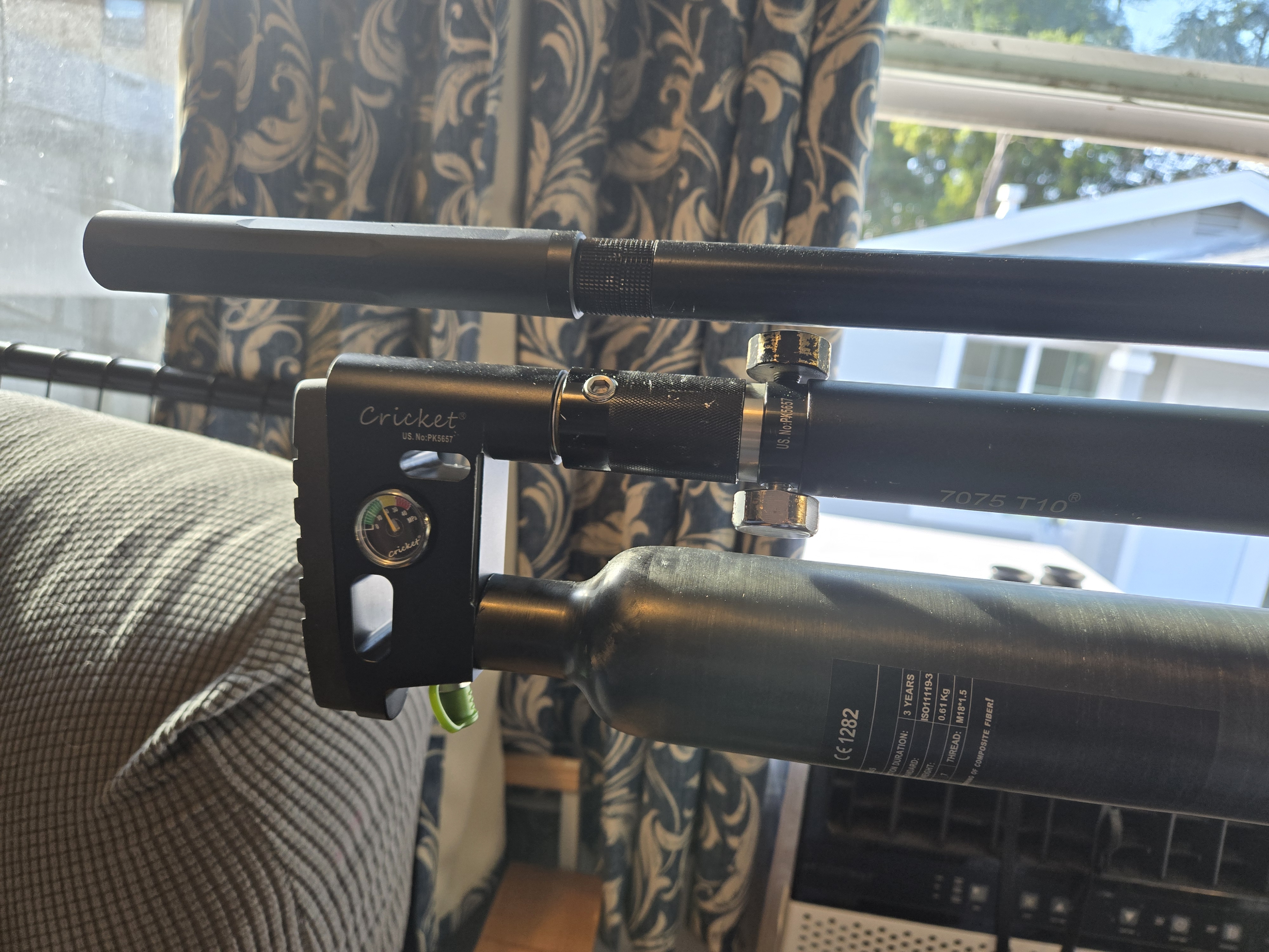

Built up a 150CC+ plenum with a 700CC bottle for a .25 rifle. Getting all the various joins to seal AND clocked required a lot of work. Couple bonded washers, 1 m18 washer and a special 10mm thick adapter from Trajectron. Been holding air for several hours.
Huben Power non regulated U adapter.
Shan Bao 40CM 3000psi aluminum tube. M28x1.0 at one end and m28-m18 adapter on the other.
Regulator 1/2 of Huben Power Cricket. Leaves the M28x1.0 that screws directly in the 40CM tube.
M18x1.5 extension to get the U past the barrel to screw on. Needed the 10mm as the Cricket bottle end is 32mm and the extension internal is 25mm.
Currently set up for 2500psi.
Seems solid, no flex, and the gun is hitting nuts on.
Need to put it on a Chrony and see what the numbers look like.
