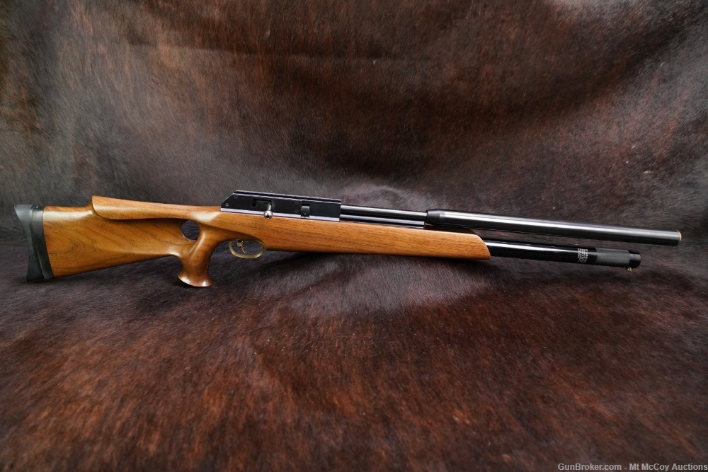

.22 A. H. Hartley Stalker Tiger LE pcp rifle

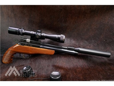

.22 Duk Il Arms AR6 Hunting Master pcp pistol.
All in what looks like immaculate condition. Minor issue with the safety on the pistol. All of them works of art, just gorgeous.

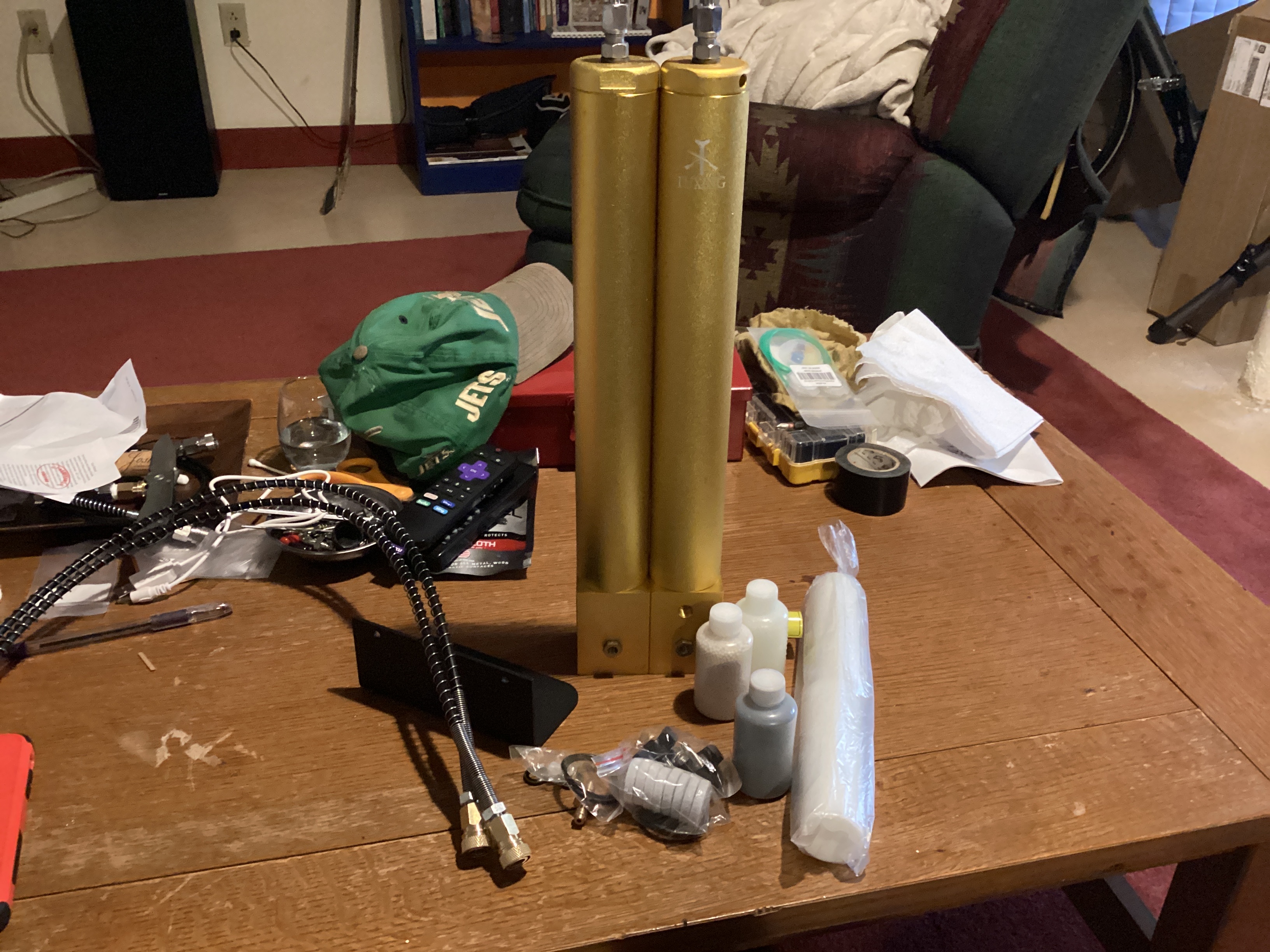

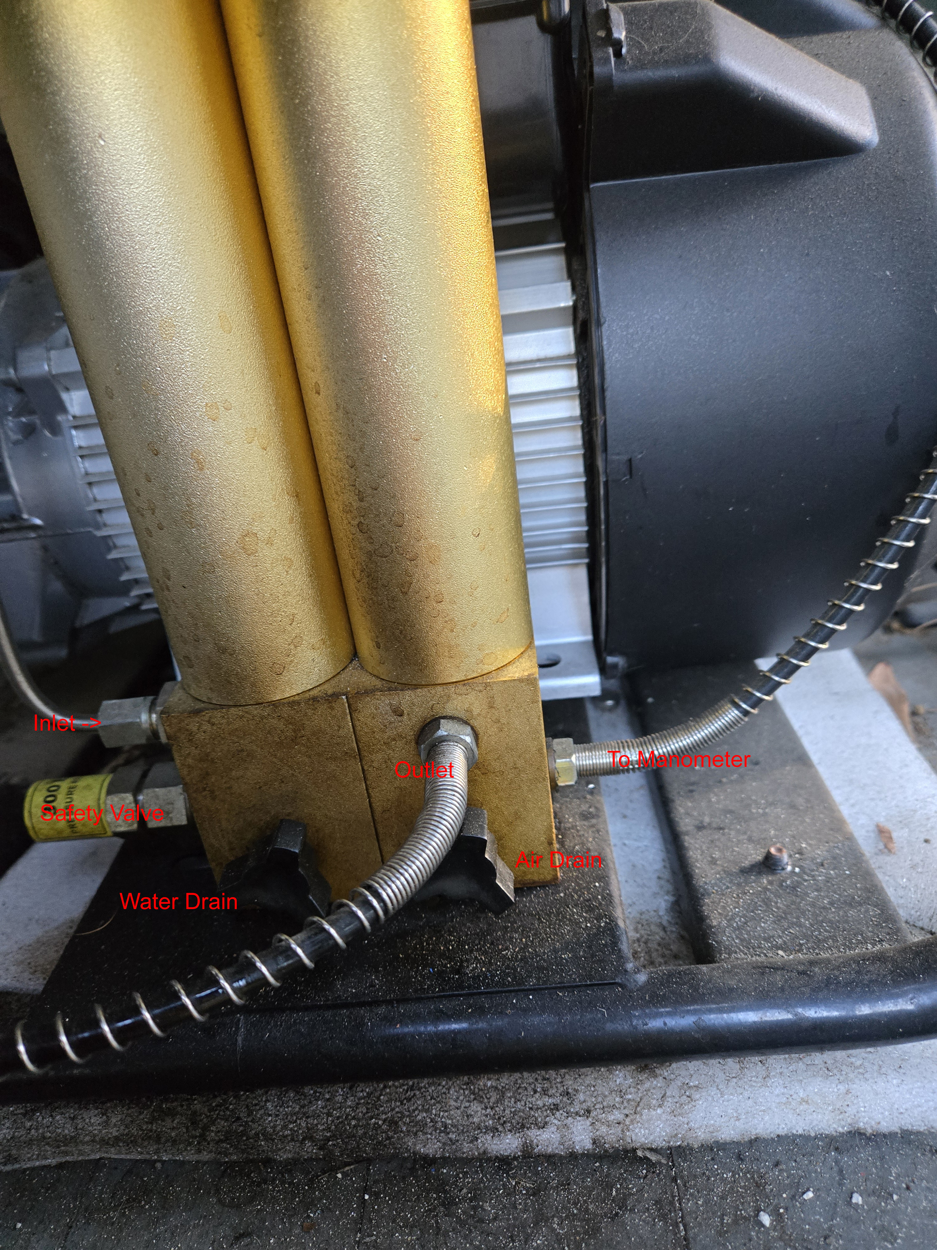

Hi Spindle, the hole on top goes nowhere. Just about a 3/8 untapped ?
Are there filters already inside and others are extra ?
Is the 300 bar pressure release just a safety or an automatic bleed just as my compressor shuts off ?
Seems Tuxing implies it’s a bleed
thanks,
Mike
No clue, my setup was already assembled.
Left side is cotton or some sort of fiber to take out the moisture.
Right side is the air filtration with a couple different materials.
The safety is just that, blow past 300 bar and it bleeds.
The two bottom holes are the manual bleeds.
I bleed the water first and then the air (left then right).
Unless I'm filling a large tank there usually isn't a lot of water.
But I open it and when water stops coming out I open the right side and bleed the rest of the air.
-- Matt
Reactions: Bandito
-- Matt
Thanks Matt,
I guess I’ll take one of the tops off to see if it’s loaded
