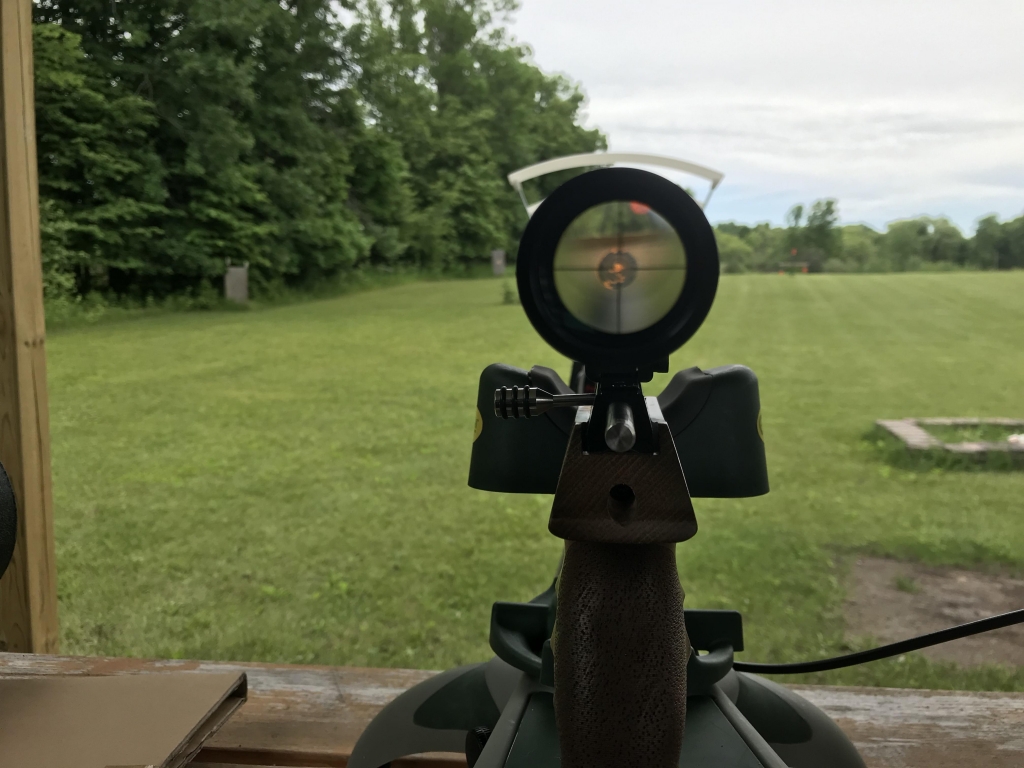

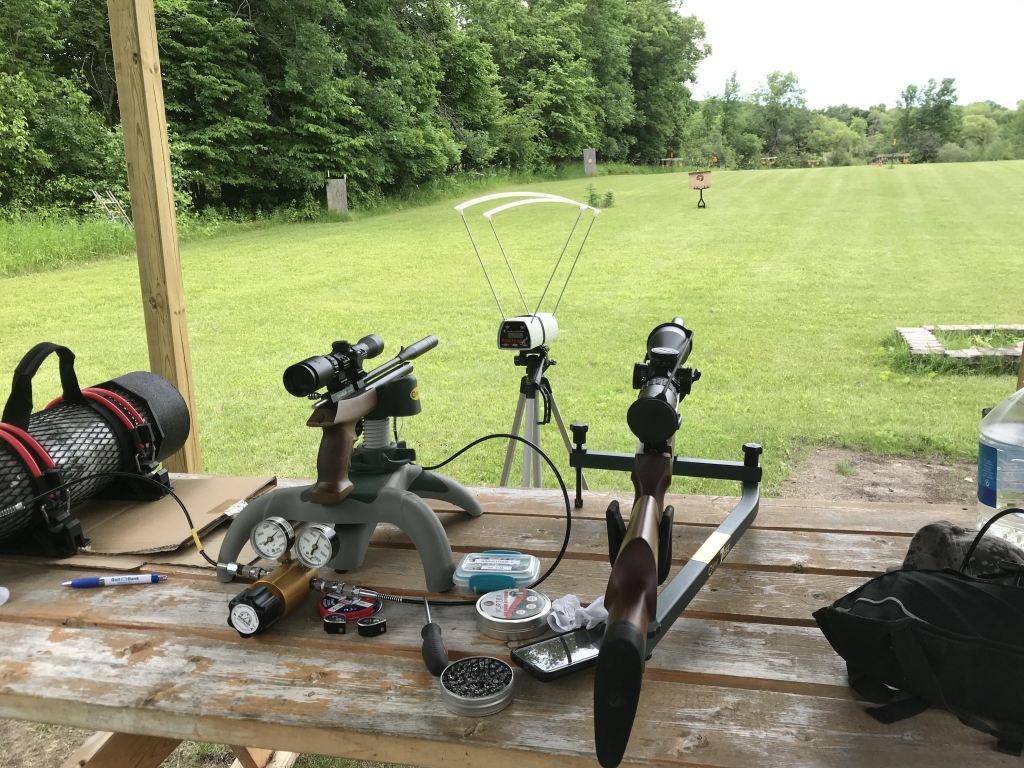

I just bought a Diana Bandit .22 and had it out the other day, I shot it tethered as I do most of my airguns, just be carful when you fill the Bandit with air, it doesn’t take much to hit 200 bar/ 2900 psi I was surprised 😲 but then I tetherd it so I could just keep shooting.

I’ve seen pics of all the back yard ranges from different folks, and I have still yet to find one as perfectly set up as Imolds. And, get this, when that golf course of a range gets, uhh, boring, he can shoot off his deck out to his lake, lol. One of these days I’m gonna pull the “squatters right” card and invite myself over to his pad, lol, and as long as there’s air and pellets, I’m staying!
