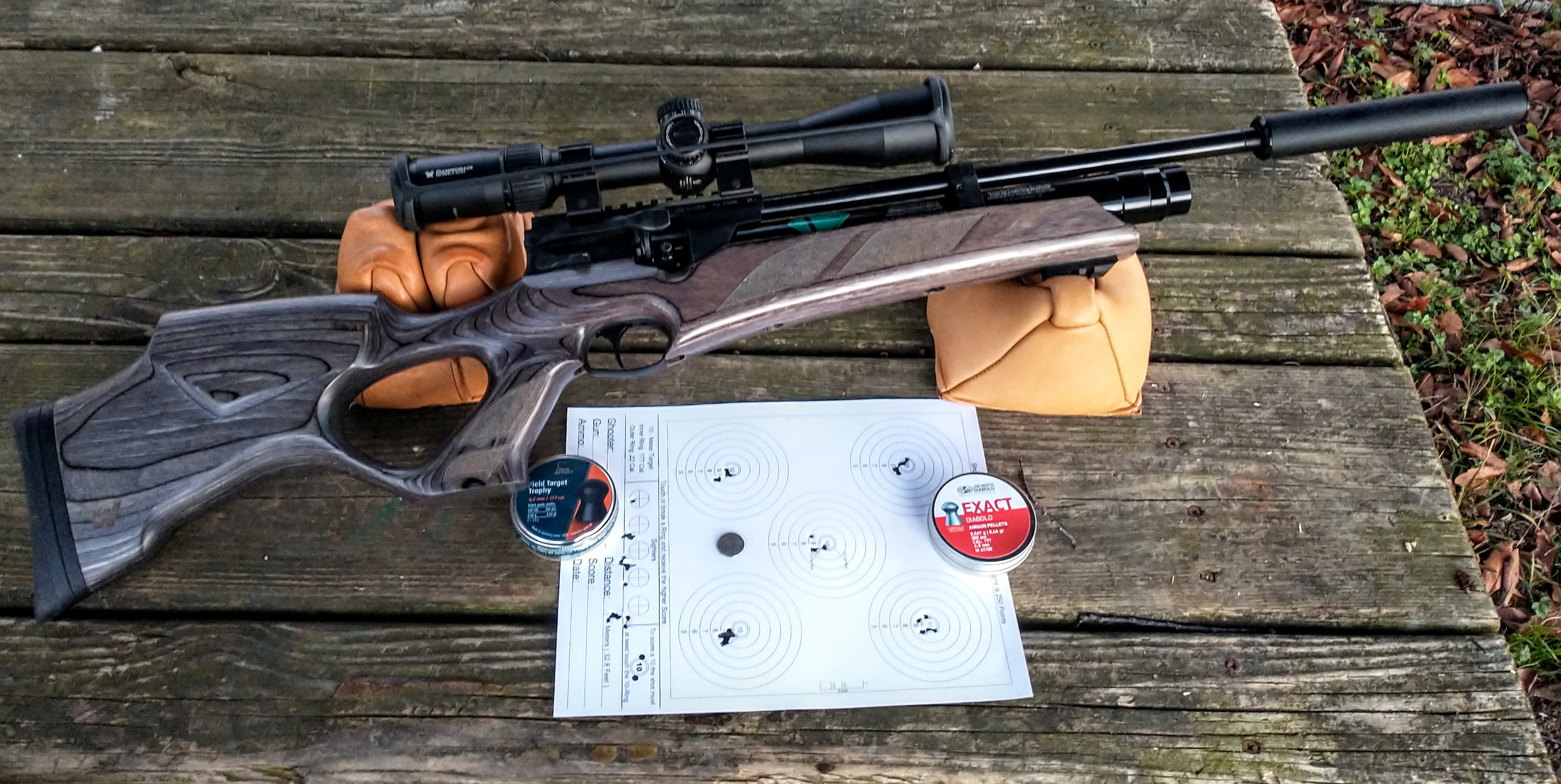

I got this rifle back from air guns of Arizona today. I just picked it up walked out to the bench started shooting jsb 8.44s at 25 yards. The second group from the left on the sighters is five shots. Actually every group is five shots.
I haven't tried to zero the rifle yet I just popped the scope back on it locked it down and started shooting. I think this rifle will probably consistently shoot groups under 9mm at 25 yards outdoors. Probably better than that with sorted pellets.
It is accurate enough for me. But If you took it to a bench rest match and shot that badly people would laugh at you.
Reactions: MRaccurate

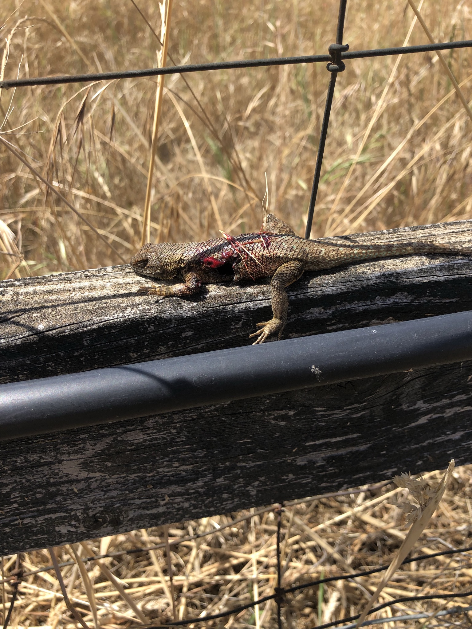

30 cal 44.75 pellet thru a lizards ribs at 100 yards w/o hitting the water line or fence board is an accurate gun.
But- I can’t do that all the time as I’m not a good enough shooter to do so(too out of shape, I breath about as steady and calm as Tommy Boy and John Candy after both racing up a flight of stairs)but I’m confident if I handed my rifle to one of you better shooters, you’d do that feat at least 3/5 times.
