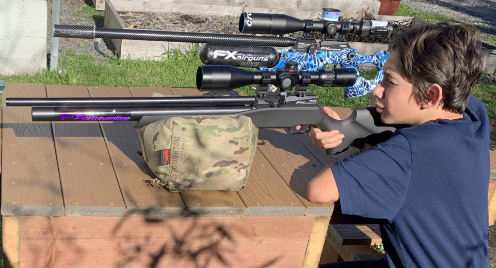

Different fill types for different bags and applications... like others have said buckwheat hulls, Air soft BB’s or rice. I even have a large bag with synthetic pillow stuffing(pic.) it’s perfect for that application. Just don’t let the rice get wet!!!
