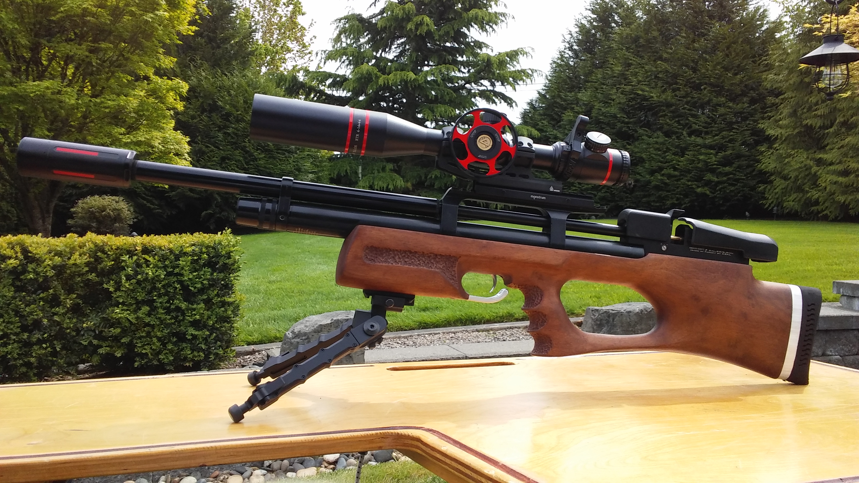

M -TN-Airgunner Nothing wrong with the Puncher Breaker as I have two. They shoot JSB'S 18.3's and crosman 14.3 premeirs domes really good . Seems that the JSB are a little better thou at 3/4 power on the power adjuster wheel. I use the cheaper crosman's pellets most of the time YMMV. They are a little heavy to pack around hunting so you may want to use a single point sling too help out if your a hunter. I have taken quite a few rabbits and squirrels with mine. You also can buy Carm magazines for them which I like better than the stock mags. Have fun and enjoy the sport ! Here is one of mine
