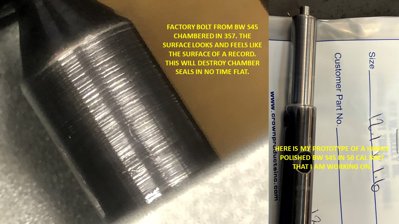

I am mostly doing behind-the-scenes stuff. I have repaired a few customer guns, but I mainly modify current and new releases. The attached picture shows the surface of a factory BW S45 bolt (In their 357 model). My prototype bolt for the BW S45 in 50cal is on the right. The upper portion of the factory bolt has the surface (Ridges) of a vinyl record, mine on the right is highly polished and should tear up a lot fewer seals.

Feels like less lethal stuff. Get an imperfect but decent platform, mod it, and make it right. I've seen this before as well as some work to the trigger and barrel to correct issues. Updates?

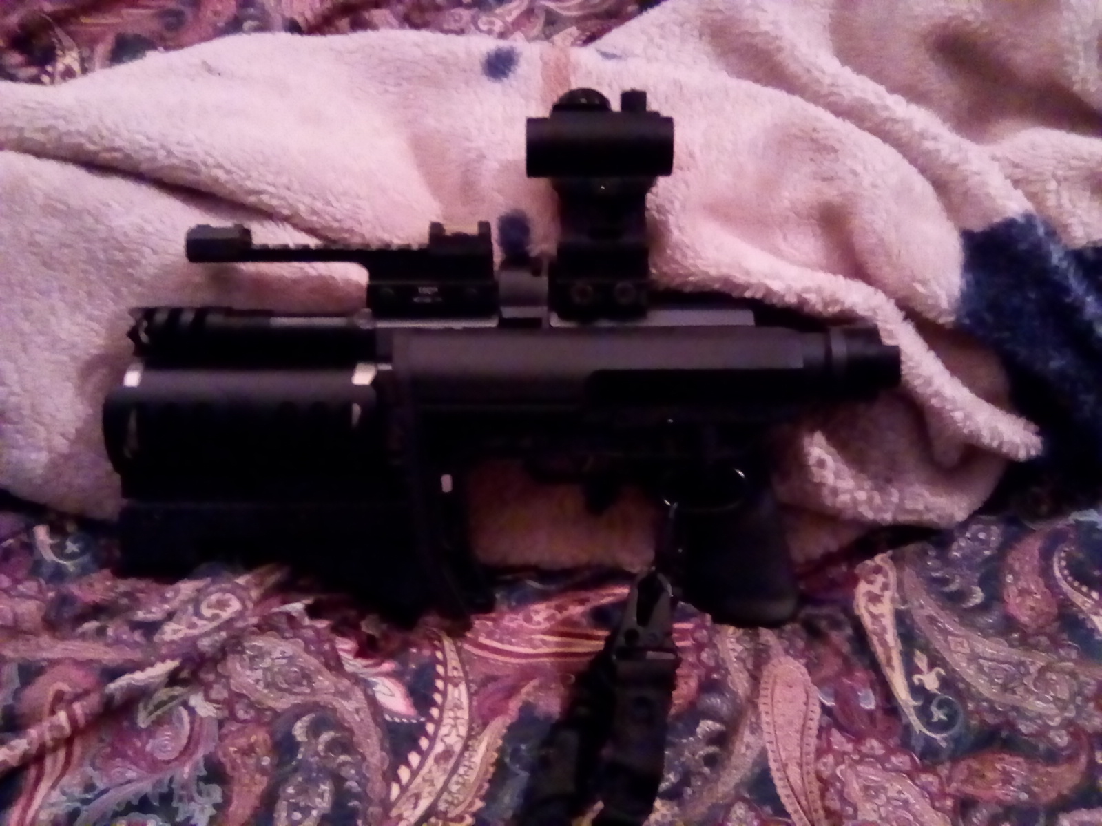

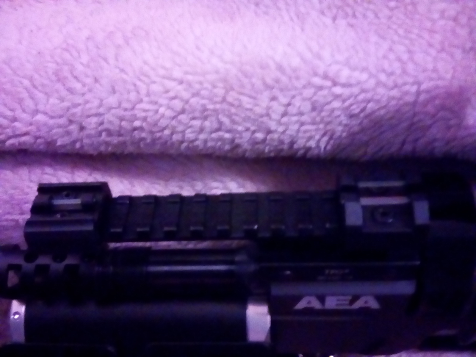

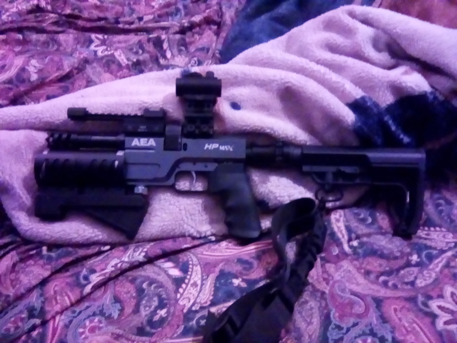

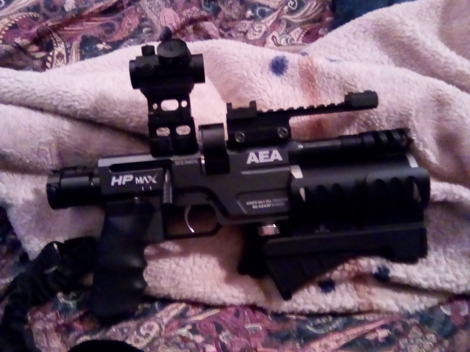

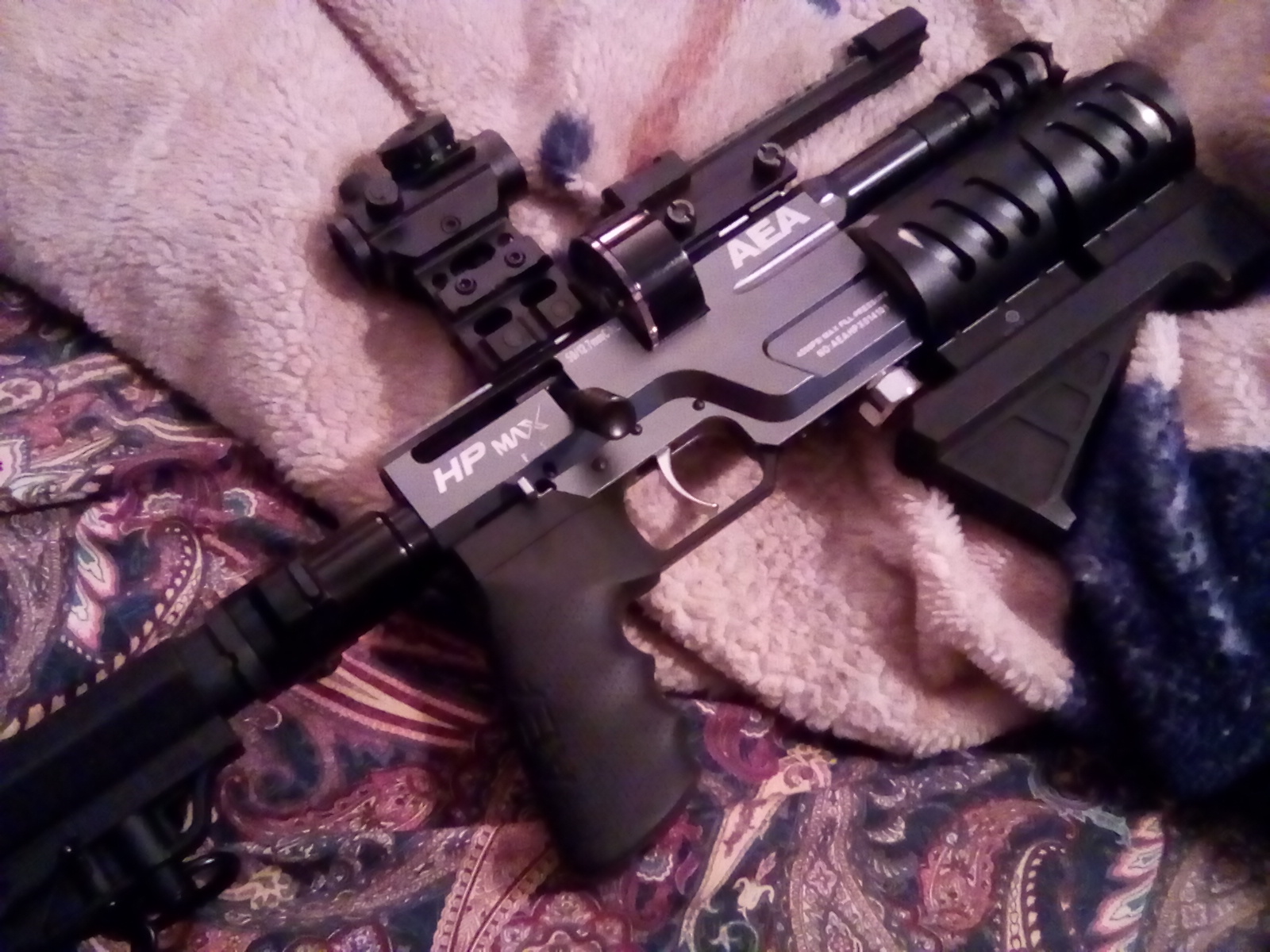

I got my gun this week and put all the add ons yesterday. I also ordered a 10'' barrel as well. So far I have only set it up with the 5" barrel. I got the Texoma fixed stock adapter with the gun so I installed that and a sb tactical folding adapter and minimalist stock. Then I put two of the Bin Tac style pic rail bottle clamps on the tiny bottle and spaced them out to allow a Monstrum tactical fore end grip light to be attached. The top side sports a 1" high offset pic adapter running most of the length of the barrel and a three slot riser on the rear of the breech. I ended going with a cheap Amazon red dot and then I also installed a set of fixed fiber sights that look like they are going to work perfectly with the high riser mount the red dot sports. I have to change the light color from fde to flat black today before I post any pics. I have the same style pic rail for a ten inch barrel set up. But so far I really like the feel of it in extreme SBR form.
