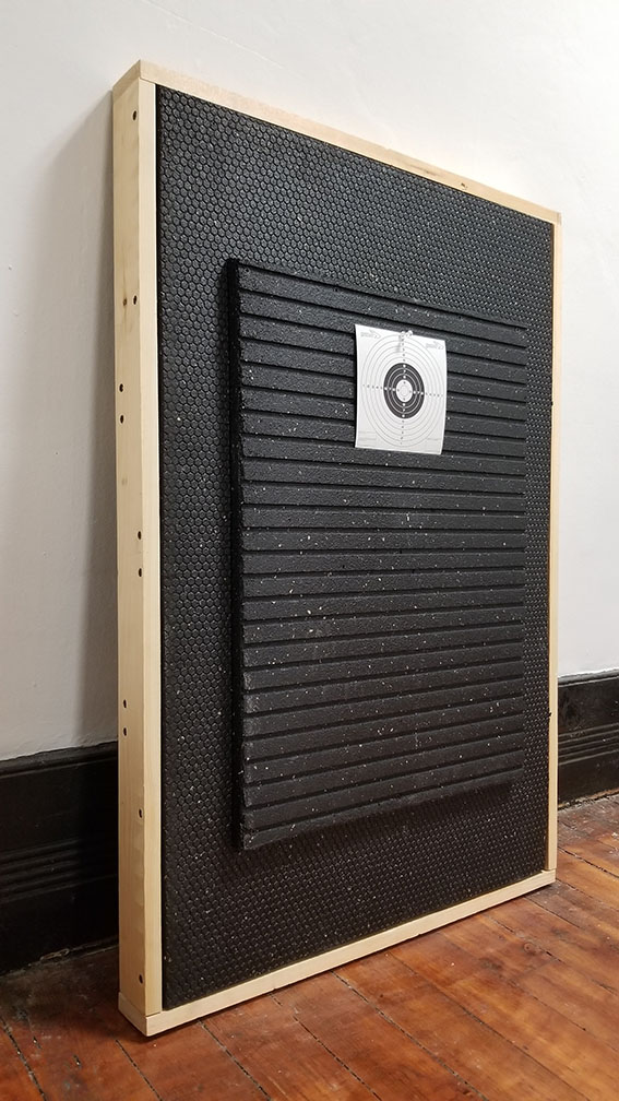

A few years ago, I designed a really nice pellet/slug backstop - [that I use for Indoor-Shooting]
You can check it all out here ----> INDOOR RANGE SETUP VERSION 2.0 on AirGunNation. 🤘
Trim wood, Sheetrock screws, and 'Rubber Stall Mat' and the mat is 1.5 inches thick.
It's been able to handle short-range hits THOUSANDS OF TIMES from .22 and .25 cal.

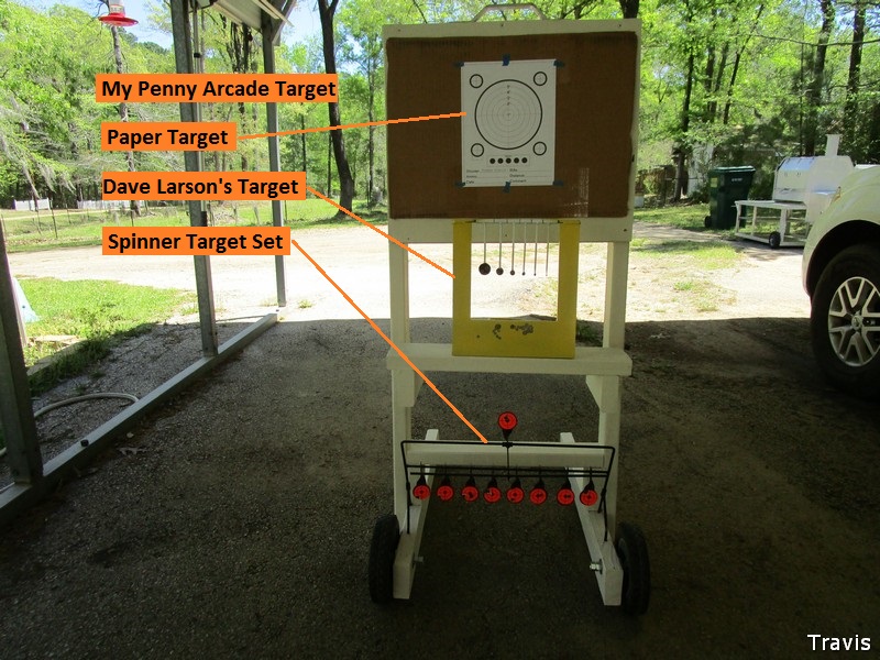

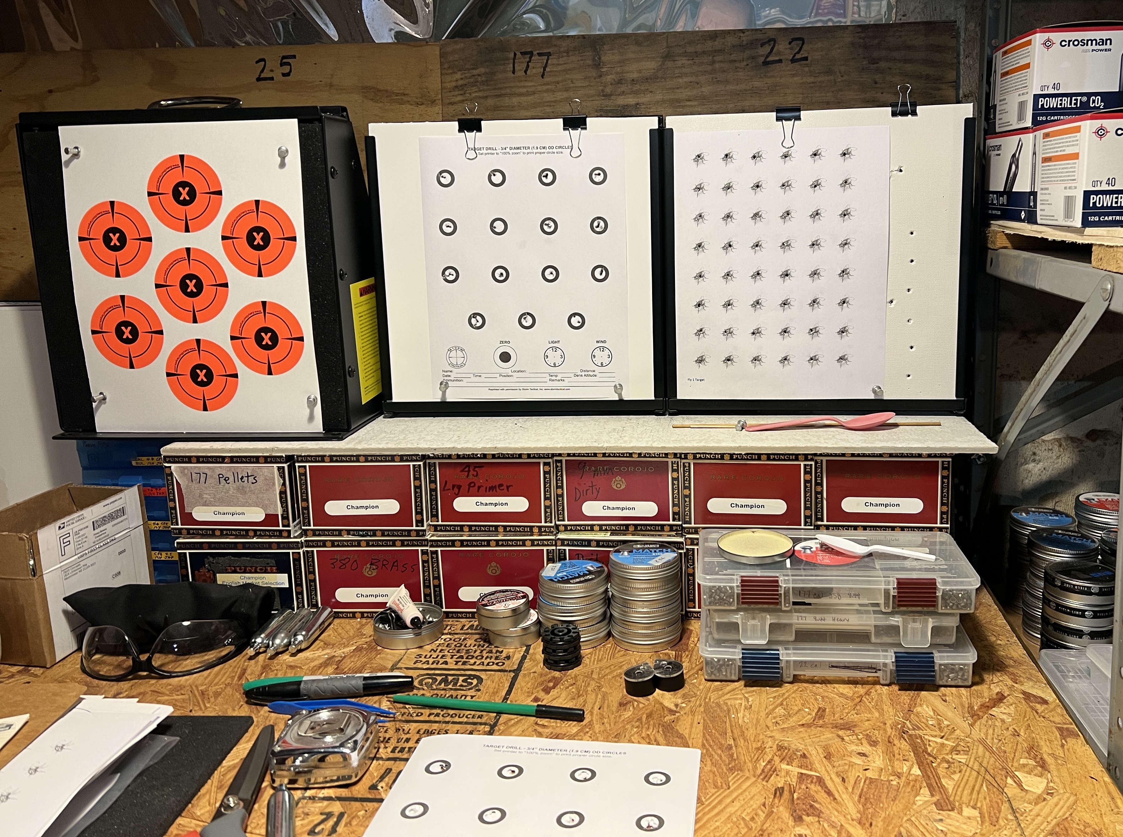

Hello everyone,
I have several "backstops" / "Pellet Traps" .

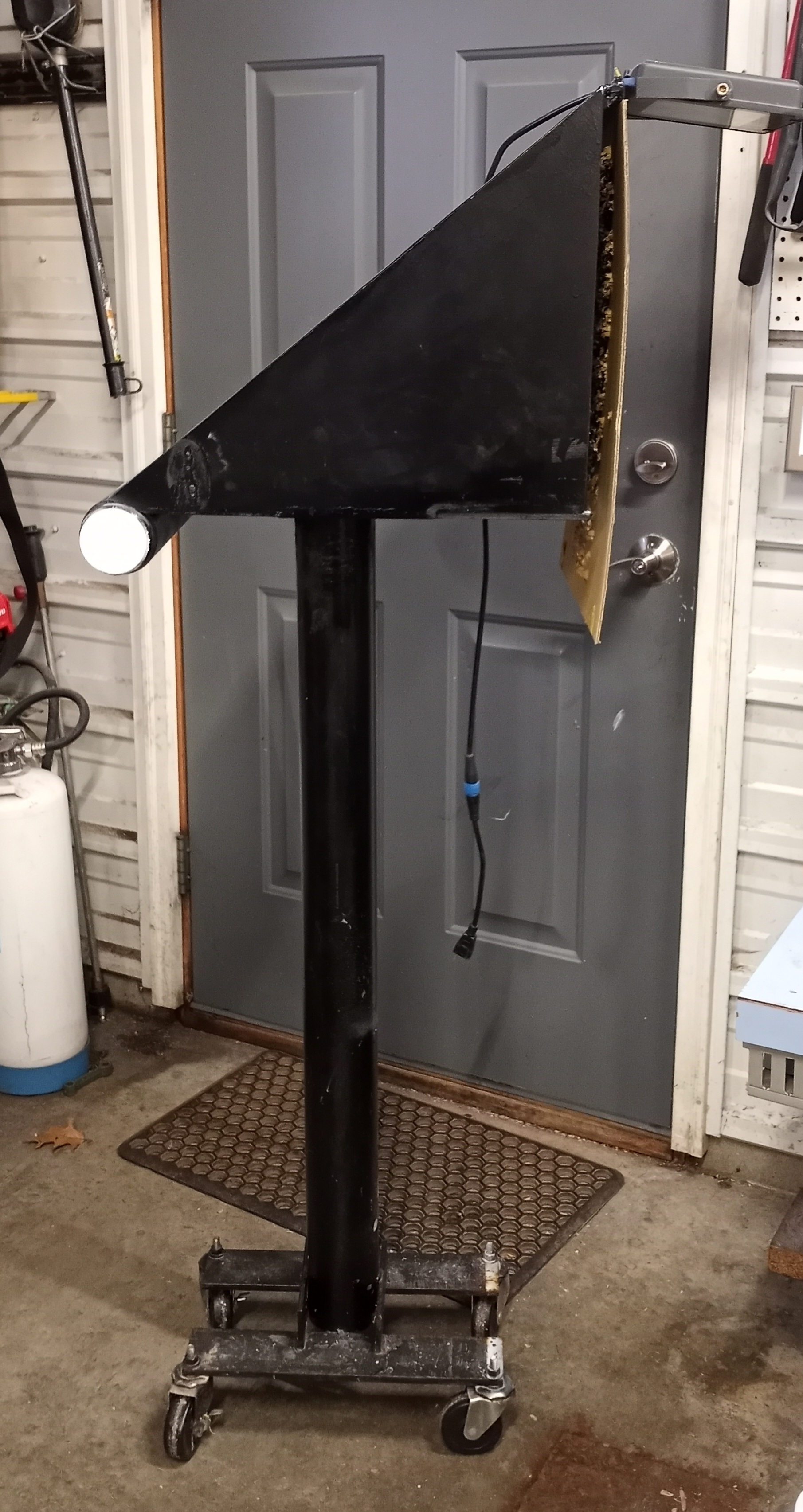

I have one that has wheel for my "roll around" target and any distance. Backing plate also 1/8" mild steel. I use this a lot for shooting @tcarlson777 30-Yard Challenge because it can be set up out behind my 25-yard target. ( first photo )

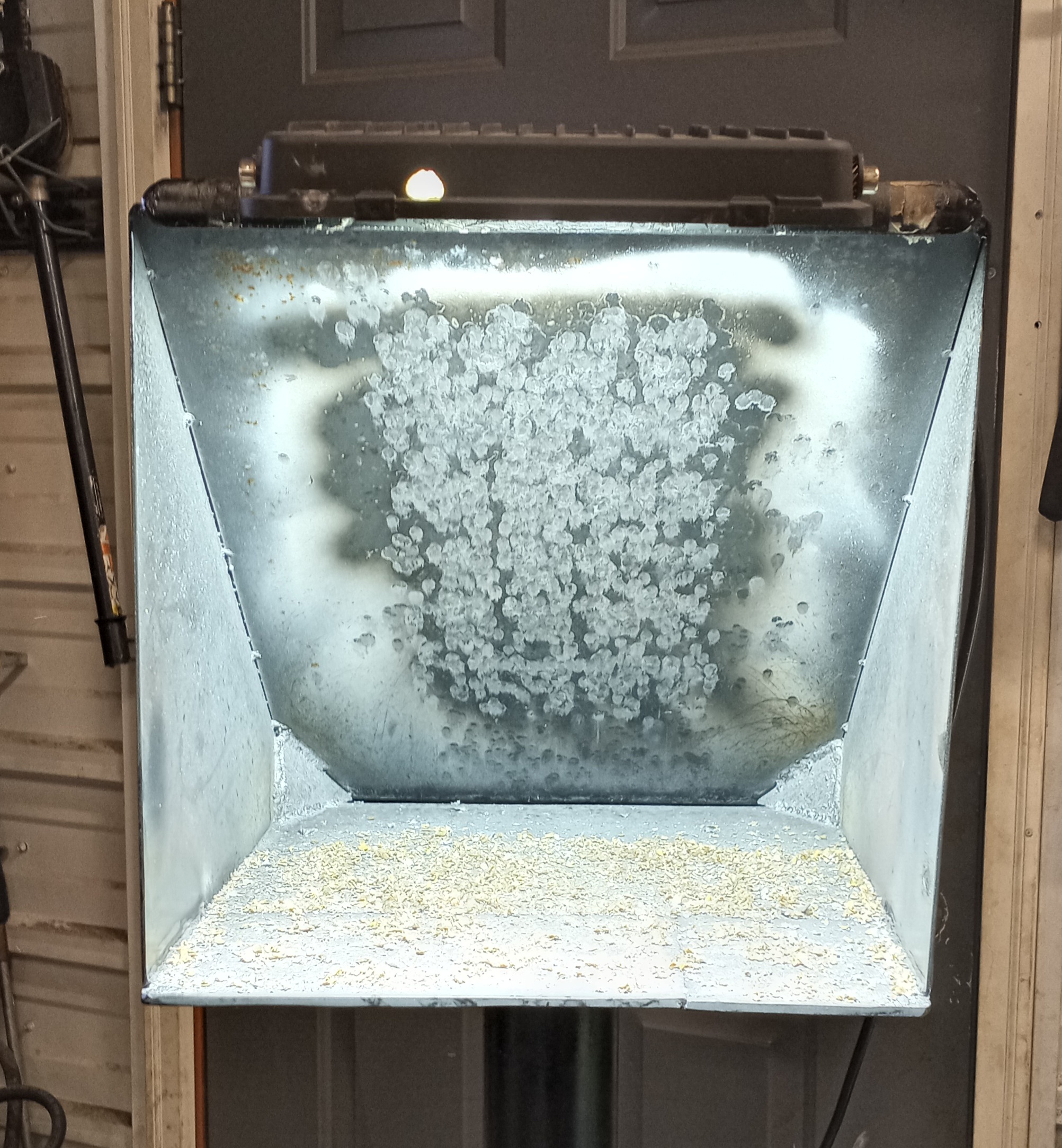

I also have two Big Bang Pellet Trap that I can use both indoors and outdoors. I have been shooting almost everyday during the cold and bad weather with these set up inside my shop at 15-feet. ( second photo )

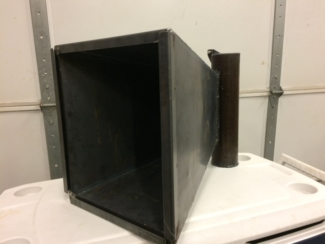

I have two steel backstops that I use for 25 out to 75 yard target shooting, ( third photos ) Made from 1/8" mild steel plate.
ThomasT

Hello everyone,
ThomasTView attachment 328497View attachment 328498View attachment 328496

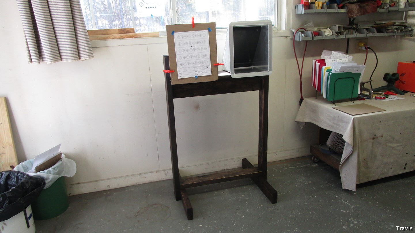

My main pellet trap is an old electrical box meant to hold a few breakers I found in my shed. The front face is a little bigger than a 8.5x11 inch target. It is about 3 inches deep and made of mild steel about 1/16 thick. I took the cover off and the insides out and screwed on 3/4x3/4 pieces of wood to fasten a cardboard face to. Inside I put shreaded rubber mulch. My most powerful PCP is only about 42 fpe, it shoots FX 25.4s about 930 fps. I have dented the back of the trap a few times when the rubber mulch slumped. I'm pretty sure I could shoot it with 33.95s going close to 900 fps without them going through.
It is not hard to separate rubber mulch from pellets. Just dump the mess out and use a lawn blower on it. The pellets will move a lot less than the mulch and cardboard/paper fragments.

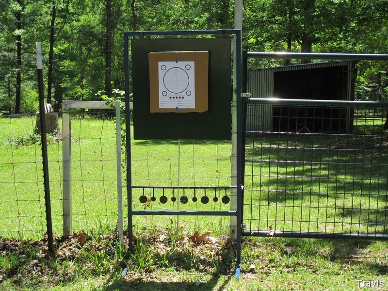

I don't miss my trap very often but if I do the pellet just goes into the lake. I also have some swinging targets (know your limits) and I put 2x2 foot concrete pavers behind them to avoid shots going into the lake. The area behind the 1/4 and 1/2 inch targets is getting some pretty deep craters from misses. I will have to turn them over soon and eventually replace them.
