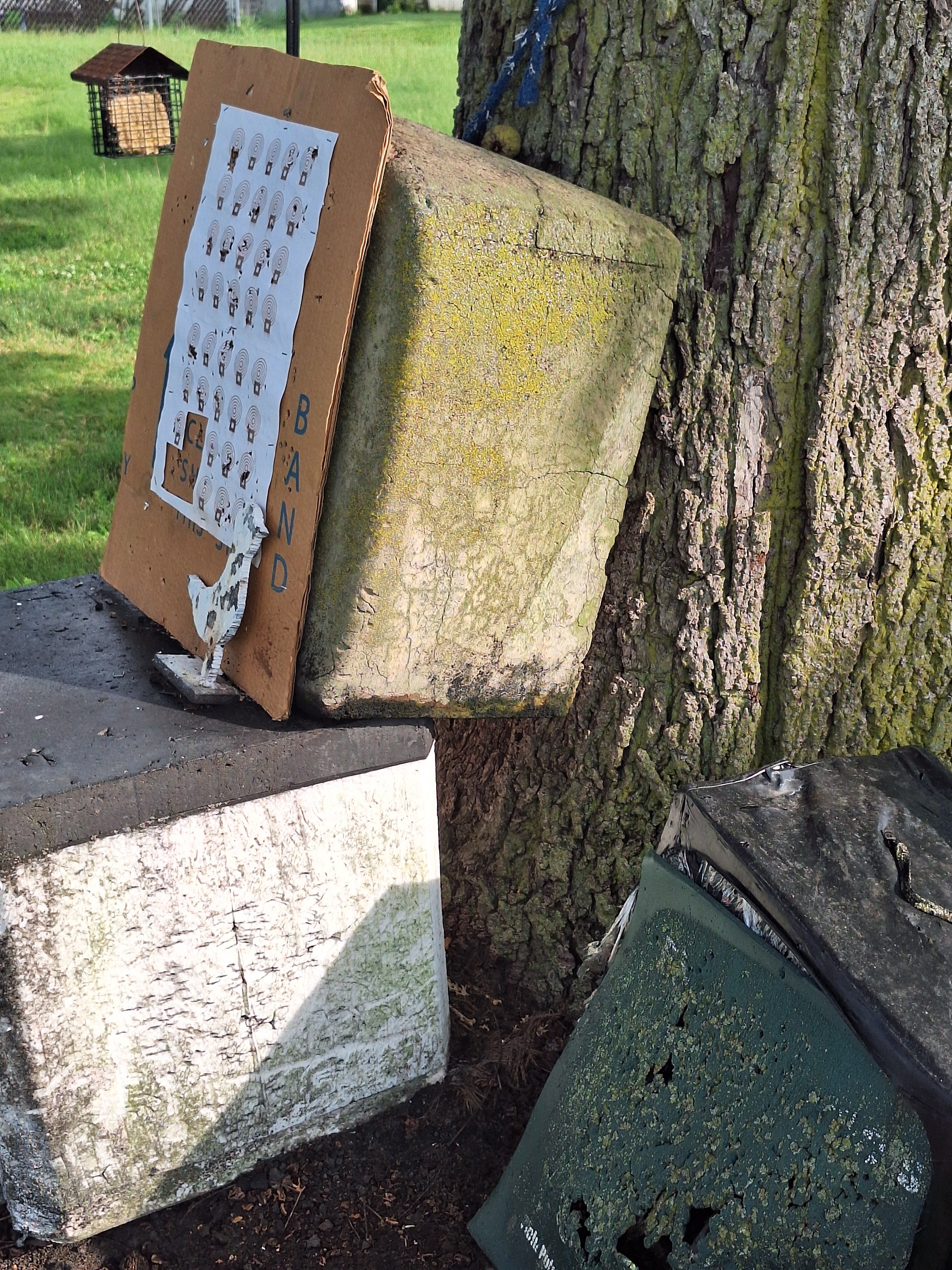

A Blob archery target. It has been used for bows over 100 FPE with broadheads, pellets at are no concern even a 45 caliber slug at 1000 fps is easily stopped! It has well over 10,000 pellets in it. still going strong!
I have an old Reinhart Rhino block, not as good, but more than ever needed for air rifles, shooting any projectile, including arrows.
