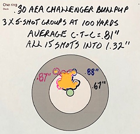

It looks like this-

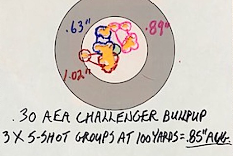

And this-
And considering the two targets above were shot consecutively, six consecutive five-shot groups at 100 yards AVERAGED .83" center-to-center; shattering my 25 year quest for one MOA average accuracy with an airgun by 2/10"! Shooting pellets, in fact. So, finally, 1 MOA airgun accuracy looks like this-

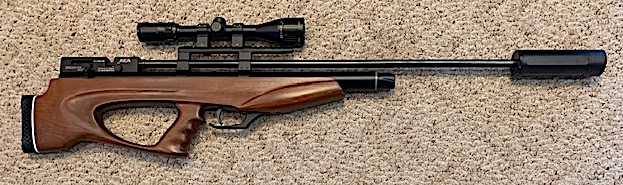

Yes, 44.75 grain JSBs.
"I predict a run on Challengers after seeing this!" Before that potential run gets started I should mention (again) that AEA Challengers won't do that. My Challenger does that after dozens of hours of detuning, trigger work, chronographing and accuracy testing, thousands of pellets sent downrange, and many, many dozen groups shot. Oh, and unreturned communications with the online dealer.
That said, I've invested equal or greater amounts of hours, pellets, groups, and monkeying with many top-tier, high-dollar regulated PCP's that simply could not be made to shoot as well. None of them could. So though not a gambling man, almost out of sheer frustration I decided to roll the dice with a $500 long-shot bet on a cheap Chinese PCP. The bet paid off handsomely.

Gerry, I assume you're interested in "the goods" specific to the .30 AEA; rather than the whole quarter-century saga. If so, I've already shared them in bits in pieces with multiple posts over the last couple months. I think you can find those posts by using the forum search function, keying on me and keywords like AEA and/or Challenger bullpup, and searching the General Discussion, Big Bore and PCP sections. Nevertheless, here's the condensed version of the goods.
1) On arrival I chronographed to confirm claimed 1240 FPS/150 foot pound power was true (it is), and checked trigger pull on digital gauge at 7pounds, 15 ounces! 2) Dressed the muzzle crown with rubber polishing rotary-tool bits, and cleaned the bore thoroughly. 3) Then shot enough groups at 50 yards to confirm accuracy promise. 4) Dove into the receiver, hammer, and hammer spring (which was unbelievably stout). 5) Rather than buying a weaker HS from the dealer for $39.95 (not a typo), I took the original spring to Ace Hardware and bought 3 potential replacements for less than $5 (of two strengths). The weak one proved way too weak. The other two being of similar strength to the original, I started shortening one of them, reassembling, chronographing, and "lather, rinse, repeating" until getting to the 80 foot pound power level I sought. In that process I also moly-lubed the hammer, HS, trigger and sear surfaces, and installed a weaker trigger spring. The trigger action remained crisp; and as hoped, trigger let-off came down to about 3#. 6) More velocity and accuracy testing at 50 and 100 yards proved she was responding well and continuing to show promise as pellets downrange added up to a couple hundred. The much weaker HS produced the bell-curve power-band I sought at 80 FP, with a power-band of six competition-worthy shots per charge of only 120 BAR. 7) Cleaned the bore again to find lead slivers! 8) It took quite a few rounds to season the bore before accuracy returned to previous levels. And as shot-count added up, improving accuracy (enough to keep me motivated). 9) As shot-count passed several hundred rounds and dozens of groups the promising accuracy continued improving, interspersed with occasional bore cleanings producing more lead slivers. 10) As round-count approached a thousand, with accuracy approaching that of any airgun at any price, but only six competition-worthy shots per 120 BAR fill, I overcame my fear of the great unknown and ordered a Huma regulator to take advantage of the fact it would allow me to charge the rifle to as much as 300 BAR to increase shot-count per fill substantially; thereby removing a major handicap when competing against the best airguns on Earth in competitions to 100 yards. 11) Set the reg output pressure to 130 BAR and installed it... successfully! 12) Of course that affected the power produced, so more HS monkeying (to avoid having to remove the reg). 13) She simply did NOT want to shoot the 75-80 foot-pounds I needed, so "more monkeying" became MUCH monkeying, as shots per 280 BAR fill hovered around 18-19 (very consistent). 14) In the LONG process of seeking 75-80 foot pounds I started throwing o-rings and spacer-shims between the hammer and valve-stem (per 'B Staley' hammer-debounce tune); mostly to find my target power level, but also greater shot-count per charge. After many hours of such monkeying she finally landed at 870 FPS/75 foot pounds with 44.75 JSBs (my minimum acceptable level). However she now returns 34 regulated shots per 280 BAR fill! 15) That is the exact point when Ching Kong started consistently averaging sub-MOA groups at 100 yards; down from previous averages of 1.06" to 1.4".
If you've ever heard the saying, "even a blind hog finds an acorn once in a while", and are still with me, you just lived through proof-positive of that statement! Aren't you sorry you asked? :-O Now you know why I don't mind sharing "the goods". No-one in their right mind would be dim-witted enough to invest so much time and effort in a Chinese Maxi-Blaster on the 'long-shot' it could be transformed into a competitive long-range Extreme Field Target and/or Extreme Bench-Rest Silhouette rifle. But this is how I get my kicks.
