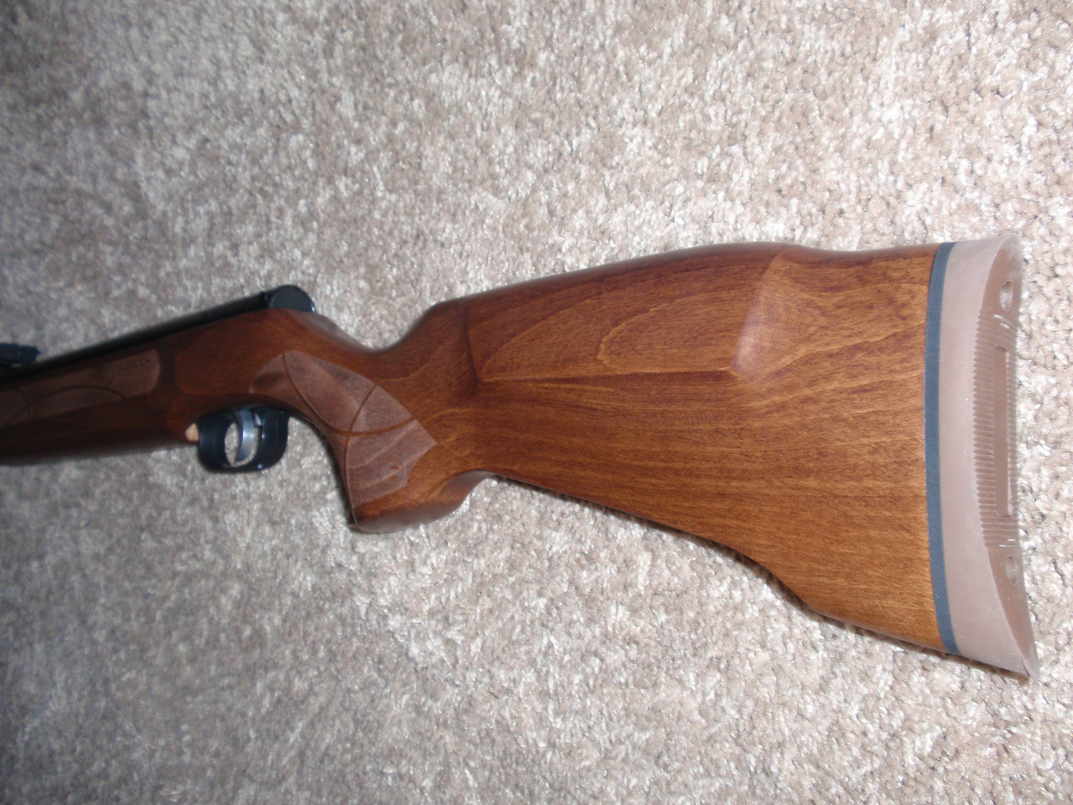

Here's two Beeman sold Weihrauch, serial number 124xxxxx and 125xxxxx. The R1 came in a box labelled "select stock", has an unusual colored original
stock, but the R8 has, I think, a much prettier stock? What does "select" really mean?

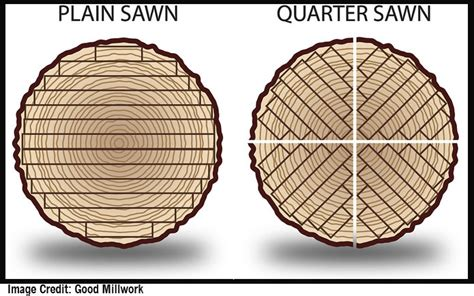

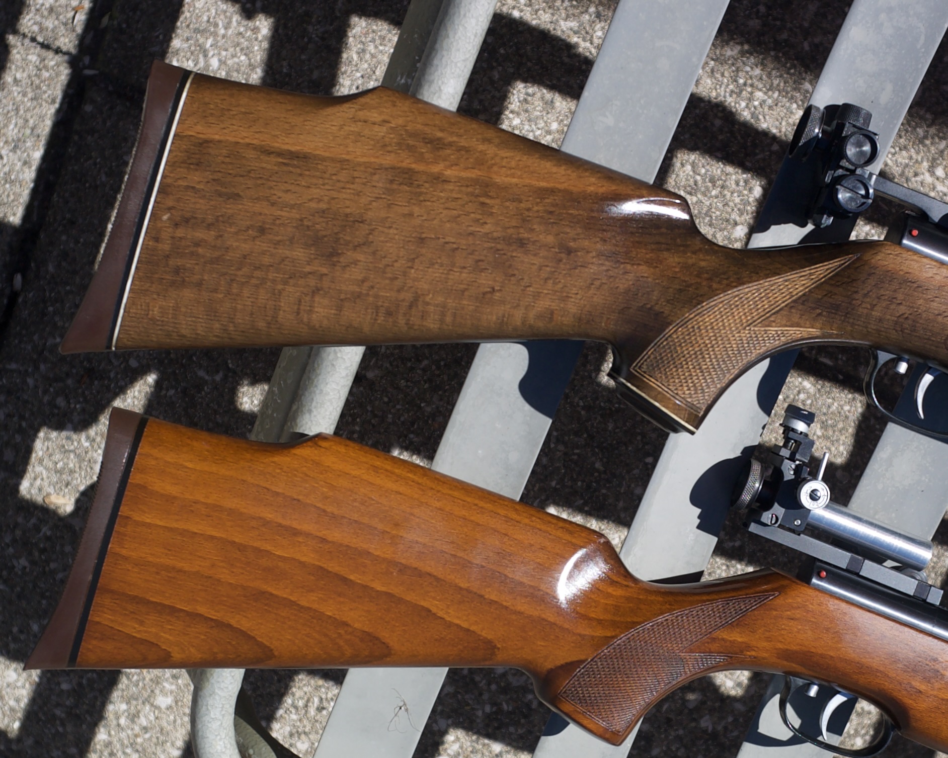

The top stock is quarter sawn lumber, the bottom one is plain sawn. Quarter sawn lumber is less likely to warp.
Look close. The plain sawn log has some quarter sawn lumber too. Cut the center boards in half. Quarter sawn beech shows medulary rays. The R1 stock displays it. But it doesn't always look so good as that. Sometimes the plain sawn lumber looks good. HW50

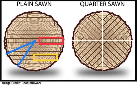

I would speculate that most mass-produced beech stocks are plain (or "slab") sawn, for reasons of economy. Which is a bit of a crap shoot - graining can range from yawner to gorgeous! The medullary rays (which run radially from the center - blue lines) are very small in many kinds of wood, but form prominent flakes in beech, and thus telegraph where the blank sat in a log.
As KWK noted, the piece highlighted in red below, would be indistinguishable from one in the center of a quarter-sawn group; the rays might be narrow highlights on the top and bottom edges. But as BoG pointed out, in the yellow one they might appear as nice wavy figuring, in different positions on each side of the stock.
PS: apologies to JohnL57 for stealing his nice illustration! 😀

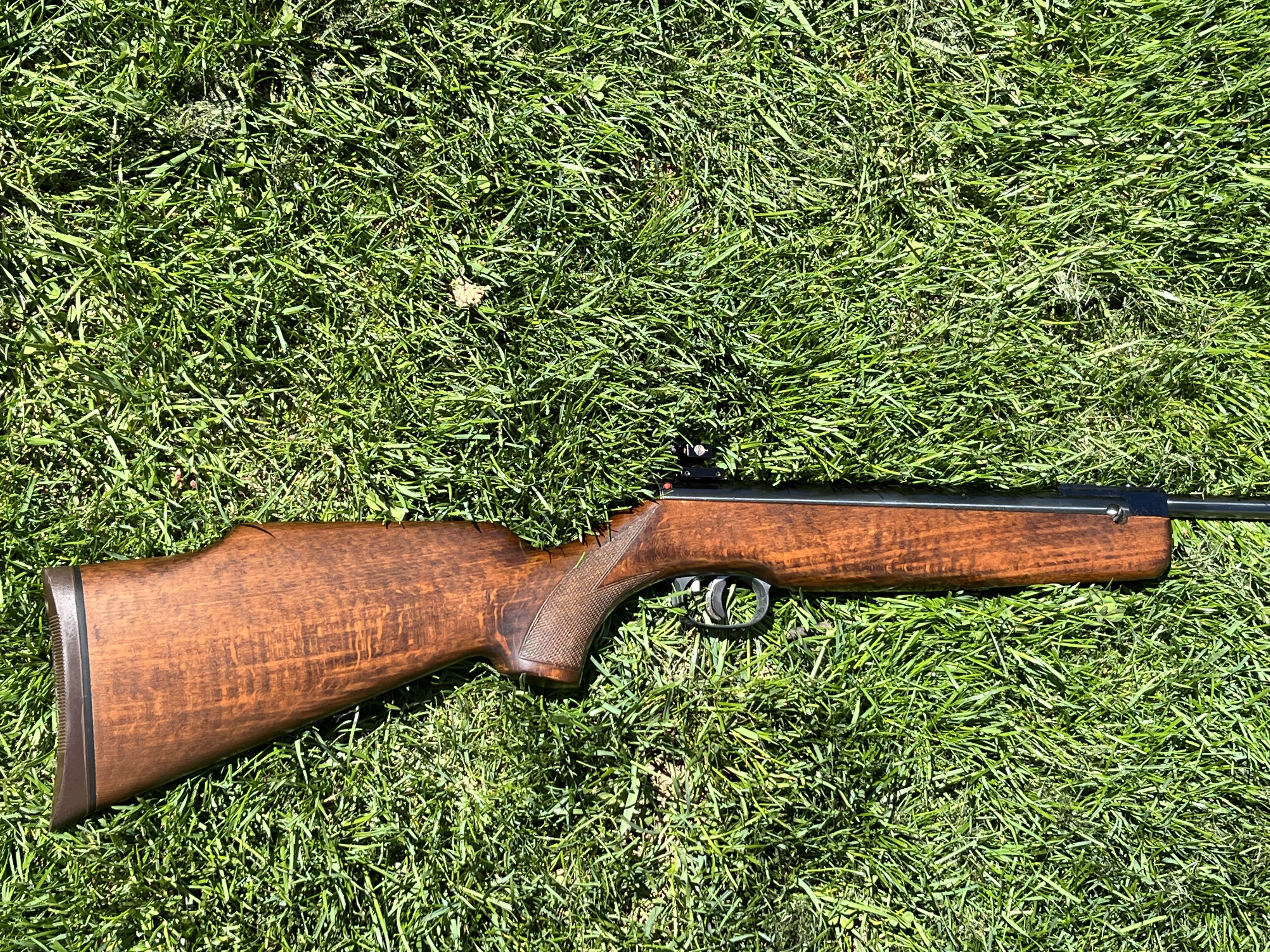

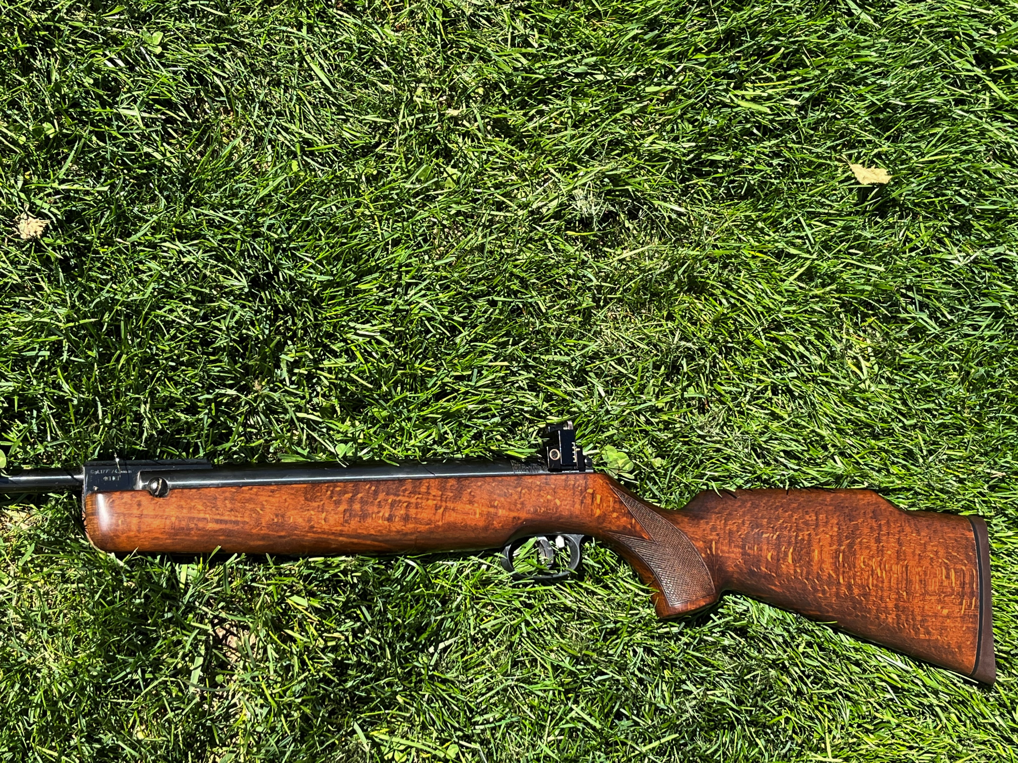

This baby's quarter sawn. R7 Look how the sun lights it up
View attachment 385043View attachment 385044
The outstanding beech blank in KWKs post blows my skirt up the same was a good walnut does. What a treat to get my eyes on that, even in pictures!
