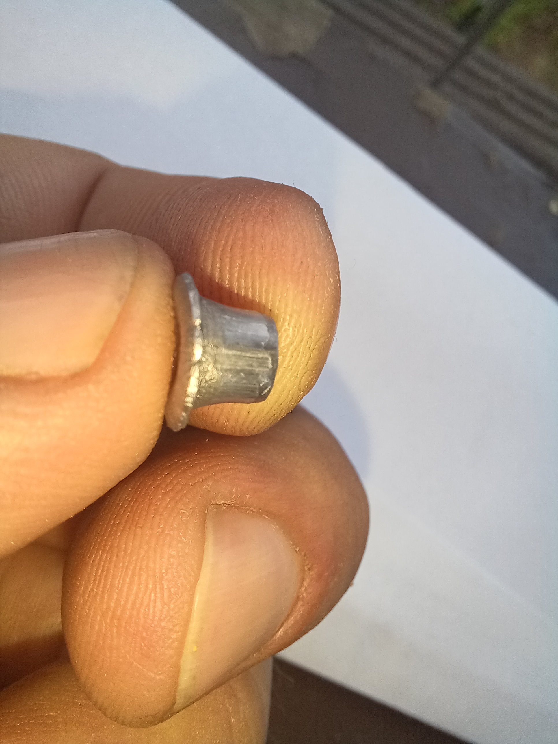

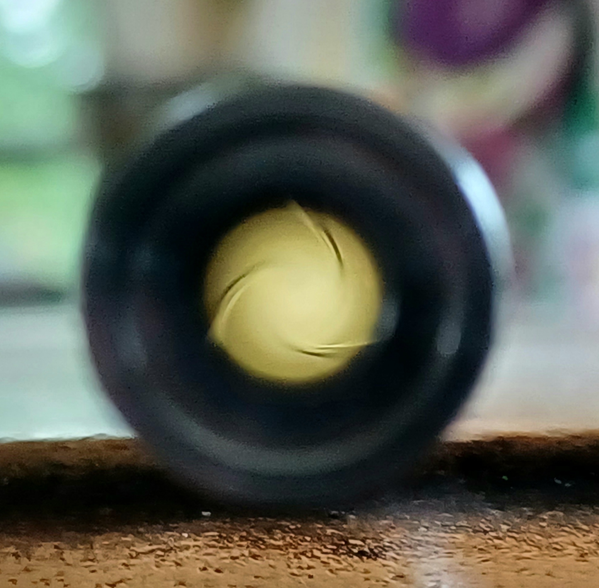

What effect does the amount of lands have on the projectile?
the depth of the land was much more important than the number when we did research back in the early 80 -90s for powder burners, however less land were better
octagonal barrels pissed over almost everything
Musgrave used 5 lands on the Musgrave RSA target rifle when everyone else were using 6 or more, and got banned from most international competitions as unfair advantage
