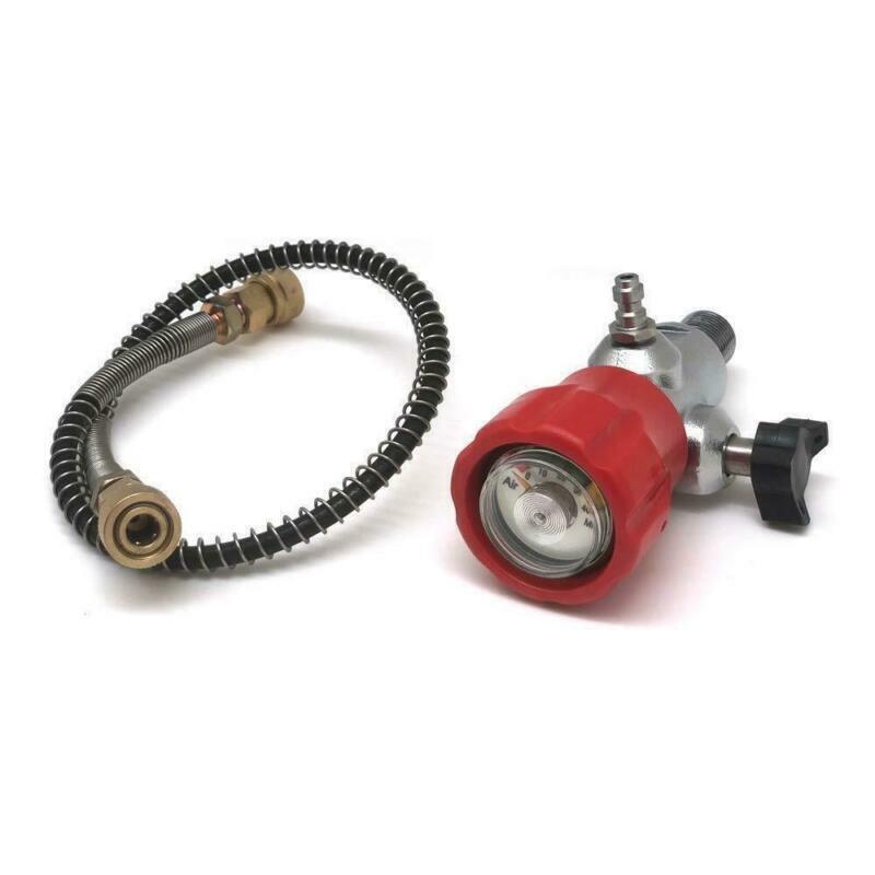

I would like to buy a filling station for SCBA tanks with a quick bleed valve –– or a bleed screw that goes EASY IN and OUT.
I have one filling station that has a "button" on it, the quick blead valve. I give it a push with my thumb, and in one violent Pfffft all the air in the line is gone. EASY!
The other filling station I have is a (China-)pain: It has a bleed screw. I need to unscrew it hard, it hurts, I don't like it at all. And that despite the fact that the screw is large-ish and has 3 blades to apply the force of my fingers better. And as people with whom I shake hands at times confirm: My fingers aren't weak.
That filling station model is pictured below.

The fx 500 cc has a metric thread. The standard scba has an imperial thread and should be a size bigger. The fill station I like is the Ninja one. Super easy to use with just one big knob that both turns air on and bleeds. The push button one is a challenge to repair and I sold it. The chinese and the "airtanks for sale" are a pain to use so I use a Edgun Ezfill on the hose, so I don't have to deal with the bleed screw.
A little pricey but I like the Stikman fill station. Have not had any problems and I even coil up the hose and then connect the hose end back to the fitting on the side of the Stikman to keep it coiled up and QD free from dirt.
Thx
Dan
Matthias, an standard SCBA tank uses a CGA347 fitting. Get a $45 one off Ebay. I've got 3 that I've used for the last 5 or 6 years with no problems. However, the pictures you show are for a REPLACEMENT VALVE that screws into tank collar. Can you post a pic of the SCBA tank you're using? The cga347 fill adapter (get a "hand tight") on ebay has a bleed screw. It's very simple & easy. No need to spend big bucks!
I am using two. The Huma externaly adjustable regulator when the gun is connected to the tank for BR shooting. Also have the Egun eazy fill which is comfortably mobile. The easy fill I got was pretty pricey but several weeks later the clones surfaced at eBay and aliexpress for a 1/3 piece price. I have 3 large tanks and two I upgraded with that one from your picture, acecare (aliexpress) if I recall the name correctly.
Mine came from "AirTanksforSale" - Joe Brancato. It was not cheap but I tried a cheap Chinese set and was totally dissatisfied. It leaked so it didn't really work at all. I asked for input on- line and found issues were not unusual so I bought a "good one". The bleed screw is a nicely knurled and big enough knob that turns easily. It also has a good gauge I use rather than the gauge on my guns. Small hose too so filling a small gun like my Prod is easier. No complaints at all. Using air at the pressure we do is more comfortable with equipment that works well.
I had the same overwhelmingly negative experience with a cheapy ebay fill station. I have a Joe B fill station for my SCUBA tank and it is high quality. My SCBA fill station is a StikBoy and it is also high quality. No complaints from either.
I'm normally onboard for saving some $$$, but I'm the case of fill stations, the attempt to save money ended up costing me more in the long run than had I just bought quality initially.

The paintball fill station you found is crap I have 2 and had to fix leaks on the gauges, it also has a separate bleed. The the tiny silver knob on 1 side, has a tendency to fall off during transport.
The stainless bleed screw is top notch.

🔆 I'm thinking of getting a couple of the 50 dollar fill-stations. Then if one bites the dust, I have a replacement. 👍🏼
And still $50 left over in change compared to expensive fill-station....
🔆I'll order a few replacement gauges as well, then I'm prepared should they decide to fall off. 👍🏼
Thanks for the heads up!
Matthias
The dimensioning system, metric or imperial, is not a quality plus or minus. Either work fine as long as they are properly implemented. I believe the SCBA tanks sold for firemen to use may be significantly higher in quality and may therefore be useful well after 25 years. But I cannot prove that. They could have been made with metric threads but they were not.
I hope you have a lot better luck with inexpensive fill sets than I did.

The bleed valve in your 4th bullet point is 1/4-14MNPT. It is highly unlikely you would ever find that size female thread on a SCBA tank valve. I think likely you’ll find 1/8-27FNPT (female thread) on them for valves and or gauges.
Totally agree, Stikman or Air Tanks For Sale products are very reliable.
I have 2 of the 'air tanks for sale'. The newer one which I think is 3 years old has a great presure release and the older one which has these horrible plier marks on it that will actually cut my fingers now if I use them to relieve pressure 😵.
The knobs will swap out but the older one has to have it's valve really tight un order to not leak. Opon further inspection I noticed the older version has a larger orifice compared to the newer one. Of course the thread size is totally different from standard blead screws.
