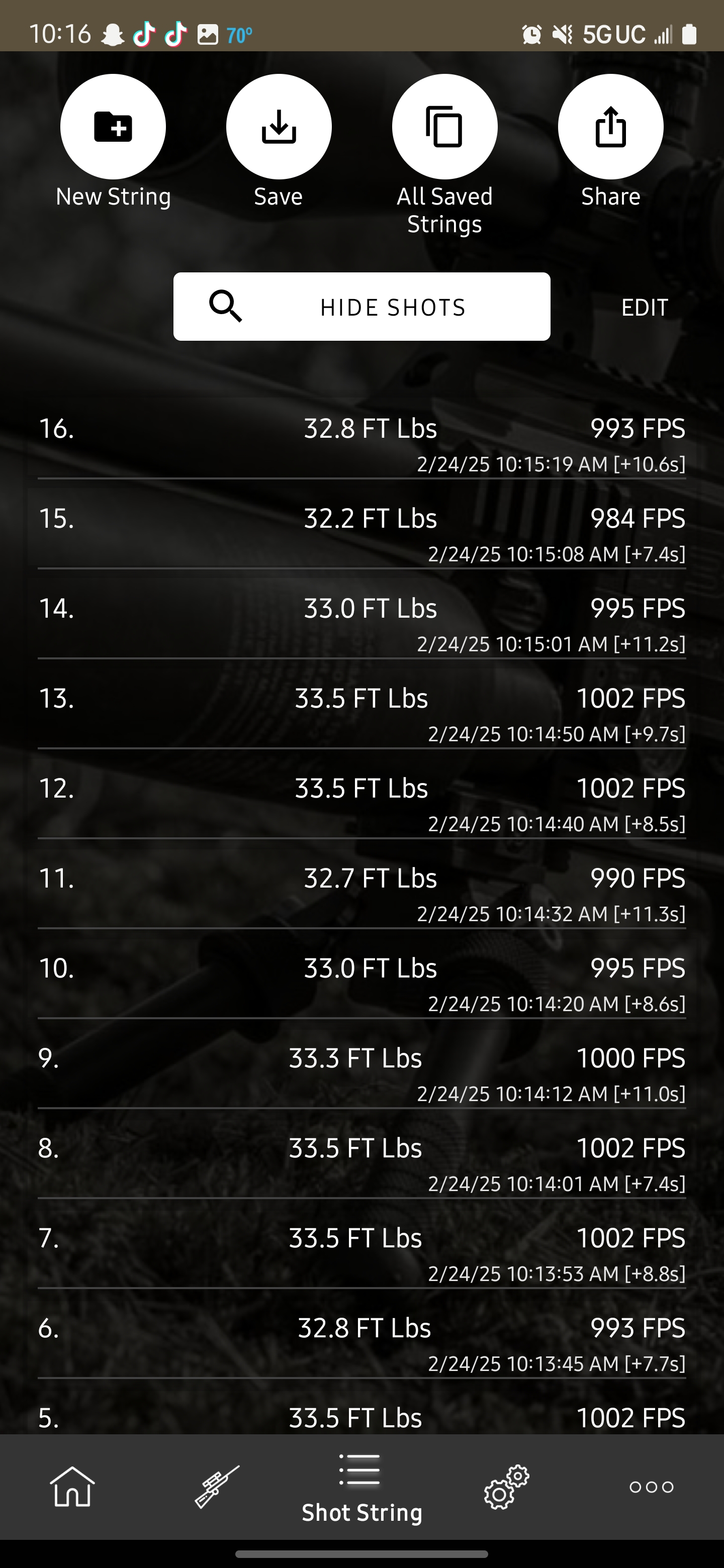

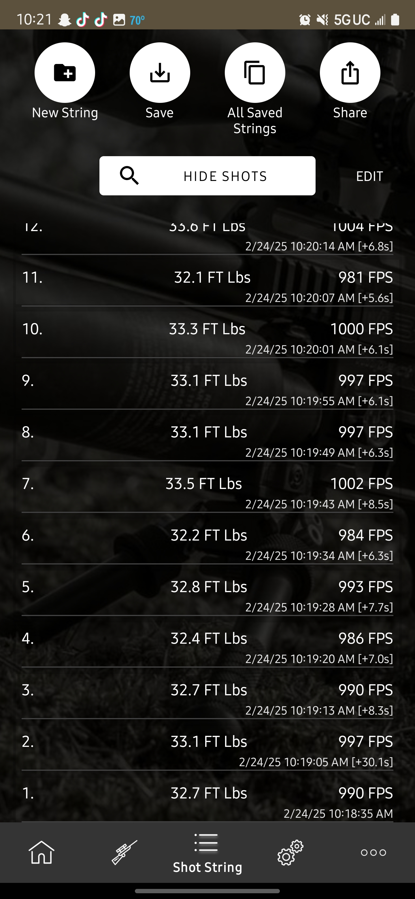

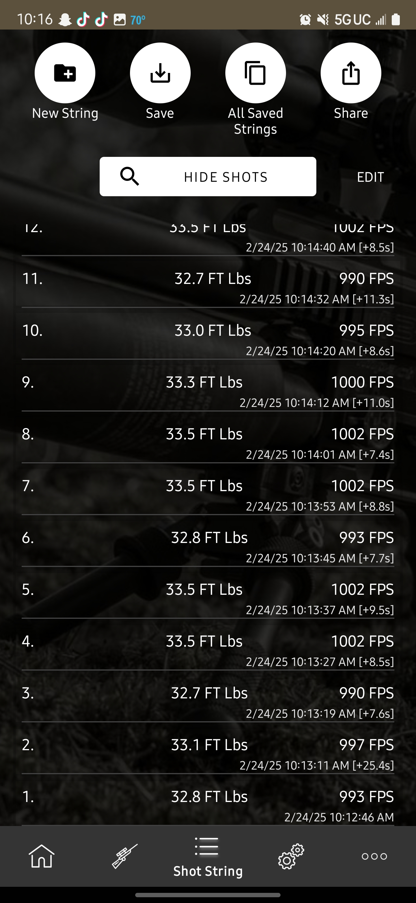

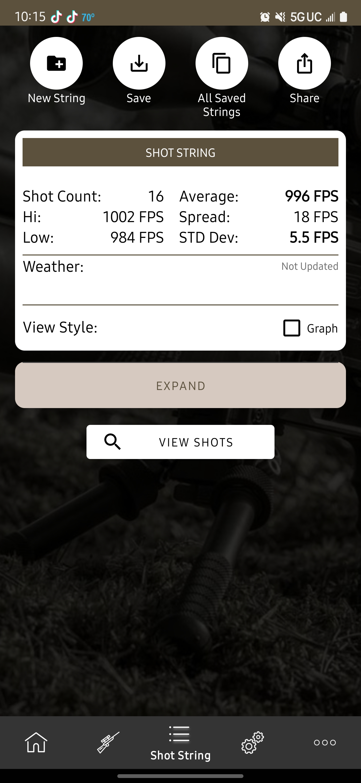

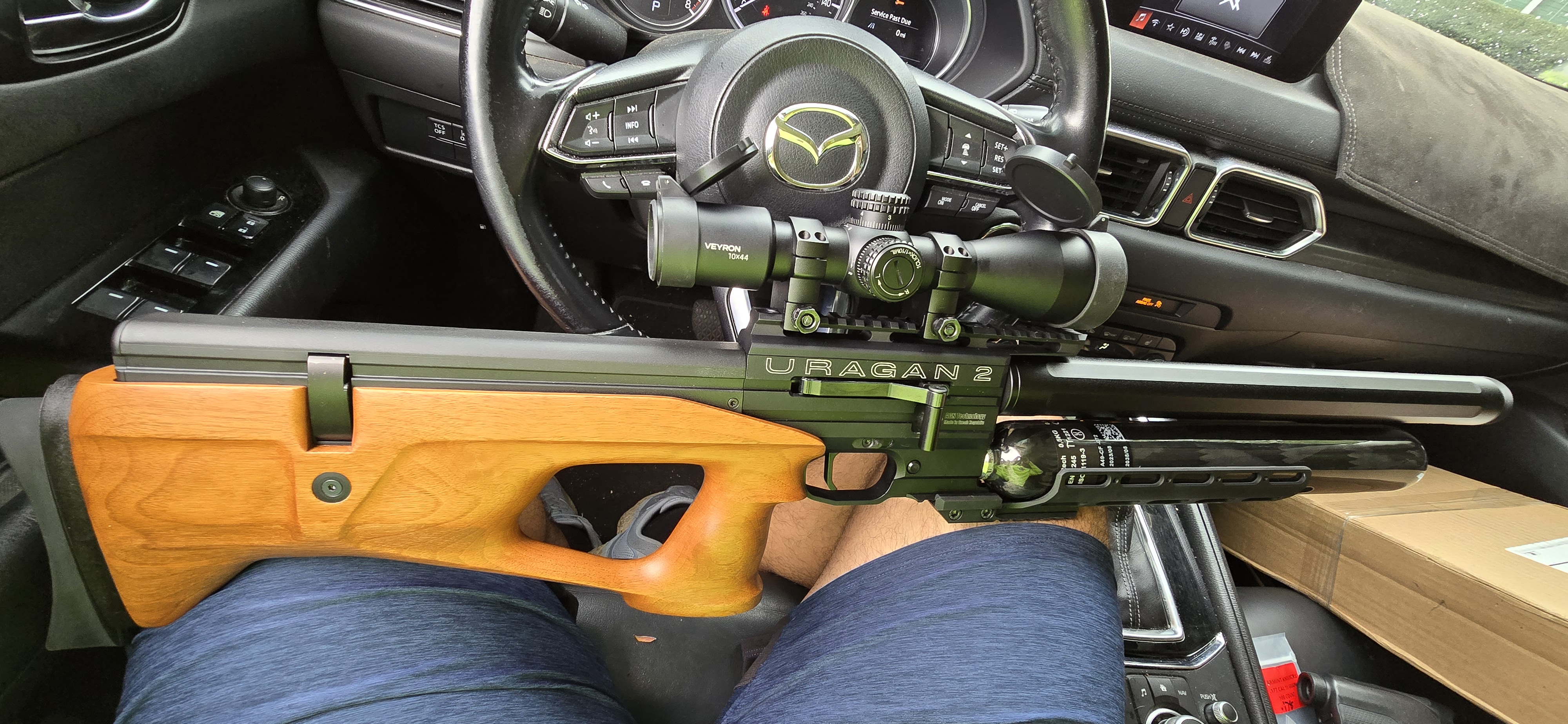

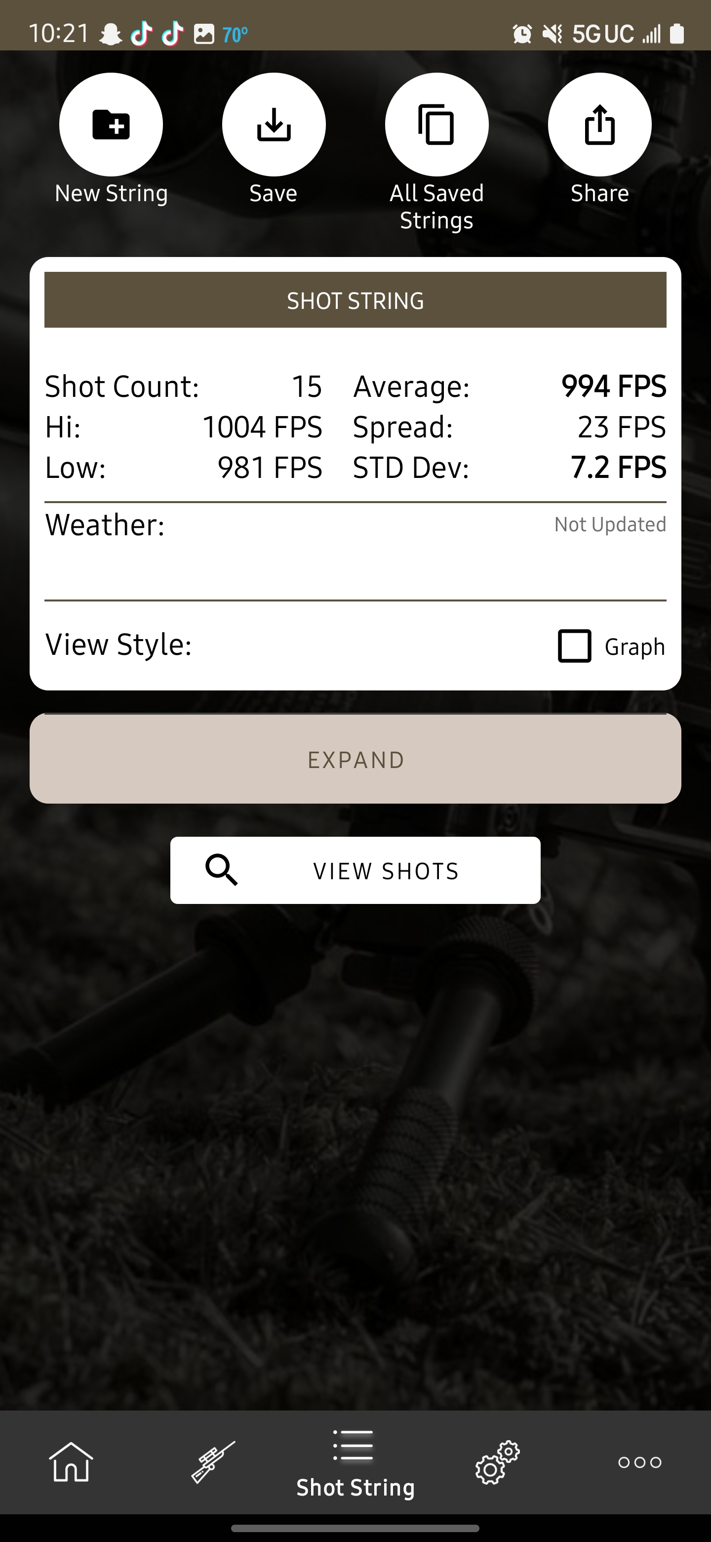

May not be a traditional rifle stock. But it's.177, wood, ambi cocking, and the mag sits in the middle. OAL 35.4" and I currently have it tuned to shoot 15gr slugs at 33fpe or 996fps average.
Even at this power I'm getting over 70 shots

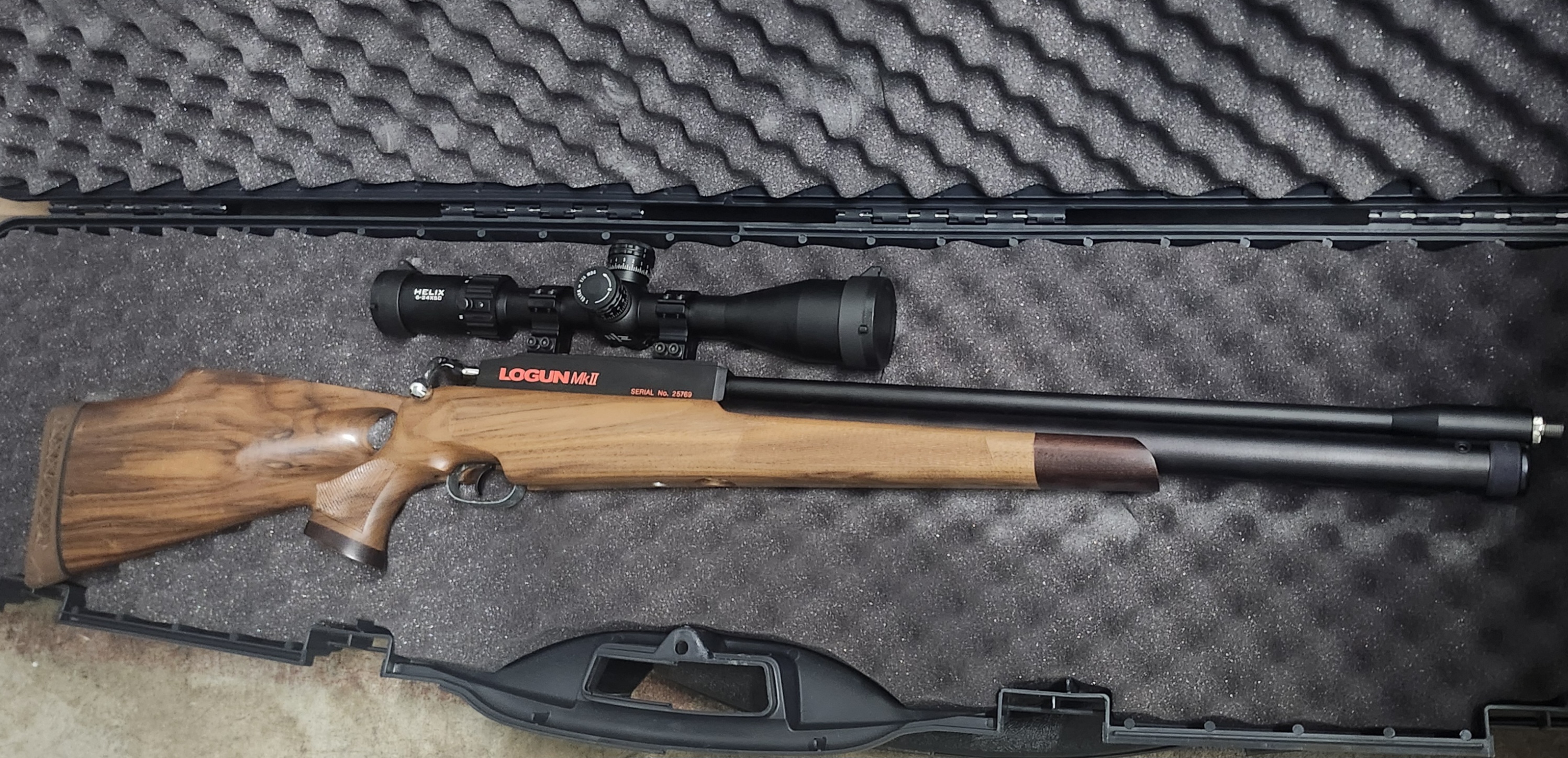

I have a Logun MKII in classifieds but it's definitely a right have shooter only. I get it. Unfortunately capitalism caters towards the masses.

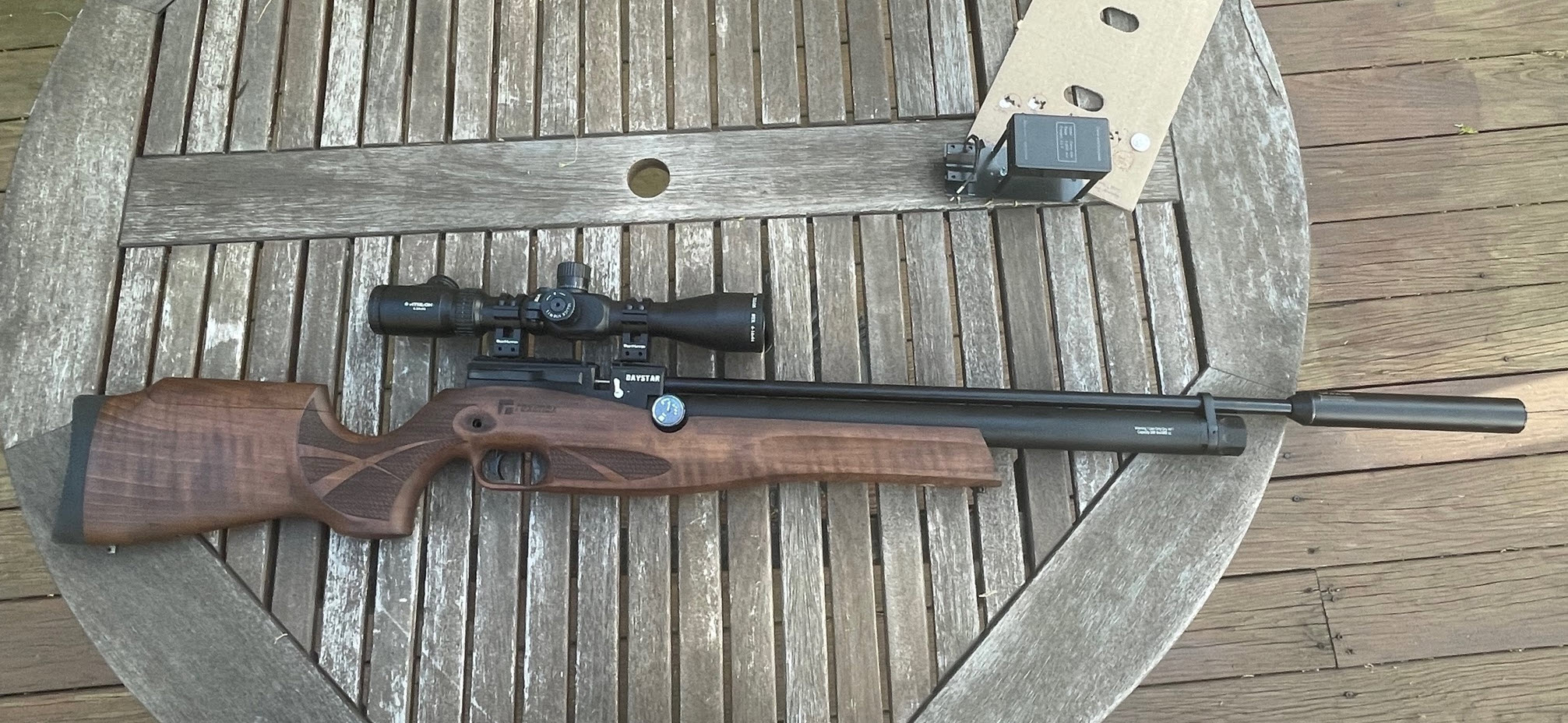

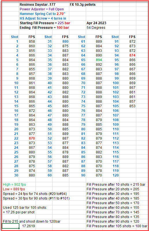

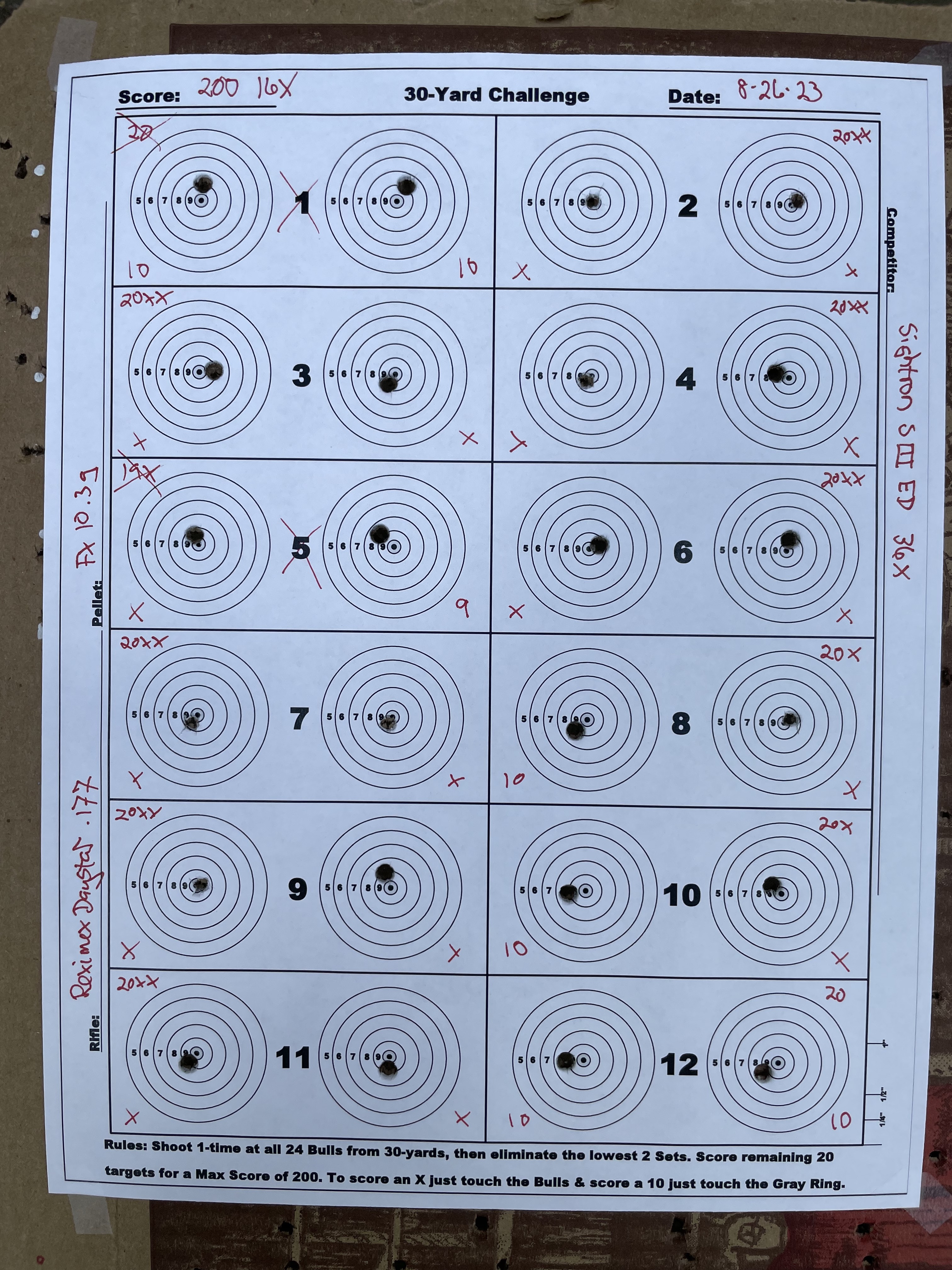

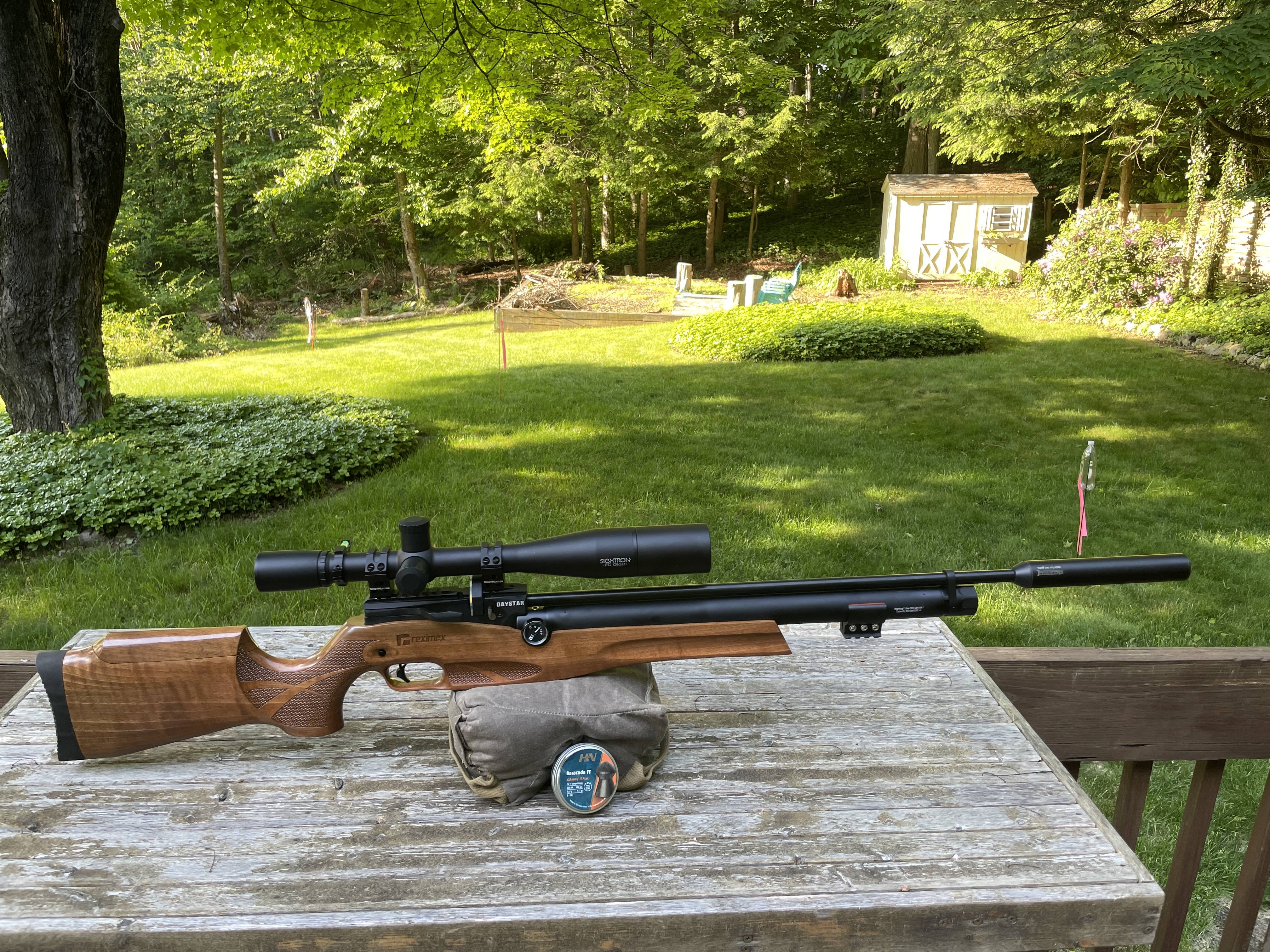

I second what thammer stated... turkish Reximex Daystar Pretensis is awesome in .177. (thammer showed a Kuzey - essentially the same rifle as the Daystar.
I would not regulate it, but if you insisted, it uses the same Huma reg as for the Benjamin Cayden/Akela. Instead, I recommend cutting the hammer spring to 2.5 to 2.7" (5 minute job - tons of research into this). You will get a shot string like attached.
Yes, I refinished the stock - light sanding and tru-oil rubbed in (cost less than $10 and some elbow grease). Showing original finish as well.
It is about as long as an FX Crown with a 600mm barrel - that's pretty long - especially for .177
I shot a 199 15X 30-Yard Masters today with a .177 Akela in the wind. My experience is that the Turkish barrels, especially in .177, are really
good.
The Daystar is currently available and on sale at Canada Shooting Supply for about $450 (US Dollars - favorable exchange rate). Currently only the full power (PAL) .22 version is in stock. They do have the low (Canada restricted) power .177 in stock, but not the PAL .177:
-Ed
