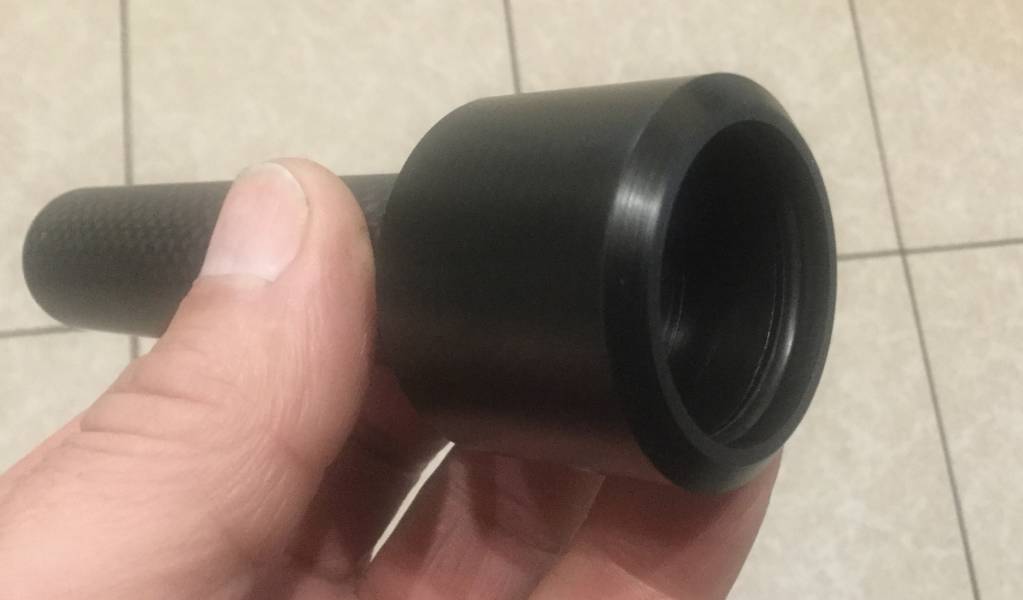

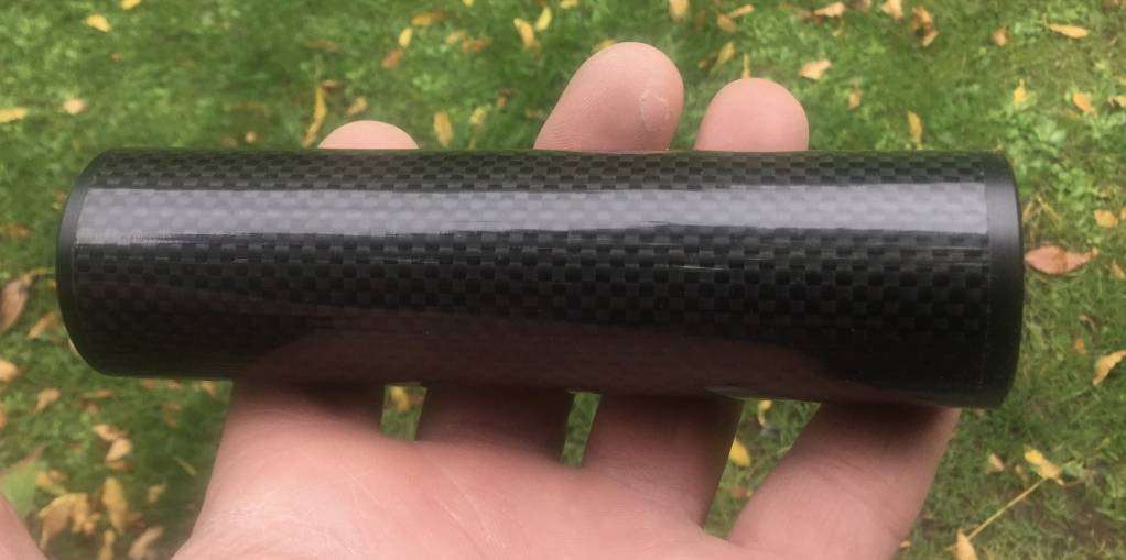

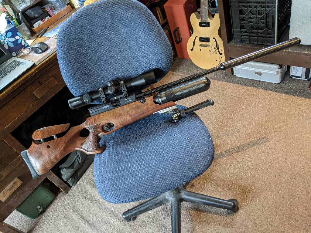

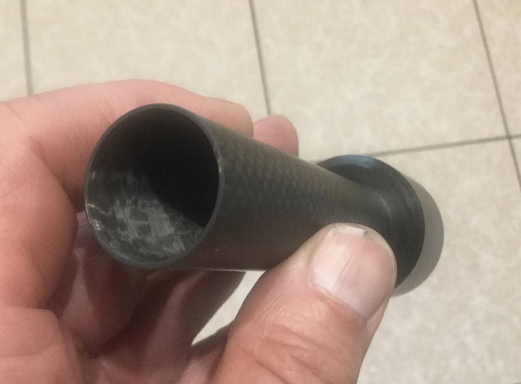

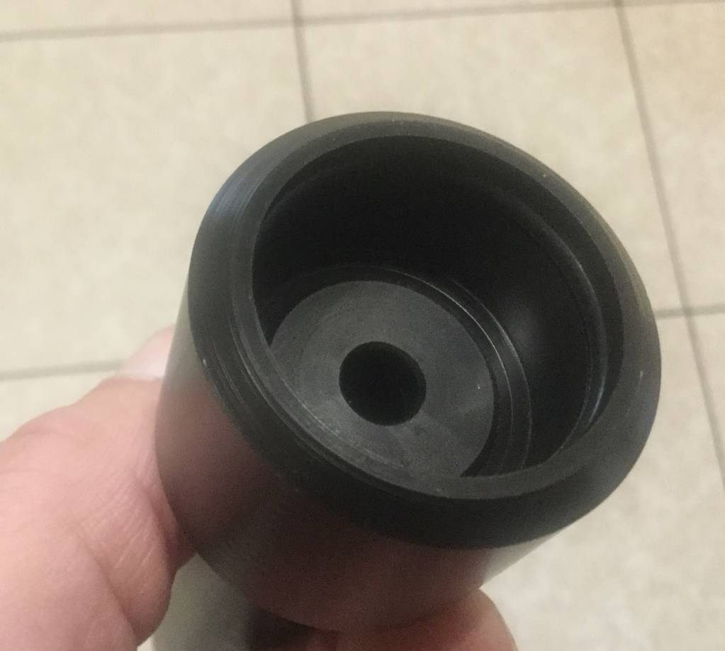

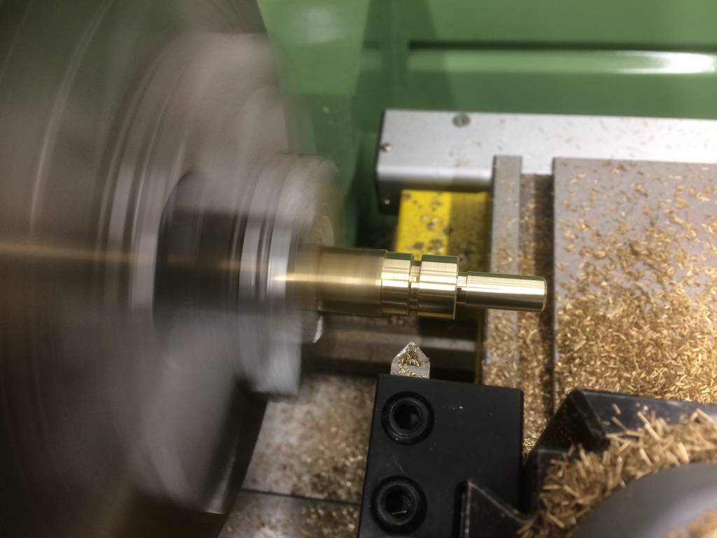

I made this 1/2 unf compact carbon mod, 5“ x 1.5” and less than 4 ozs. Obviously not as good as a longer moderator but it certainly makes things a whole lot quieter than with without.
Admirable. My tools are in the kitchen. Wish I could offer someone some fantastic chili in trade for my utter lack of comprehension around other tools and machining.

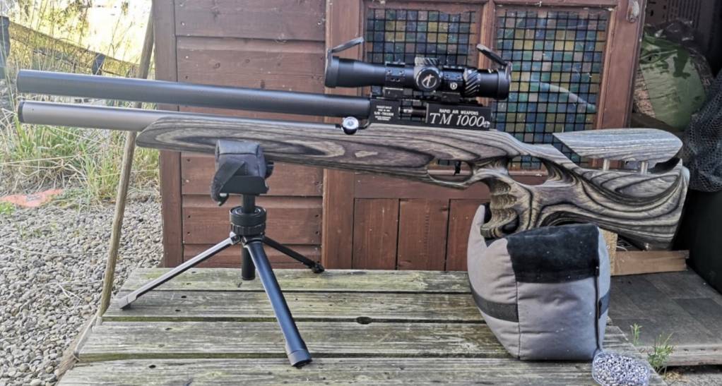

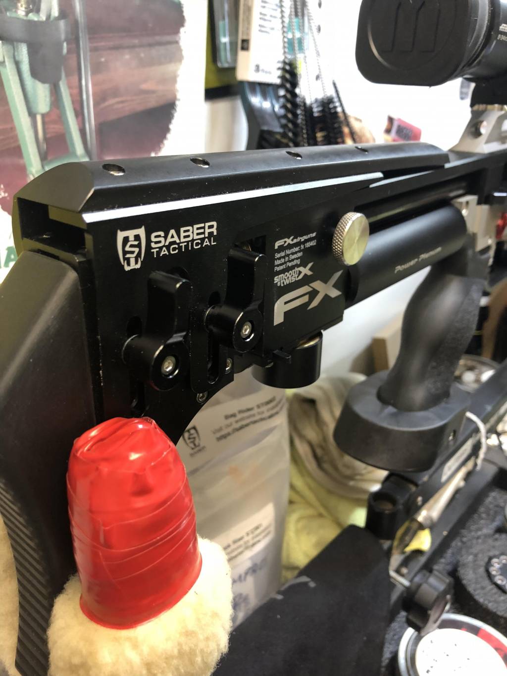

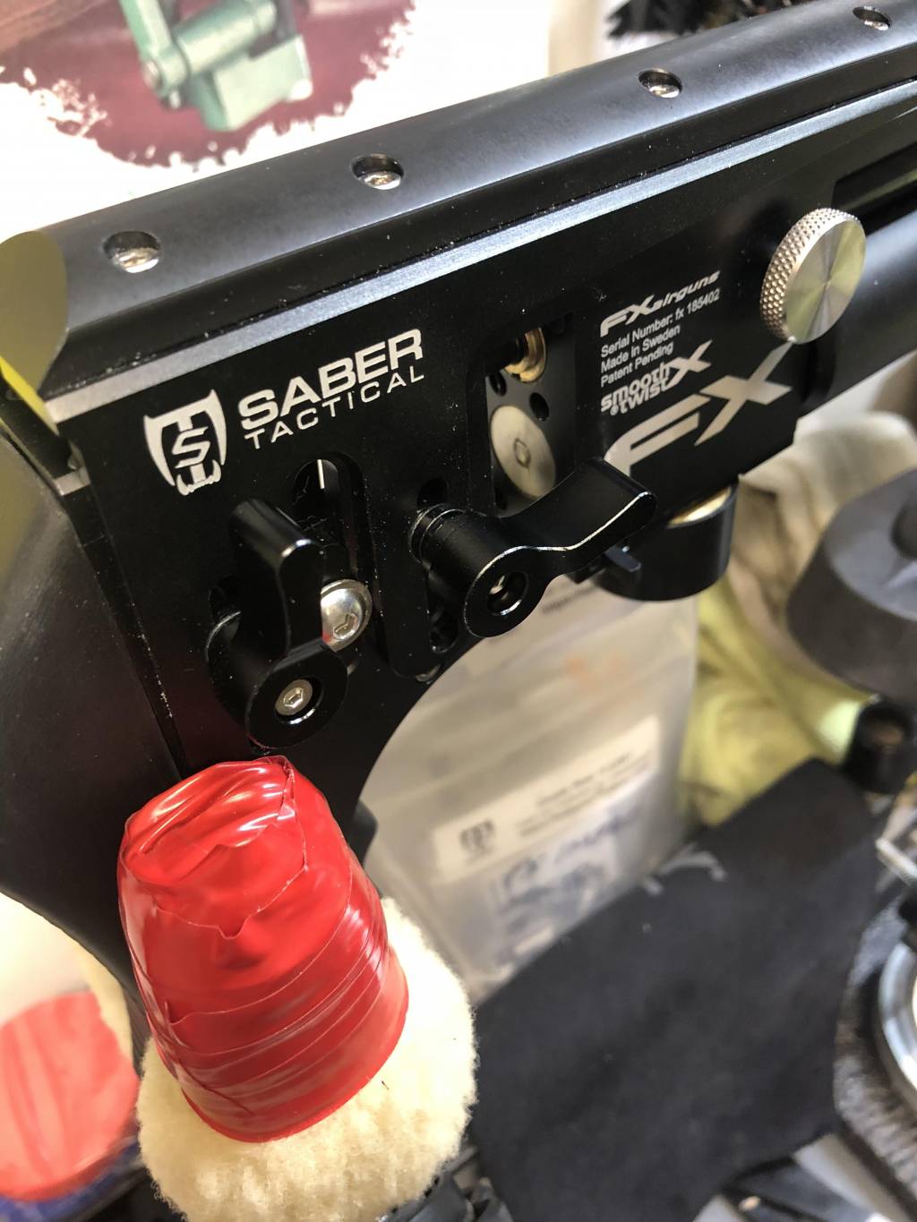

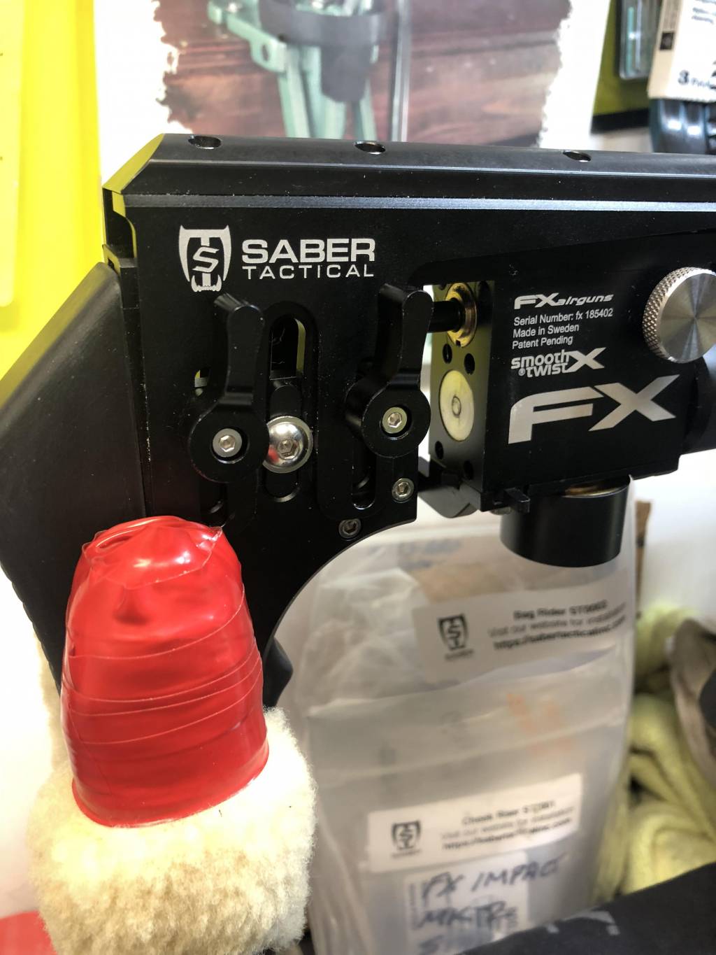

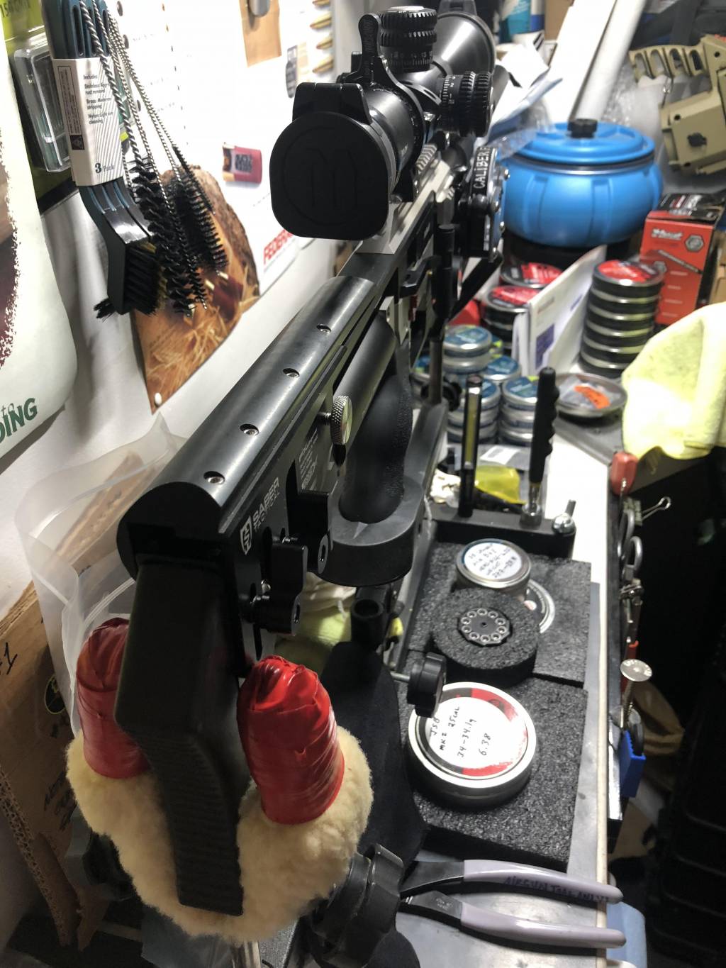

Put these cool, all aluminum anodized thumb bolts in in place of the pan head Allen bolts that come with the Saber Tactical cheek riser. I wanted a tool less adjustable set up should I or someone else would need to re adjust the cheek rest. The original pan heads wouldn’t tighten up enough and the Allen socket was prone to rounding off, and the best thing about these thumb bolts is once tightenened, you pull up on the spring loaded wing, and turn it to orient it anyway you want.

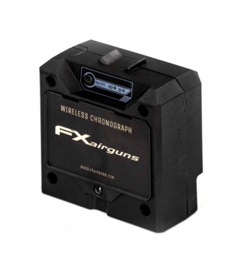

Try rubber band the chrono sideways on your air tube......granted your creation is far more elegant.

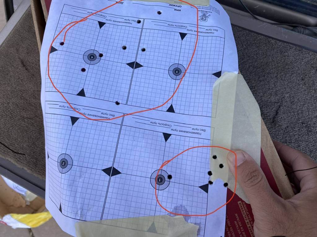

the 26 grain slugs shooting at 960fps is actually pretty descent out of the 700mm .25 superior heavy but thanks to the wind the groups are not good. Then I tried 33 grain slugs and they seem to do pretty well at 860fps, I should of tried to push them a bit faster but next time.

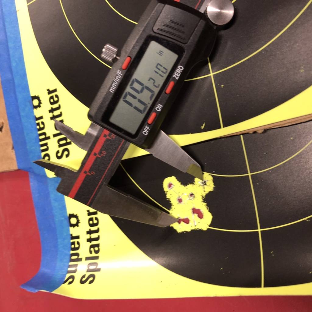

here are two groups at 115 meters or just under 130 yards with 33 grains @860fps. Both groups aim point is the bulls eye, top left was all over the place and the wind even shifted left to right. Then the bottom right group had 5 shots in 1 inch cluster when the wind was consistent then I almost hit dead center when the wind died for a brief moment. Really happy with that one group!!! LOL

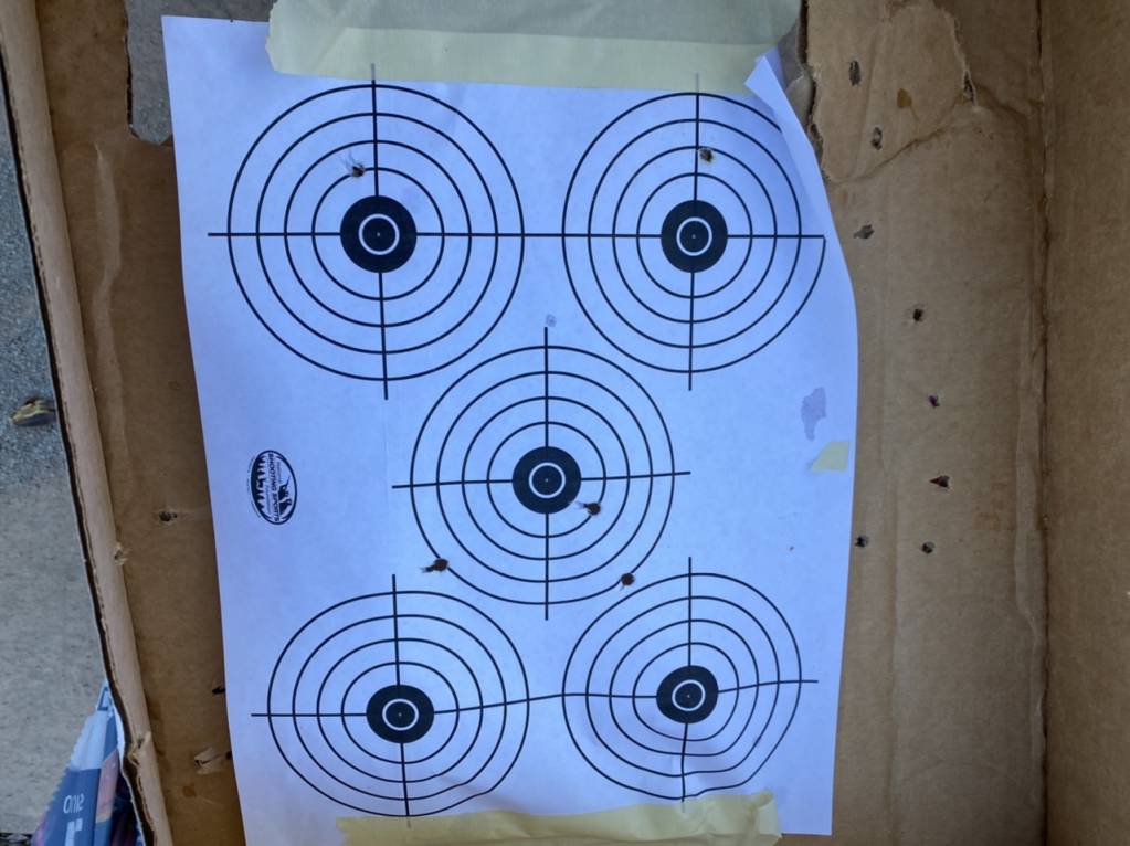

Near the end it started snowing but the wind died down a lot! 1 shot per target at 120 meters or just under 135 yards. Really happy with the results on this one!!! That’s 3 out of 5 squirrels dead! Not sure why the picture uploaded upside down.
so without the erratic wind the 33 grain nsa slugs seems to be really accurate out of superior heavy liner. I really need to get up early and shoot when there is no wind! Btw this is resting the bottle on a cardboard box and sand bag for the grip in my car so it was not steady at all so a lot of is probably me. Also note to self, if going shooting DONOT drink coffee!!!!!!🤬🤦‍♂️
