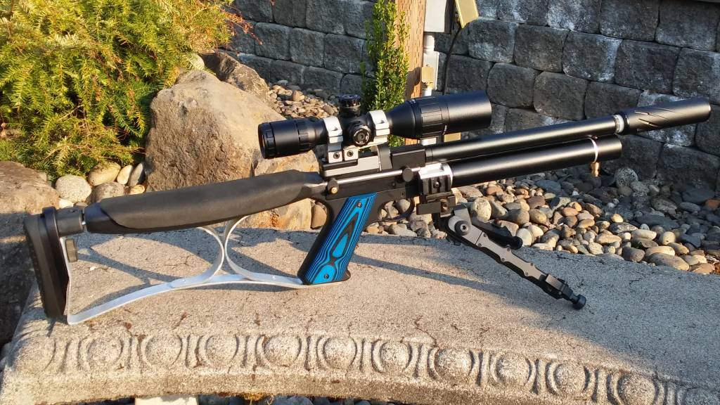

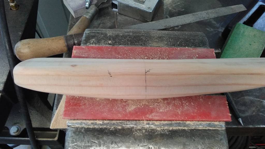

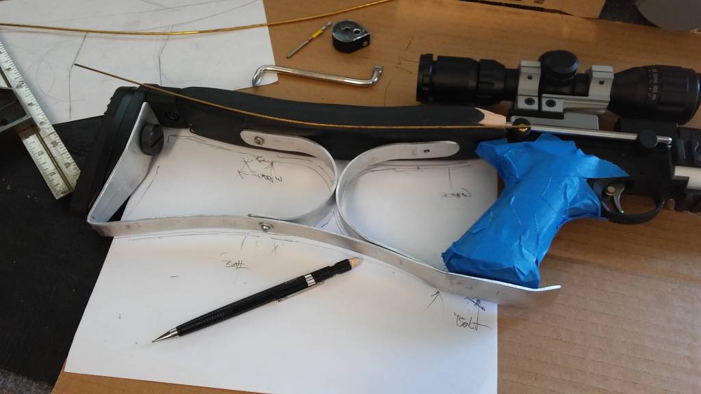

Hope to have this done today so I can try it out , new cheek rest & bag rider for PP750
almost sanded thru the rod guide holes

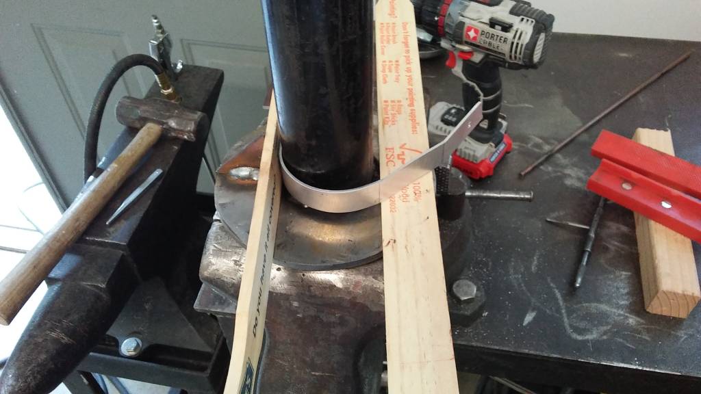

bending my aluminum strip
 bag rider
 forgot the cocking lever spacing on the cheek rest- going back to finish up have a good day !

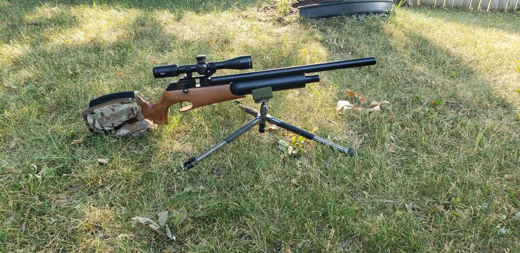

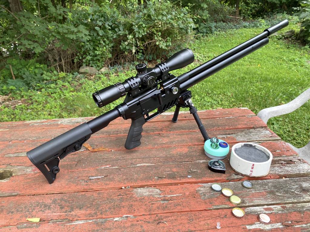

Reconfigure my PP700 back to full time carbine with the new 1.5-8 Barra scope. It’s a bakcyard squirrel CQB weapon!

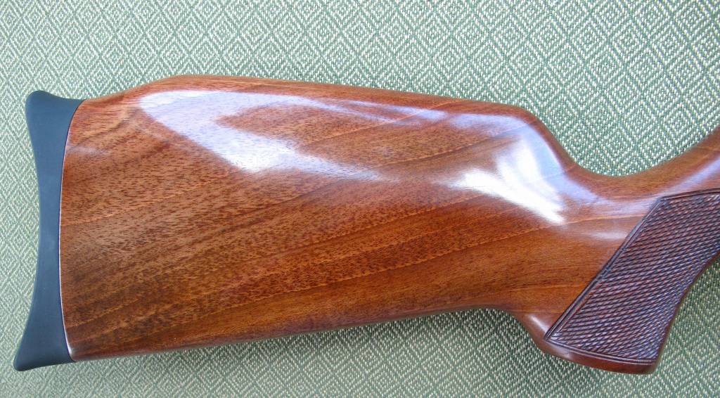

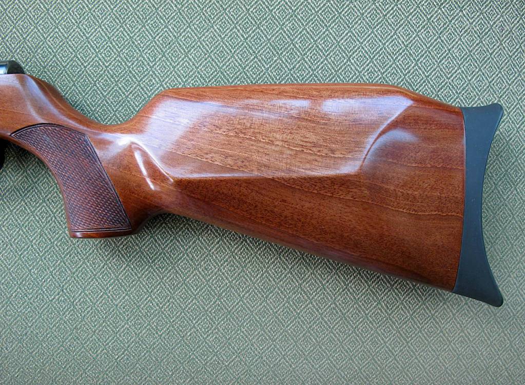

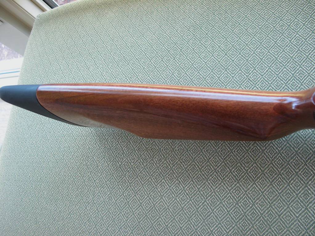

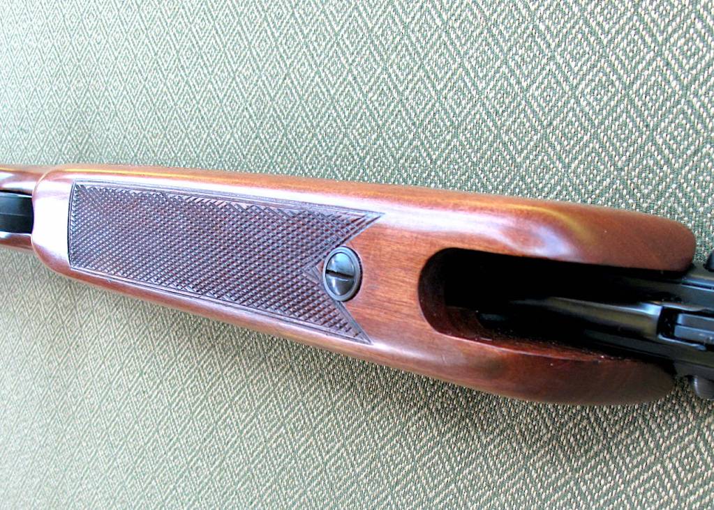

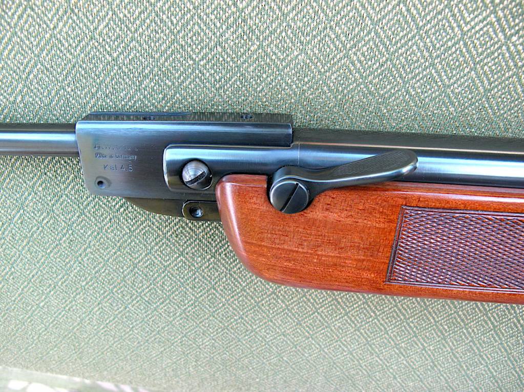

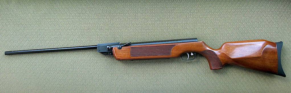

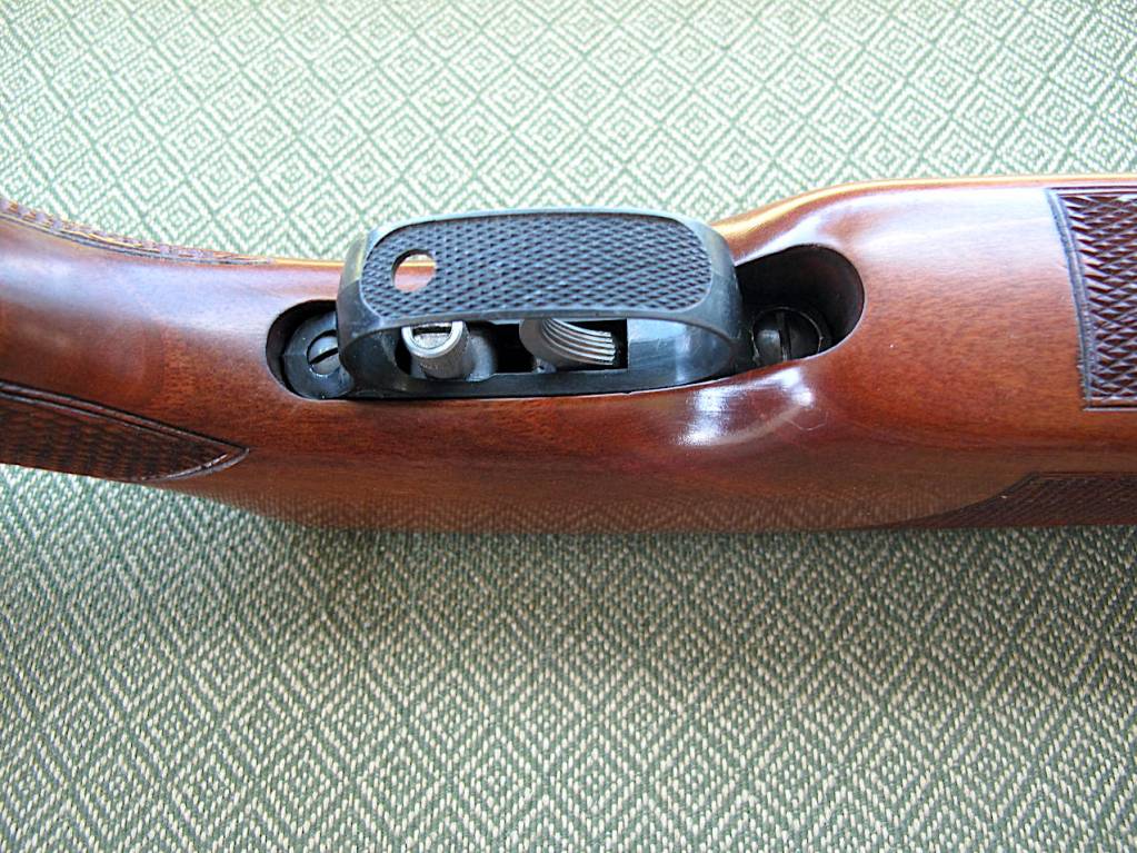

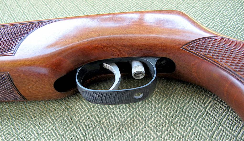

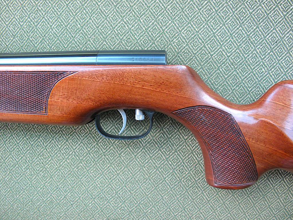

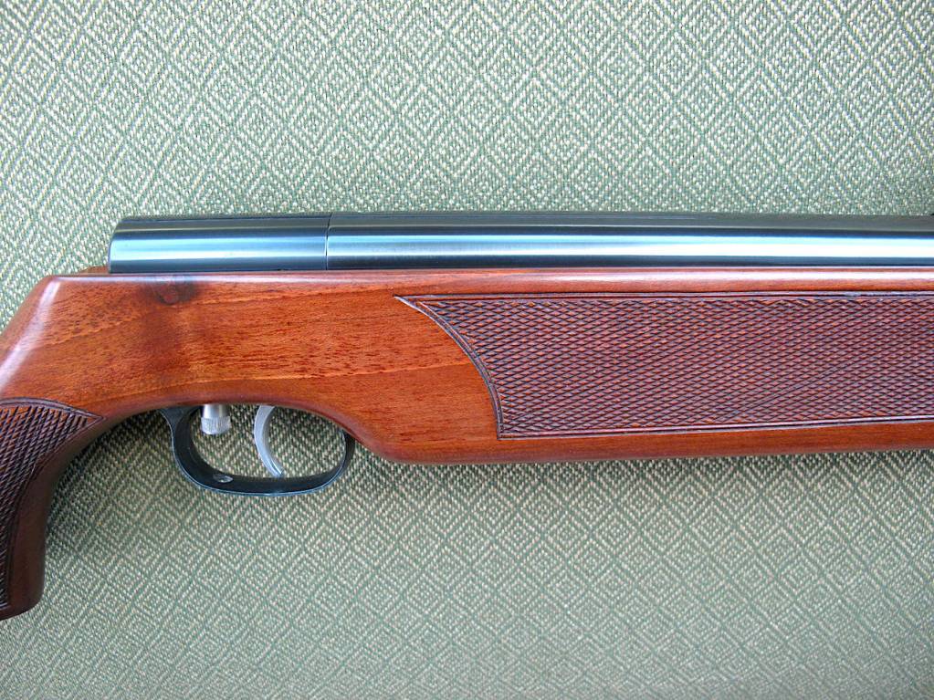

Took some photos of the HW55M I just finished restoring. Re-blued, new leather piston seal from Chambers along with a synthetic breech seal, Maccari spring, etc. It was pretty beat up... but for a gun that is 52 years old...No, that's no excuse for the person that owned it. I seriously do not understand why some people don't take better care of their guns. Any way, I think it turned out pretty well:
Bill
Sir, that HW55 came out great. It looks brand new. I agree with you that their is no excuse for neglecting old guns. That rifle finally got the home it deserves.
Let us know how it shoots!
Thanks for the kind words Moog. Only shot a few pellets but I can tell you for certain that the new Maccari spring has a lot more zip in it than the original spring. I could not get the gun to cock with Maccari's spring guide because it is too thick at the base so I used the original guide. Once I get it broken in I'll give you an update. All I can say right now is that this is a wonderful airgun. All airguns should be made so well.
