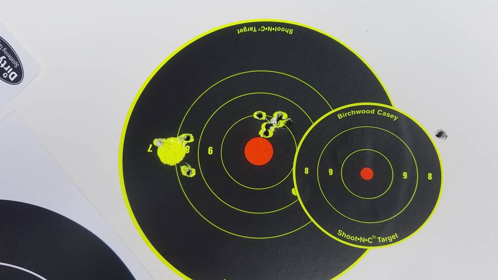

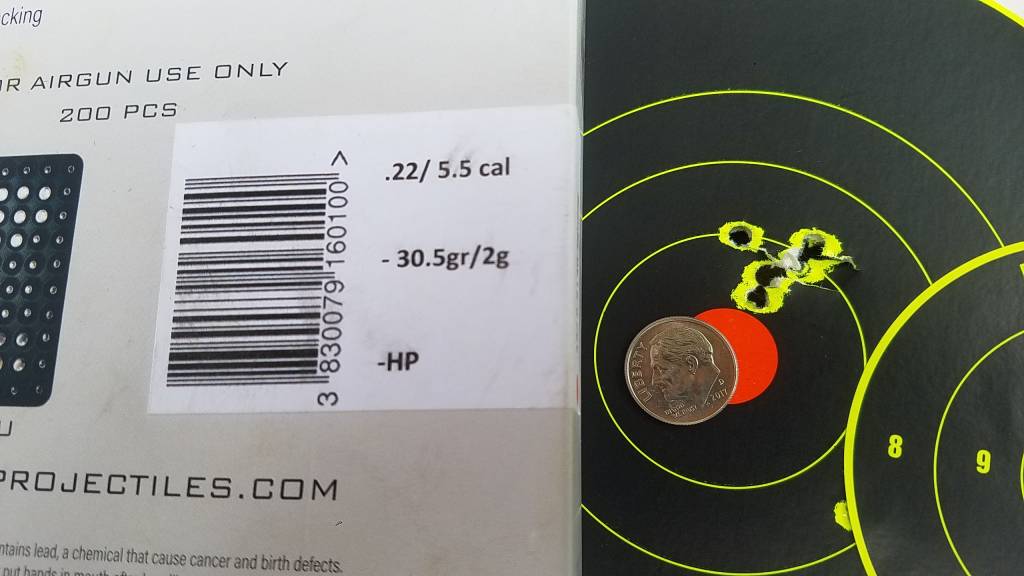

These were ZAN 30.5gr five shot groups out of my M3 at the stock 18.1gr tune at 43 yards today...slugs can group!

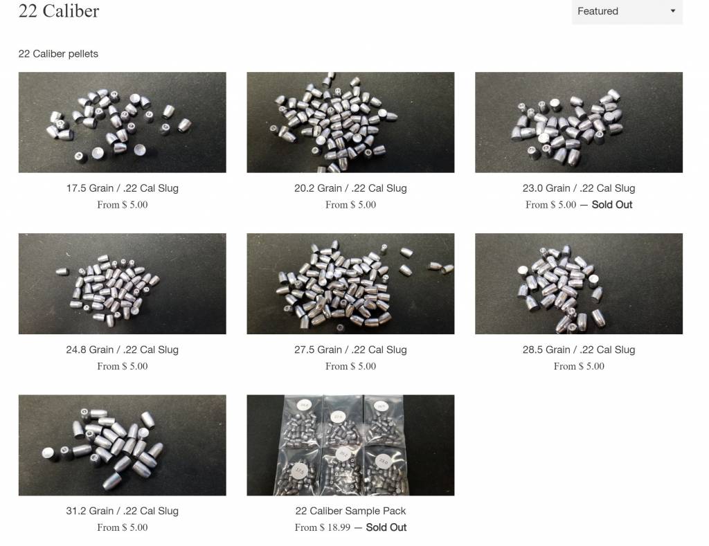

look how cheap these are! (NSA website)
