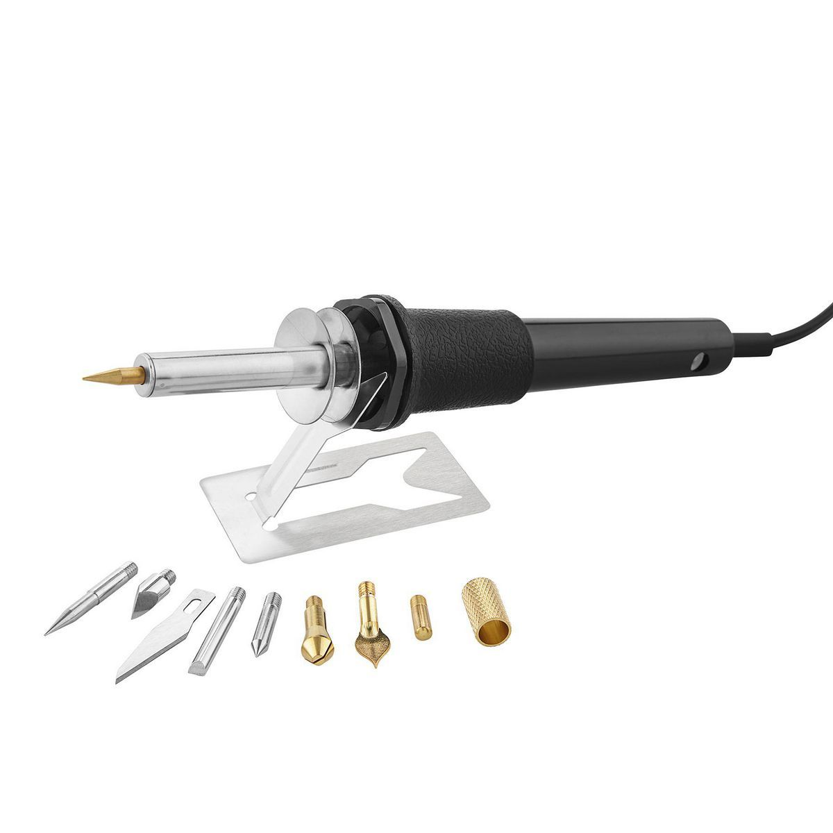

How to adjust your trigger to your liking. If you have seen this video and your trigger still sucks them I'm sorry 😆. The screws on mine had loctite from the factory but I used a soldering gun with a precise tip similar to this on the screw for some heat to break them loose.
You can also heat up a allen wrench or something that fits into the top on the screw to apply heat. Go slow and don't strip any screws. Good luck.
