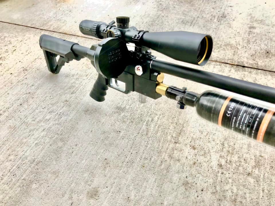

While I don't feel like I have done a whole lot to my gun, I have spent some money to get it to where it is. It looks a whole lot like an FX Crown at this point, which is $1800 on Utah Air right now. I'm not saying they are the same, but I am just giving a point of reference. Here is a picture of my Avenger today.
I'm going to round these off to the nearest $10 so that I can do this from my head and not pull receipts, and also I am not planning on including the DonnyFL, Accu-Tac, or the Element Optics in this as you can use whatever you want, but these are the "essentials" that are part of the gun.
  • $350 Basic Avenger 22cal with synthetic stock
  • $150 Doux Technologies bottle upgrade
  • $100 Plenum Upgrade with tool
  • $75 450CC Aluminum Bottle
  • $50 Custom barrel band from JB3DPD.com
  • $50 DonnyFL Barrel Adapter
  • $50 Carbon fiber tubes to stiffen barrel and O-Rings for Spacers
  • $60 Bottle clamp to Picatinny adapter
  • $10 Replacement 60Duro Rubber Pads for Bottle Clamps to get better grippage
  • $895 Total
Now that I have reduced my regulator pressure down to 2000psi (138bar), and my hammer spring down to two turns in, I would imagine that I will be getting over 100 shots on this thing at 40FPE before I need to refill. I can tweak my hammer spring from 819FPS to 905FPS on my current tune shooting 21.15grain pellets. I don't see what there is not to like about this. At $895, I am at just under 50% the cost of an FX Crown, and I would be REALLY SURPRISED if you can say that an FX Crown will perform twice as good as my Avenger as it is. I guess we will find out at RMAC because I am bringing this gun.
I have a Crosman 2240 sitting right beside my Avenger that easily has $500 in upgrades to it (Not counting the scope), and this is a $60 pistol! This said, I can shoot the UPC code off of a can at 75 yards consistently in 10+MPH cross winds...so it sure isn't performing like a pistol any more.
So what is a "Cheap" gun? What is a mid-range gun? We all know that a "high end" gun has an externally adjustable regulator and hammer spring. The Avenger checks those boxes, while starting life in the "cheap gun" category. Since FX recently started using two regulators, let's rule that out, as well as Daystate's electronic control. We all know that makes them "high end" in today's market, but what does "mid range" mean, and what does it take to push a "budget" gun up to those specifications when you have an externally adjustable regulator and hammer spring??
What are your thoughts? What does it take to transition a gun from "cheap" to "mid" to "high". I believe that the guy that took the EBR Big Bore was using a Benjamin Armada chassis with electronics integrated in, etc. He had a custom barrel, etc. Was that still a "Mid range" gun?

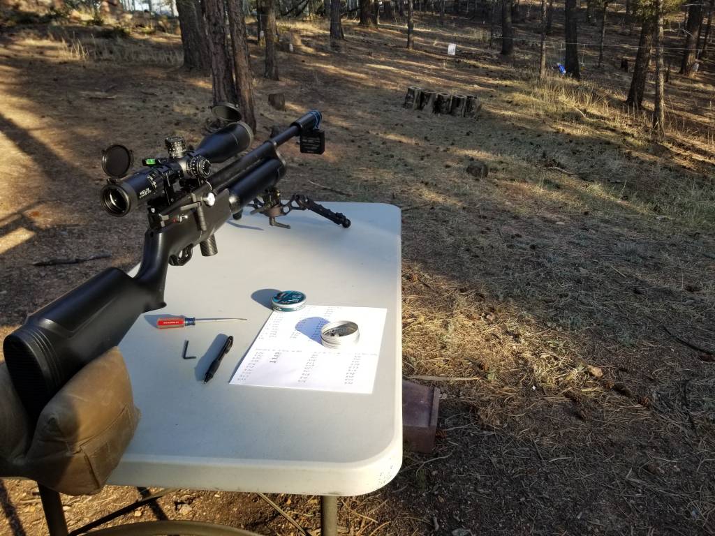

Now it’s time to tell is how it performs at various distances. What it likes and doesn’t like. Is it a bench gun or does it still handle pretty well with that heavy bottle.
I plan on this gun primarily being a bench gun, so I have been pretty liberal with adding weight. It is weighing in at 12.4 pounds right this second, with the bipod and scope attached, so I am over double the stock weight now. Also, when I hydrodip the stock, I am planning on adding 2 pounds of electricians duct seal inside the stock to make it more solid and add some more weight. This will bring me up to about 14.4 pounds if I can get it all in. Right now, the balance is more toward the front with the 450CL Aluminum bottle on there, but the added weight in the stock should help balance it out. Though I am setting it up for benchrest, I plan to use it in Precision and Speed at RMAC. I'll have to verify that the barrel stiffening will allow me to take the bipod off for the standing competitions.
Anyway, I am wanting to keep the power up to around 40FPE, so I am sticking with the heavier pellets (21.14gr, 25.39, etc.)Though I haven't made it out to 100 yards yet, at <75 yards, it keeps coming back to the H&N Baracuda Match in 5.51 diameter head. The 5.52 diameter head in the Baracuda doesn't perform quite a well in grouping, but the velocity is exactly the same as the 5.51diameter heads, so I can use the 5.52diameter for test velocity with. The next best performing pellet is the FX 25.4gr. The JSB Monster Redesigned 25.39gr did OK at 75 yards, but was about a 1.5" group, where the H&N and FX were 0.75" or less. The regular JSB Monsters flew all over the place at below 800FPS, so I wasn't going trans-sonic or anything. Only two of five even hit the box with the targets on it. You could clearly see them sailing all over the place.
The best performing slug that I have found for this barrel is the JSB Knock Out in 0.216 diameter. I haven't tried any Zan, but all of the FX, H&N, JSB, and Patriot were in the mix along with a few NSA, so this was a pretty good test.

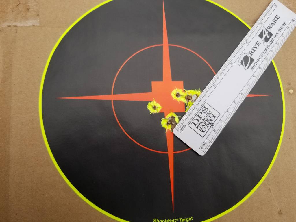

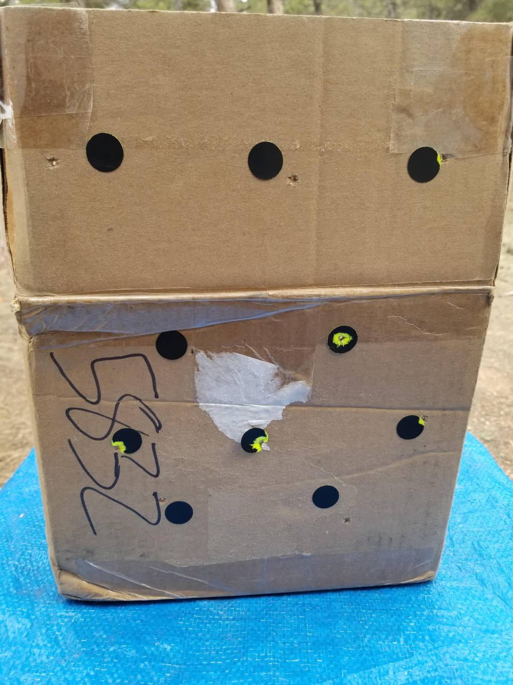

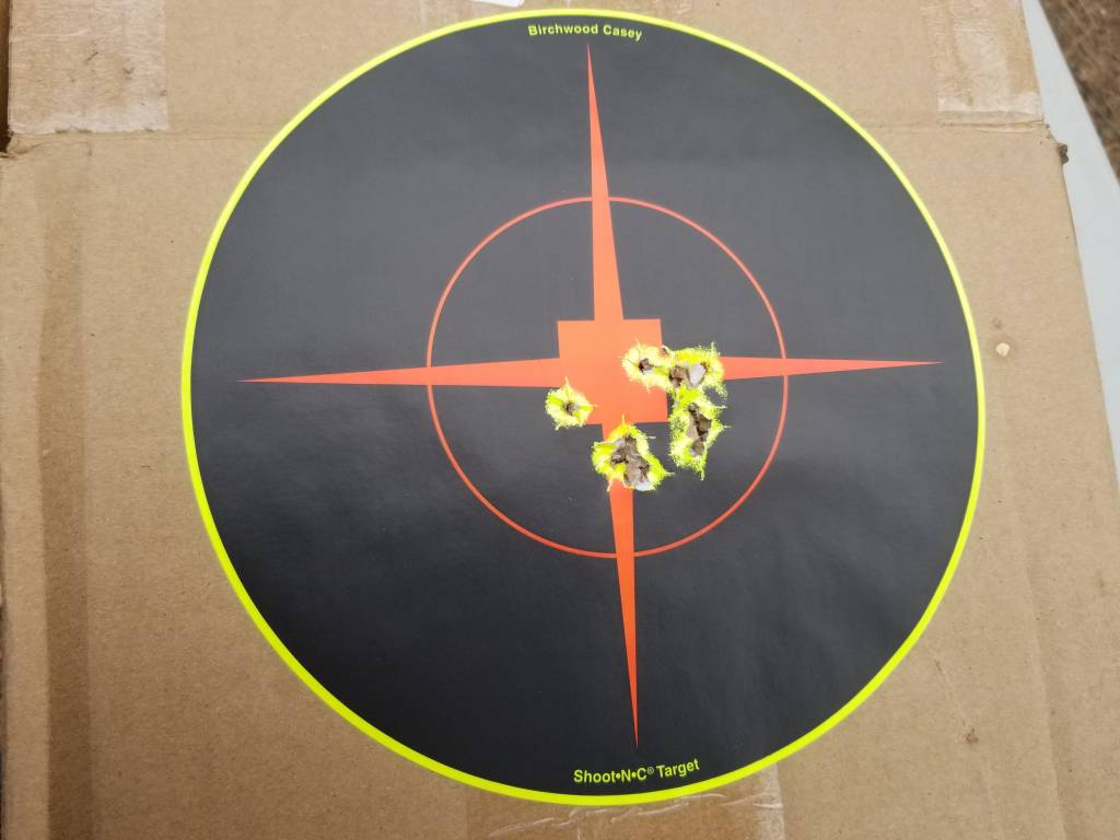

Today was a pretty windy day (12mph sustained with 15+ MPH gusts), and I had to re-zero my scope anyway, so I put a few targets out to 50 yards. I tried a "dirty" ten-dime challenge, and got the results below.
I hit 5 of 10 with one "X". Two "just broke the line", but the shoot-n-see dot turned yellow, so it counts!
I dumped a whole 10-shot mag at a shoot and see target to see how I could read the wind. I sucked, and got a 1.25" to maybe 1.5" group:

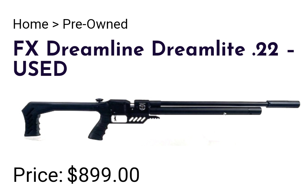

I am just asking you experienced folks.. But rather then creating a $800ish starter rifle.. Would it maybe make more sense on a used Fx with the X barrel..
I see this used FX Dreamline $899.. It can be modded with factory parts.. If I wanted to sell it.. I am guessing it would hold its
Valve OK.. maybe more so then a '' created gun''.
What you ya' ll think..
