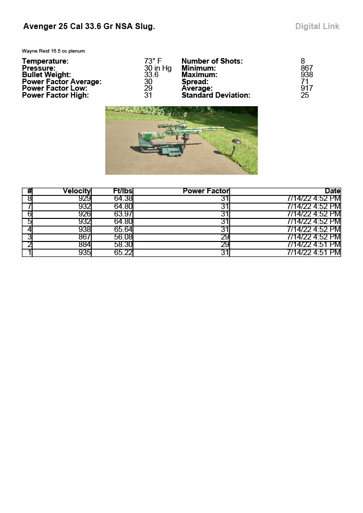

Earlier in this thread i posted chono numbers before i install Wayne Reid's 16.5cc plenum, This is what i got.

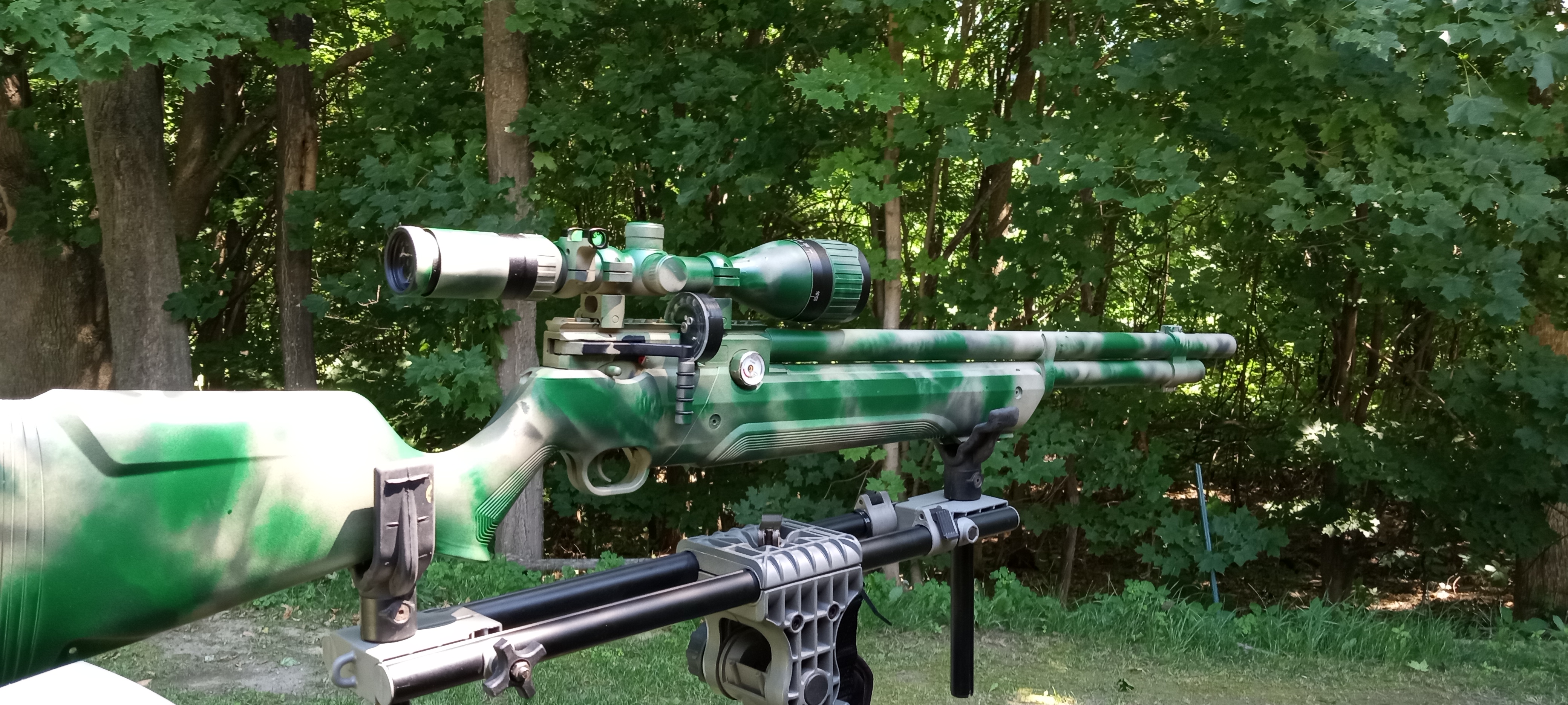

Well guys.. This thread caused me to pick up a like new wood stock Avenger in. 25..the seller said it shot low poi..
I took to the range today.. Leveled and plum bobbed the scope..
Shot it and the pellet hit low I mean so low.. I maxed out the Hawke Sf 30 scope up turret.. Plus I had to hold 5 mil dots to hit the bullseye..
It grouped OK. But man.. So who here has a clue why it could be that far off.. The gun looks flawless.. one of the mags was still wrapped up in plastic. The paperwork said it is 10 months old.

Well, there could be a few things going on here. My biggest suspect is that the Pic rails on the top are off. You can get a pair of Saber Tactical rails like I have that may take care of it. This said, the ST rails don't have any MOA adjustment, which is what you need. Are you shooting at 100+ Yards or so? I had to get some adjustable rings for my Element scope, which I am not sure is the gun or the scope per STKO. Either way, if you get some adjustable rings, or a 20 MOA scope rail, it should take care of it, as long as the POI is consistently low.
The last thing that I would (possibly) suspect would be that the barrel is canted, because remember that the end is floating inside the shroud as OEM. You may be able to just install a DonnyFL moderator adapter for The Avenger to help alleviate this problem. I don't think that you can spin the barrel to index it for The Avenger, but if you can, I would absolutely do that. Sorry for not remembering the specifics about this aspect of my gun 😊. I always mark the index on my barrels when taking my guns apart so that they go back together the same way...so I don't recall if I had to with The Avenger or not.
My experience (though limited) is that the Avenger is consistent. If your POI is changing, check it on a chrono. Your pellets are probably spiraling. Stick to the 850FPS range to make sure that you are consistent and push it up if your pellet (or slug) allows.
I hope that this helps. I have 1000's and 1000's of pellets through my Avenger, and it is VERY solid at this point, but I have the Plenum Upgrade, and Carbon Fiber on the barrel, etc. Shortening the shroud with the DonnyFL adapter so that is snugly surrounds the barrel really helps the fliers...not to mention adding carbon fiber to the barrel.
In short, The Avenger has lots of potential, but I'd recommend looking at some of the mods that we enthusiastics have done. I don't think having a consistently low POI is a problem. Just get your scope to adjust to it.

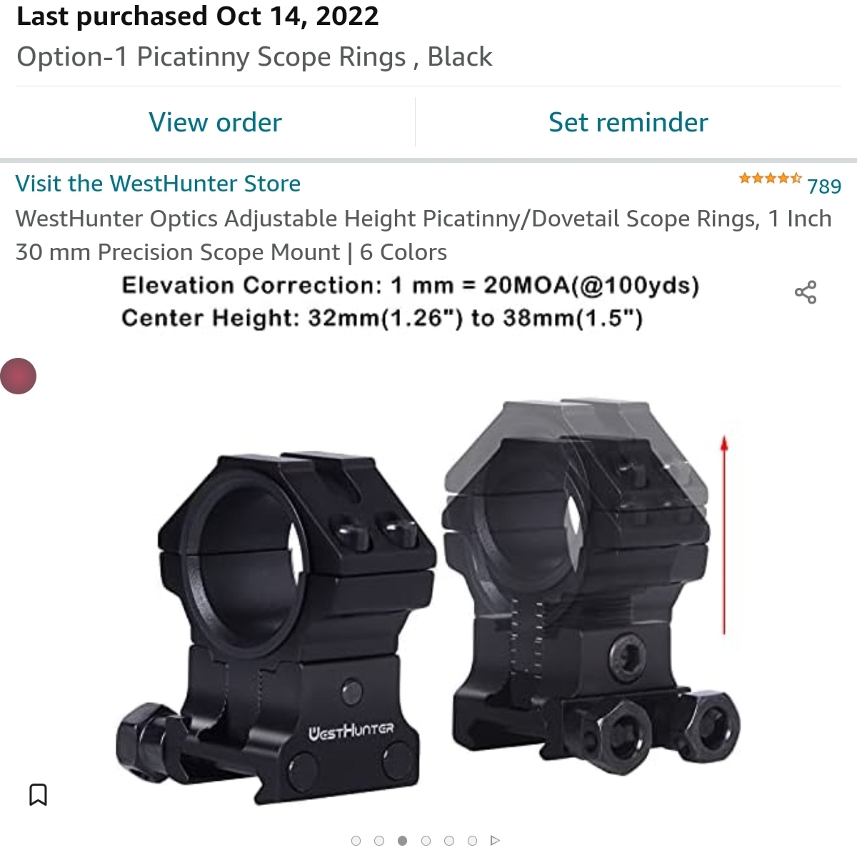

Great thanks so much.. I ordered nice set of adjustable rings today.. 20 Moa I think. I actually received a Donny adapter with the gun. I just didn't have it on today.. At my local range they have a separate air gun range that no one uses during the week..
I had it all to myself today.. I hung a plum Bob to center scopes on a few guns. I set up the chrono as well..
The only thing is that it's a 10 yard range.. So the guns I realigned scopes on. shot quarter to half in groups..
But the Avenger shot maybe 6 inches low.. Maxed
out turret and 5 dots hold over at 10 yards. Crazy.. Would have to point it at the sun to shoot 100 yards... Lol.

I've got the same rings, and they work great out to 100 yards with the rear ring only raised up one "click". This said, my gun never shot that far off.

Got the low POI handled on the Avenger. The adjustable rings got it done.. I have never had a scope issue before so it was all new to me.
After I stepped back and saw the actual barrel Point way down compared to the scope.. The light bulb came on.. Dah
I aimed the barrel by eye.. Took couple shots.. Then used the adjustable rings to solve the problem..
I also removed the 3D barrel band.. The shroud then matched the spacing between the action and the factory barrel band.. I removed the factory (dollar store quality) shroud flimsy plastic baffle.. Replaced it with the Donny adapter that came with the gun.

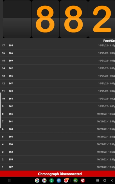

First.. the chrono was set out 12 to 15 feet. When the pellet hit me.. it was extremely light tap. It actually took a second for me to actually figure out what happened.. Cant get much luckier then that..
The Avenger is not in the house for a photo.. The space needed from the height of the rings to that which is needed.. appears to be almost and inch. I will try to reset that next time the gun comes out of the case. (Thanks to 35cal for your photo) AE Swede mag. It looks to be on par for quality to the FX mags I waited a month for and paid 50 bucks a pop for.
The reg thing does not seem to be effecting the FPS readings. 1550psi and 2200psi or any change in accuracy.
Check the photos of my log book and the chrono chart. The change in speed is due from hammer spring adjustments. toward the end of the string anyway.. if anyone spots something.. I would be happy for the input.
I turned in the hammer setting in 1/4 turn at a time. There were only 5 quarters left on adjustment.

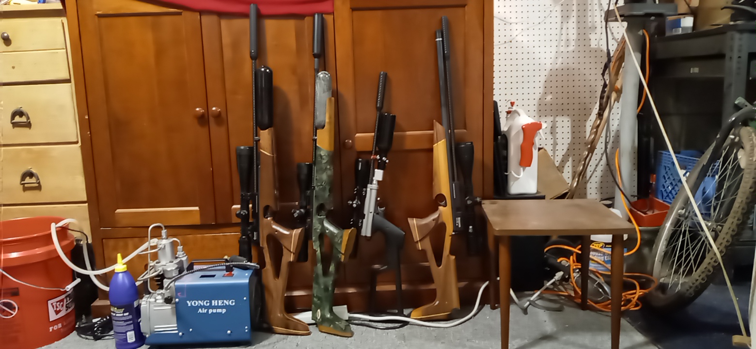

The irony of all this is funny.. When I found this thread.. I only owned some old Hatsans all in 25cal. Since then i bought a same as new FX Dreamline and the same as new wood stock Avenger. I was not happy with my AT44 Hatsan for target groups.
When I modded the AT44 .. a simple addition of a access hole exactly where the Avenger hammer adjust spot is. I tried to adjust the hammer with a 4" allen key (needs a 6") which messed up the adjustment and I had no idea where it was set. My log book showed it shooting at about 885psi from before.
When I chronoed it .. it was hot.. like 1015 down to 965fps hot.. but the drop was in one 9 round mag (needs reg bad). When I got everything sited.. went to the 50y range. That old Hatsan one holed all 5 rounds in nickel sized hole. Out performing the FX 22cal (shooting JSBs 18g) and the 25cal Avenger shooting JSB 25g.. both which shot slightly less tight MOA.. get this.. the AT44 was shooting with Benjamin 27g.. 10$ a tin pellets.
This has me thinking that close to 2000$ for new to me guns and accessories.. might not have been necessary. With that said.. I would do it again..
Be Well All
