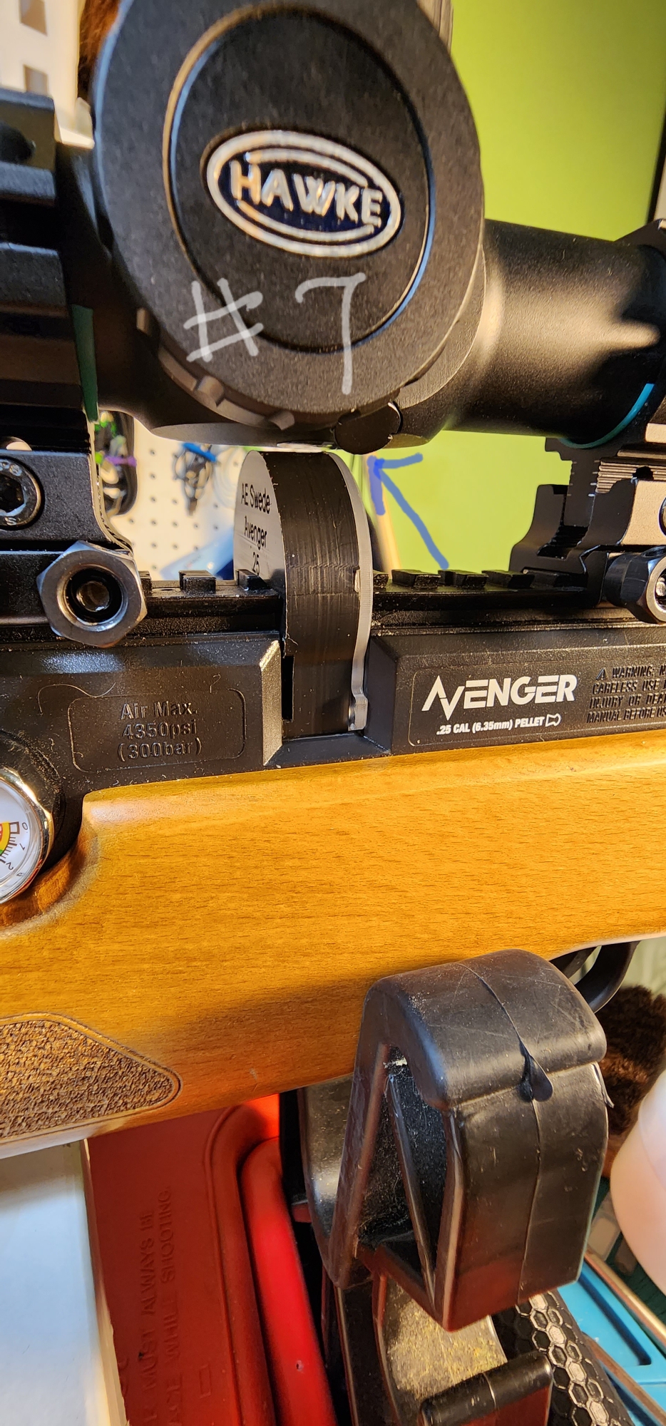

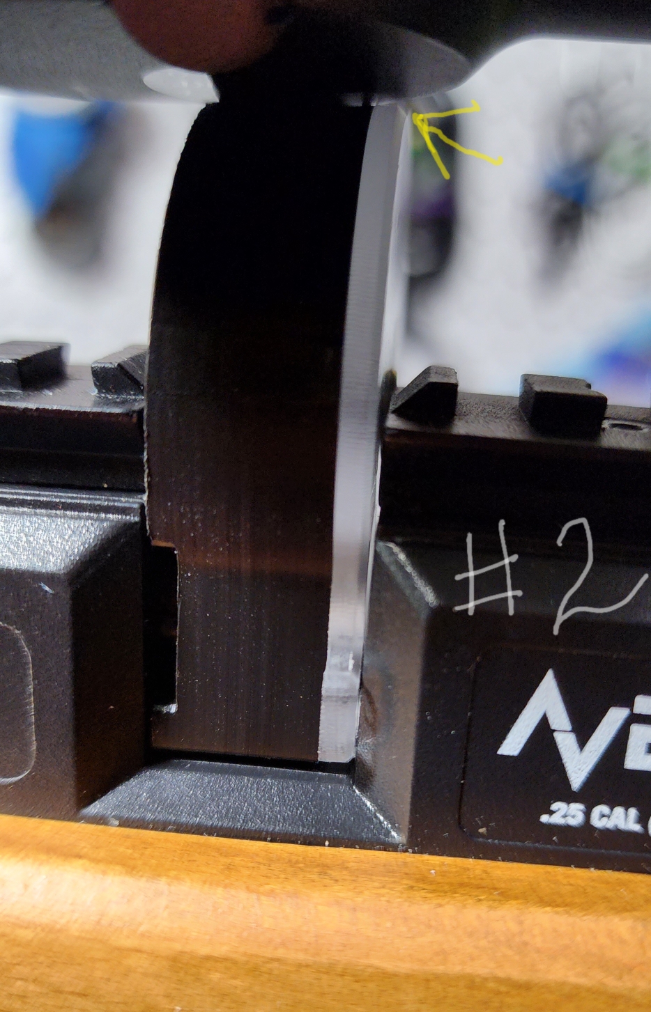

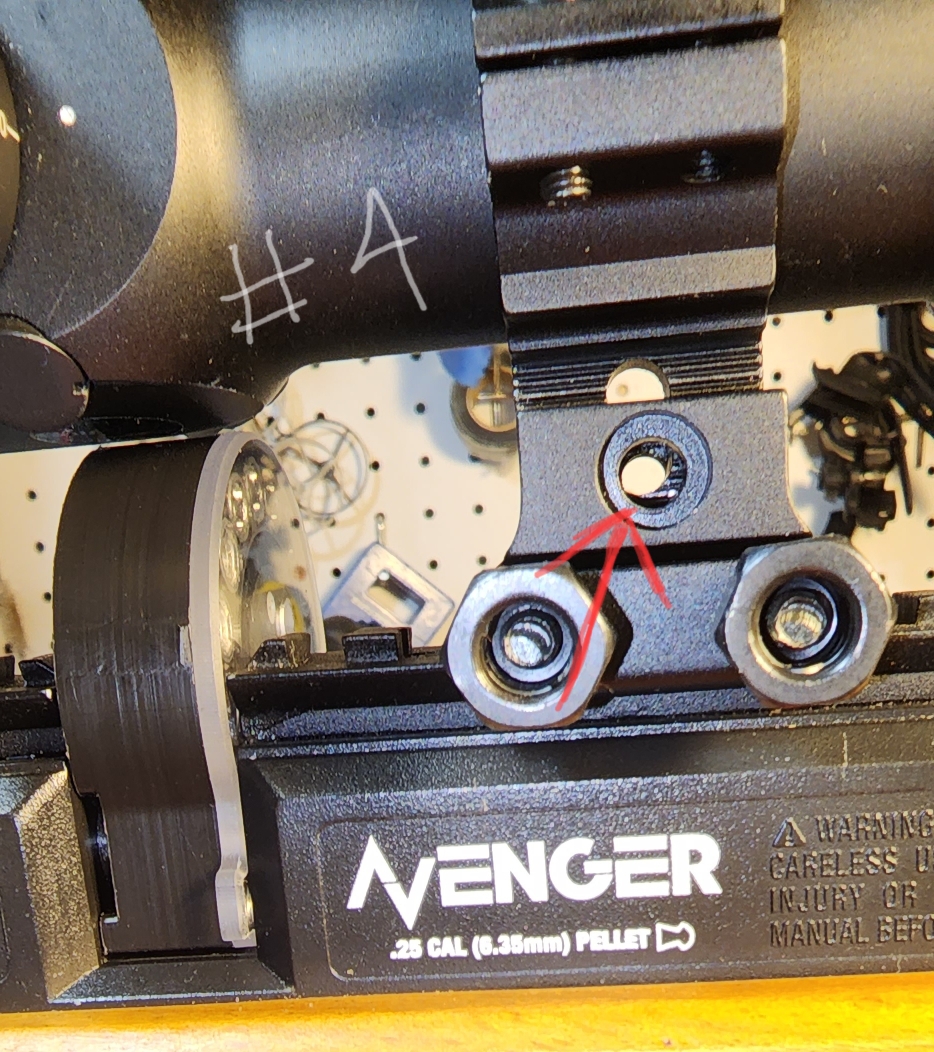

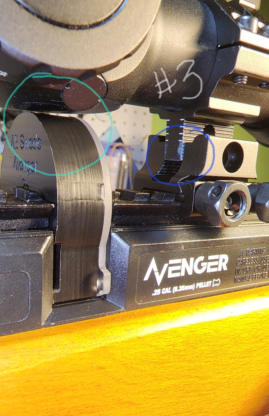

Update on the AE Swede mag and adjustable rings conflict. Even with the adjustable rings maxed out and set at 2 notches higher in the rear to fix the POI.. still now enough the clearance to fit the larger mag..
I ordered a set of rail risers.. the lowest ones they had.. this made clearance room. But the scope was so high that there was no way to use a cheek weld on the stock. So tossed that plan and finally modded the rear ring adjustment lock down by drilling out the screw hole since I had to extend it past its intended limit..
Even with that.. the clearance was so close that the front side ring height was touching the scope.. At this point I had the front scope ring literally held by the back clamp . Grip with Avenger... front Picatinny rail is way to short to accommodate the brand rings I used and the Hawke scope.. At least to adjust my eye relief. I don't like to have my scope bell shape touching a ring..
I ended up moving things around and going against my drathers . So now after all that the AE Swede was still touching the mag. I shopped for some store bought ring shims (just not my style to use cut up pop cans). I am too cheap to pay 20 bucks for a couple strips of plastic.

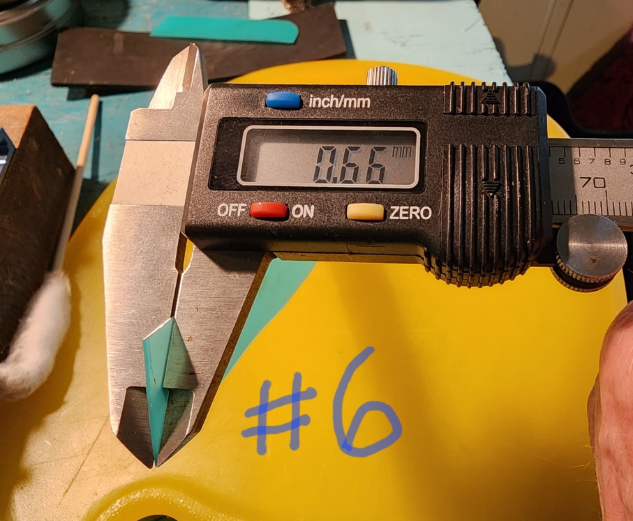

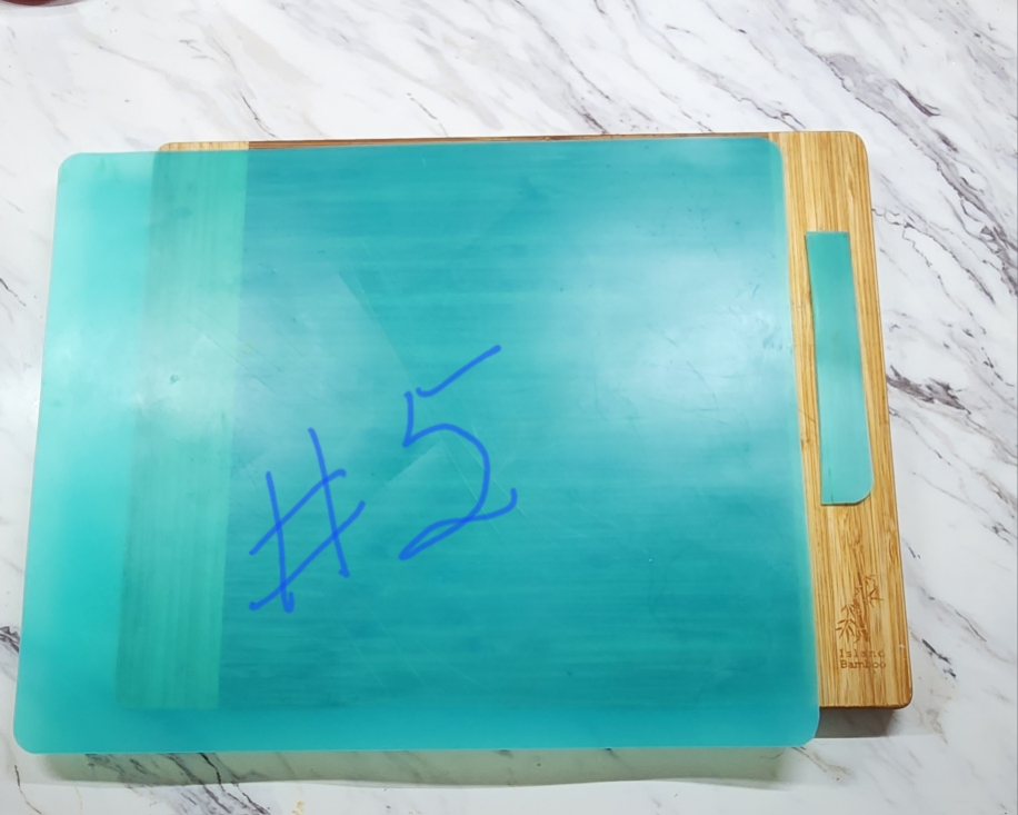

I solved the problem by stealing one of my wife's plastic bread board thin plastic sheets. That I am proud of because.. I cut off a 2cm wide strip. then rounded the corners of the sheet and put it back and she did not notice..smile..
This shim did the trick using basically stuff the store bought use.
So a couple hours of time and a couple days of waiting for rail order to arrive and then not being able to use. I have a working set up.. I think.. I still need to resite and make sure I have enough scope adjust to get ready to go shooting..

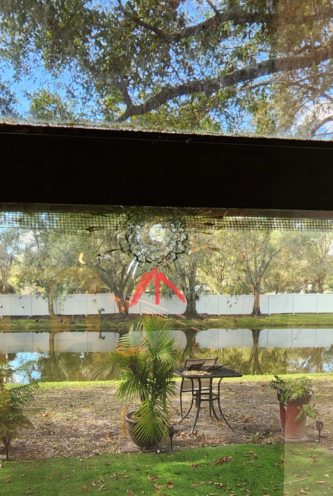

OK thanks.. One of my Hatsan's will double load.. I just fired to clear out with out incident..
When I was trying to fit that that AE Swede
Mag under my scope.. I spaced out that the mag was loaded..
I caught it before it was fired.. I emptied mag and believed I had 2 pellets in the barrel.. I shot it into the dirt and preceeded..
The odd thing occurred as I was still trying to fit the mag under the scope..
The scope was touching on front side of the mag.. However the mag slide in and locked..
So I decided the would dry fire the gun and see if the vibration caused a problem with the fit..
I then decided to add a shim on each ring to get that extra bit of clearance..
I got a phone call and just happen to luck over at the window.. They was a bullet hole in it.. Say what🤔.
The good thing was that window had a small crack maybe from hurricane Ian.. It was scheduled to get replacement anyway..
That's why I asked if one round could stay in the barrel..
I hate it when that happens!! I had a target set up on a box in my office that had catalogs in it to stop the pellets while I was tuning. Well, when I got my Avenger over 40FPE during the plenum install, I ended up blowing through all of the catalogs in no time, and blew about a 1" hole in the siding in the side of my office. Oops!😳 At least it wasn't facing toward anything that I would care about a projectile flying at...like my young daughter's room. The POI would have been at least 20 feet away, but that was close enough for me.
BTW, I thought this was too funny and laughed out loud!
The hole in the side of my office was like this for me. I cleaned it up with calking as soon as I noticed, and my wife painted a few weeks later and didn't notice...or mention it. Now it is all painted and matches. Woo Hoo!
