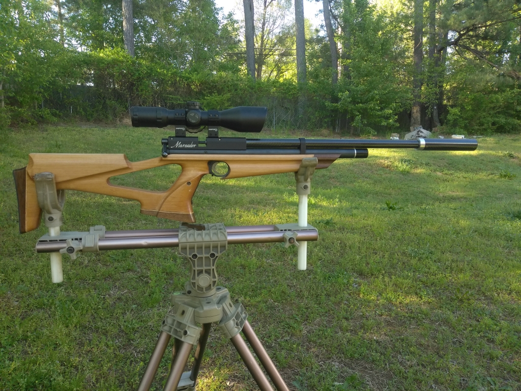

I have a fixed 4x32 bsa essential scope right now. I would like to have something lighter, the gun is already light but having a shoulder issue it would be nice to have it a little lighter. Also want some mil dots. Most of my shooting is 50 yards or less. Im not very familer with scopes I paid 80 for the bsa scope is it a good scope ?
UTG 3-12x44 bug buster

a Mistake I made in pistol scopes=Wrong eye relief for where I had to mount the pistol scope....measure where you want to mount the scope ,then research each pistol scopes eye relief....I have had good luck with the NcStar 2x7x32 modelSPB2732 LONG EYE RELIEF SCOPES...and they go from $40 to$70,,,,hard to beat...

I think you need to specify if you want a pistol scope or a rifle scope. Lots of guys posted pics and info on rifle scopes. I believe from your title that you want a pistol scope because you mentioned shoulder issues. The only pistol scope that I have that has mildots and has the parallax set at 35yrds (very important), is a UTG 2-7. It’s not a featherweight like a Centerpoint or BSA 2x but it does have multiple aiming points.

@Vetmx I was thinking something similar. In reading up on which is better to use, I’m curious as to which is would be more desirable. Another thing I was wondering about is, how important is parallax when shooting air pistols? Should someone new to pistol scopes expect to encounter the bulk of pistol scopes (save reflex optics) to have adjustable parallax? I’m thinking answers to these questions depend upon how the pistol is used so I’d like to specify that I’m asking regarding using an air pistol strictly as a pistol. If a shooter decides to go back-and-forth between pistol and carbine configurations, which type of scope would then be optimal in your opinion?
