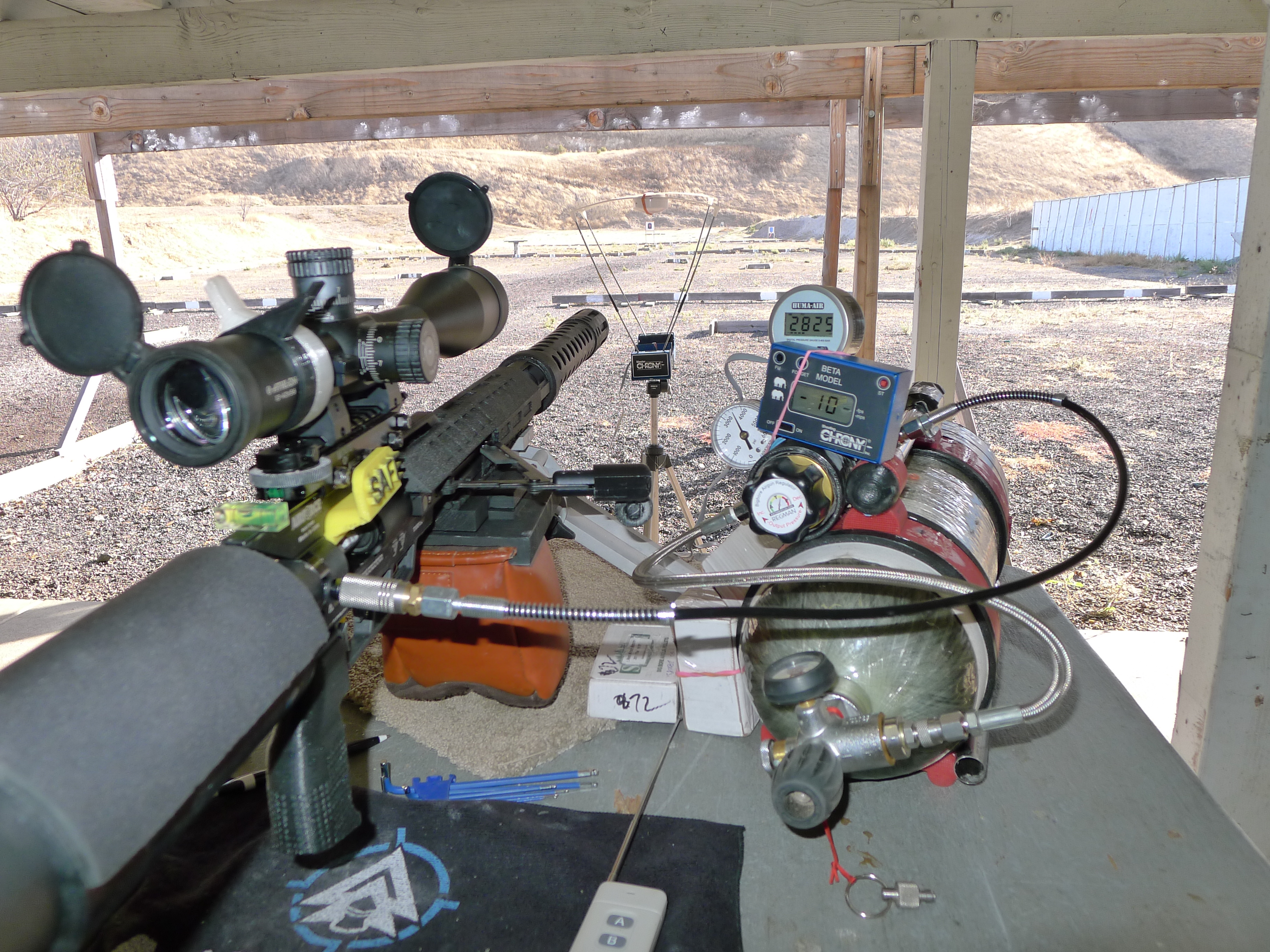

I already have the Texan .257 LSS and FX Impact M3 .25 cal. I shoot all day long at 200 and 250 yards with both at 2 inch MOA.
My club range has a 30 cal limit. I'm wondering what .25 to .308 cal pcp will shoot more accurately at 200-250 yards and even beyond 300 yards?
I am eliminating all FX guns as well as the Texan .308 cal. If you can keep "on topic" I would like to hear from you. I would consider selling all my pcp airguns and only have 1 dedicated "long range" gun. What would it be?
Remember 25 to 308 cal max.

For 300yds with an airgun, a .257 shooting 70gr to 75gr slugs at 950fps to 1020fps from a 1:14 barrel is going to be near the top for accuracy. My .257 did best at 300yds shooting the 257420 BT at 980-990fps. A BC of at least 0.150 is good enough for 300yds. Higher BC is always better but they are usually harder to launch accurately at a decent velocity (heavier hammer strike, more air blast, more recoil).
I wanted higher fpe, so I did a rebarrel in 7mm (.284). Higher BC and more energy, but not quite as accurate as the .257.
Not a lot of factory .257 airguns available, and no 7mm. For those that want an off the shelf solution, the .257 Texan would be my recommendation for a long range airgun. And you already have that.

Thank, but I shoot tethered. So a bigger bottle wont help when I benchrest.
Not many choices. Texans have there faults but are the most powerful with heavy slugs. There is sort of cool pcp like the Vulcan3 from Urgan . Slings moderate weight slugs with grace. Less power more ease of shooting. I'd put a regular stock on your Texan. The ultimate30 cal is the Texan with African Air Ordinance Value. It will sling the 230 grain high b.c lee mold .6 B.C at around 900-1000fps. Might be better with custom 30 cal 8 twist barrel. .6 bc at 1000 fps is tops for airgun ballistic for now... I think....
