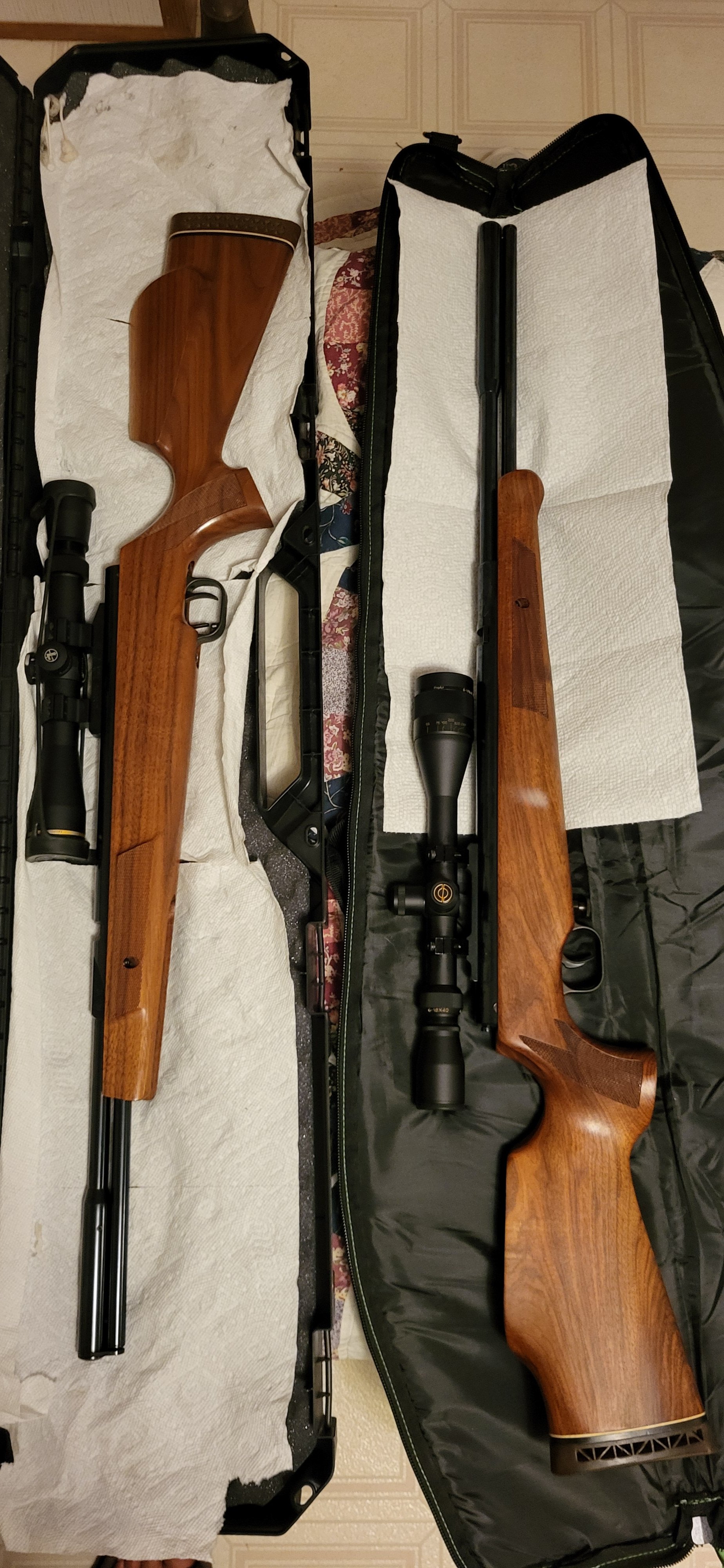

#1 HW97 #2 TX200 #3 HW 77 I have and shoot all three , for me the 97 is easiest loading , TX is next and i find they both are Equall and the 77 long is a bit heavier .
I like underlevers as the barrel does not move .

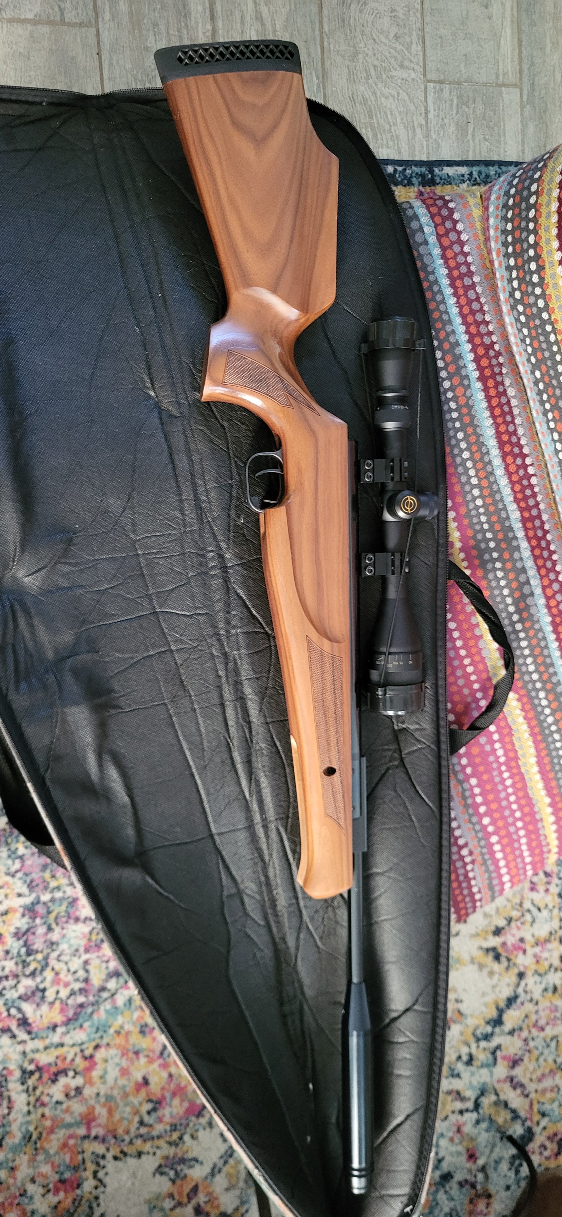

I have a HW90 piston break barrel. It is accurate, powerful, and can be left cocked for a long time without any degradation in power. It has a great trigger and is relatively quiet with the HW suppressor. The power is adjustable by regulating the air pressure in the piston. I have mine at 18psi and that is great for the ty[e of shooting I do.

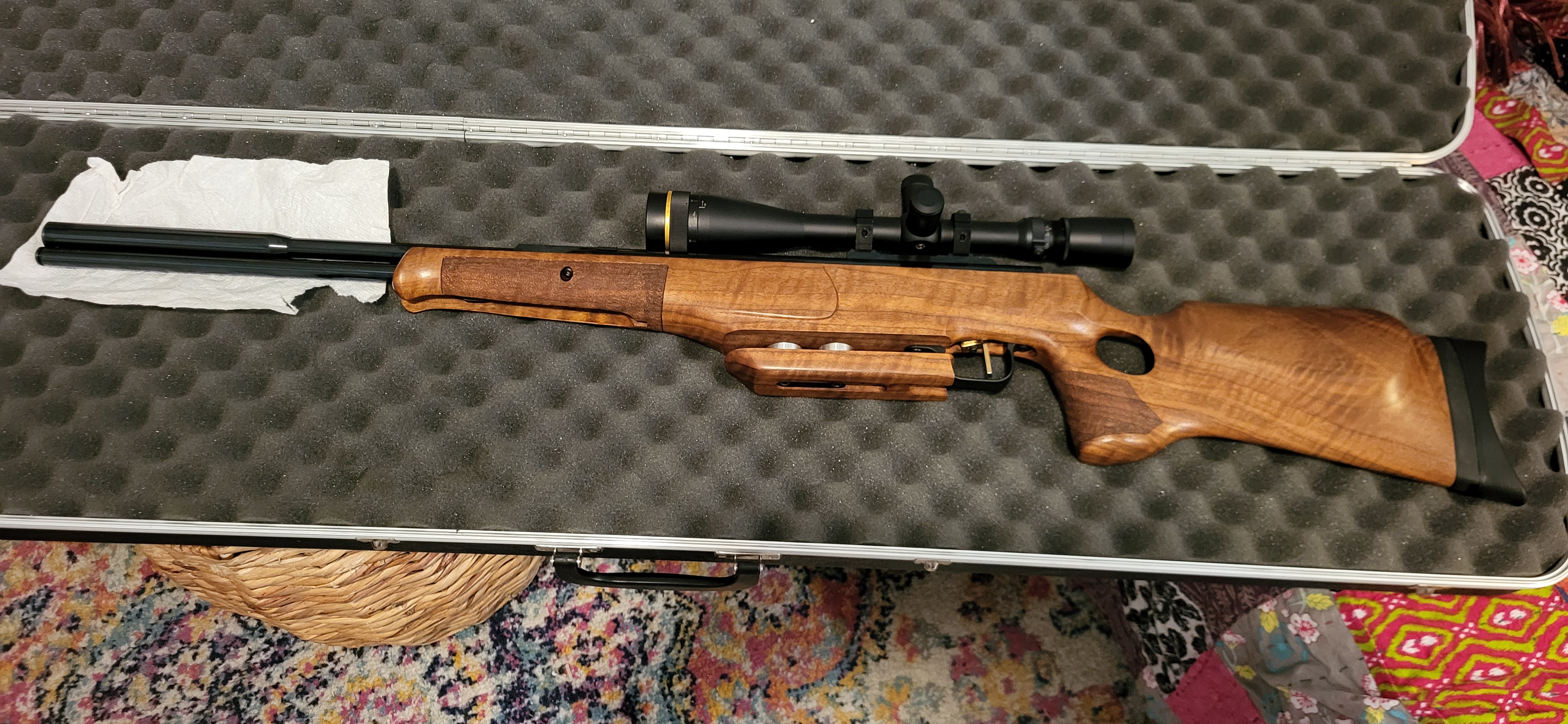

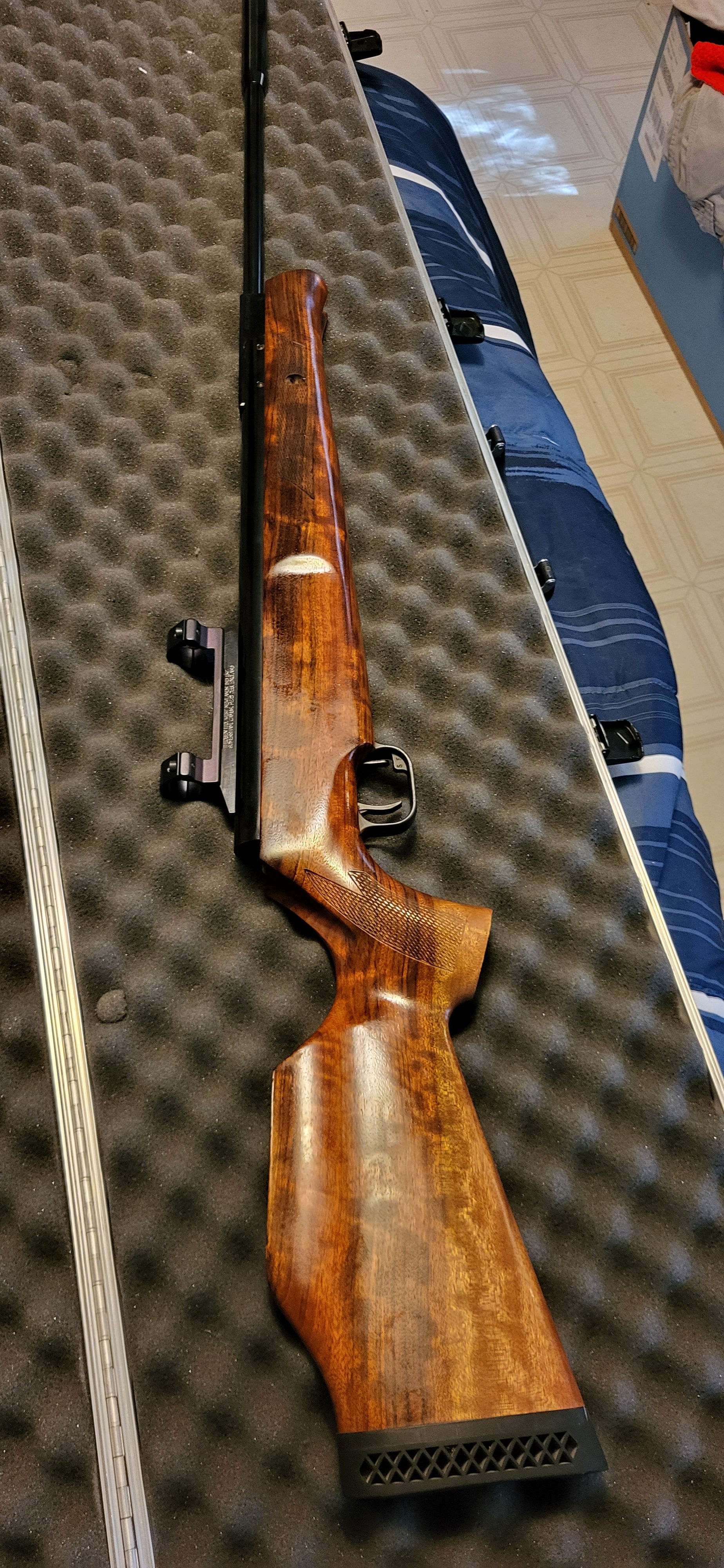

A "Really nice" springer? What comes to mind...cost not withstanding...with in reason...A few examples...If you HW (Weihrauch) the world HW's with you, (nothin' wrong with them) But when you Theoben you Theoben alone!!!

Its already been said so I wont mention the Theobens but dang are they beautiful. Same issue though discontinued.

There is no need to change the pressure in the HW90, for its 33 J it shoots perfectly. There is no other rifle on the market that is as powerful and accurate. The Theoben spring will always warm your heart.

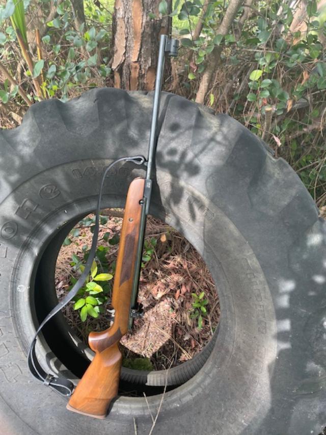

I have a Beeman R9(HW95) in .22, which is my primary hunting airgun. With a good scope you are still in the 8lb range. I also have an HW50S Hunter with moderator in .177, and I have taken squirrels with that one too. Very accurate, and with scope in the 7lb range. Then I have a Beeman R7(HW30S), in .177 and as others have said it is just delightful to shoot. It is easy to burn through a tin of pellets because it is so easy to cock. It is the smaller of the three, but it fits me really well. The R7 can take birds/rats out to 25yrds, but it lacks the energy at that range for tough critters like squirrels. The good thing about the German Weihrauch made Beemans and HWs is that they are still being made and there are plenty of parts available.

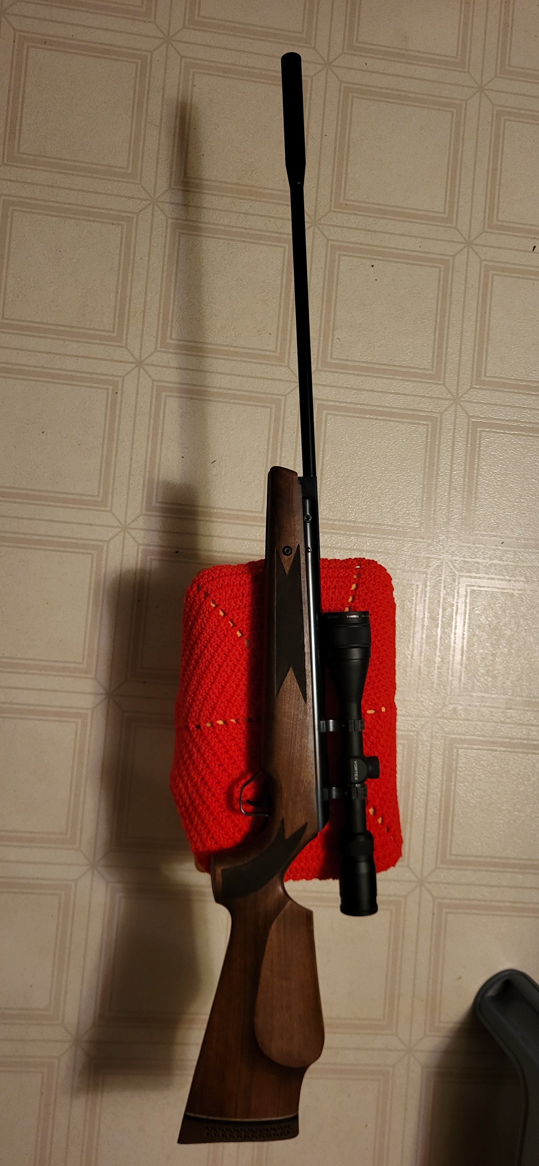

I have a 20 cal Hw98, 20 cal R9, 22 Hw95 and a 177 Hw95. The 98 is a fair bit heavier than the others and not enough more accurate to make me want to carry it. Truth be told, the only Weihrauch I carry anywhere is my 177 Hw50. It's truly a great handling rifle with just enough power for my skills. It just points and shoots beautifully.
