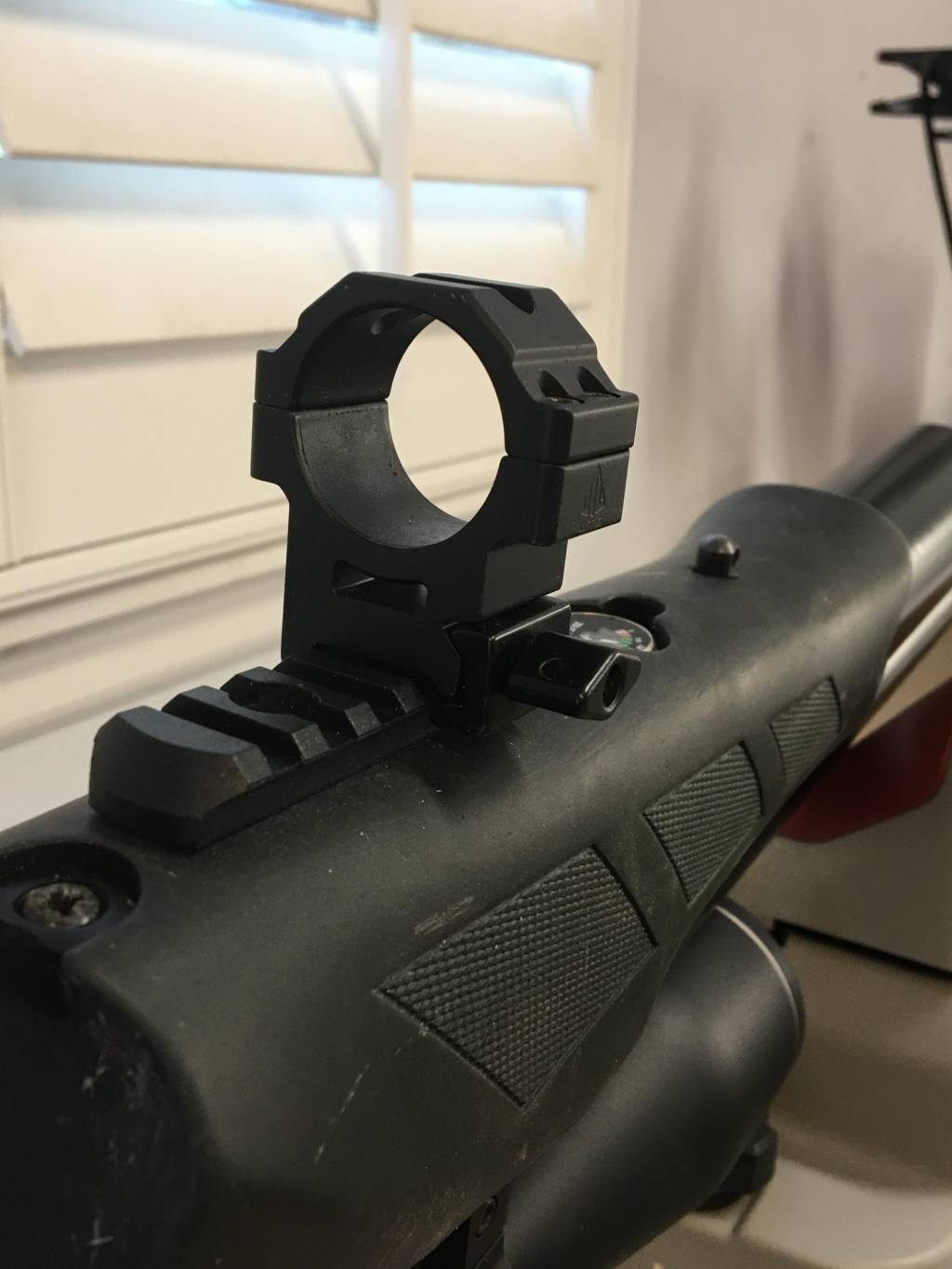

The forestock on my BSA R10 doesn’t have adequate depth for me to form the ideal human triangle. I realized I was not going to be able to grow my arm up to meet the stock so I decided to bring the stock to my arm. I considered a couple of the commercially available ones but being the cheapskate I am, I opted to fabricate one myself.

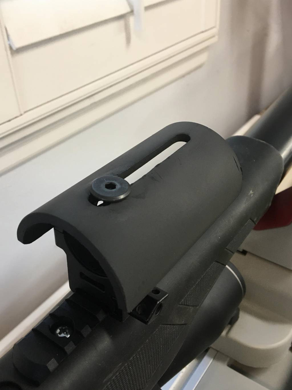

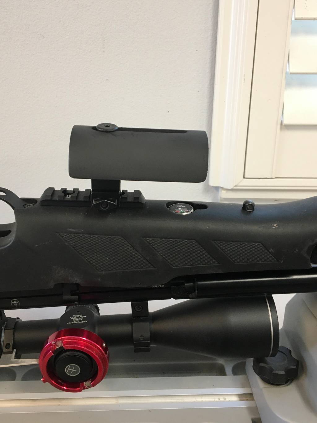

I attached a short picatinny rail to the forestock and attached a spare UTG scope mount which just happens to have the same outer radius as the I.D. of a piece of 2” PVC I had laying around. I steered away from a simple block of wood for a palm rest as I tried that on a previous gun a couple of years ago. I never could get a repeatable hold on it. The curvature of the PVC is just a more natural feel to the cup of my hand. After a $1.87 trip to the local hardware store and voila! Sprayed it with primer and going to wrap it in some faux CF tape to give it some pizzazz.
Maybe not what the kool kidz do but preliminary testing demonstrated improvement.
Oh, and it is under 6” from bottom to center of the barrel. Just barely…
