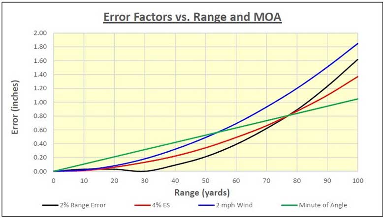

Those are 3 very independent subjects that are ALL important for different reasons.
BC of a pellet: higher the BC the better it resist the wind, this exponentially more important as distance increases. Obviously the 10 meter indoor crowd couldn't care less.
Speed of a pellet: not really that important until the pellet becomes destabilized by transonic turbulences, usually safe to stay under 900fps for more traditional pellets and a little higher for more slug looking pellets but staying under 900fps is always a safer bet
Barrel choice: barrel to ammo combo is most important foundational requirement or no accuracy for you!
