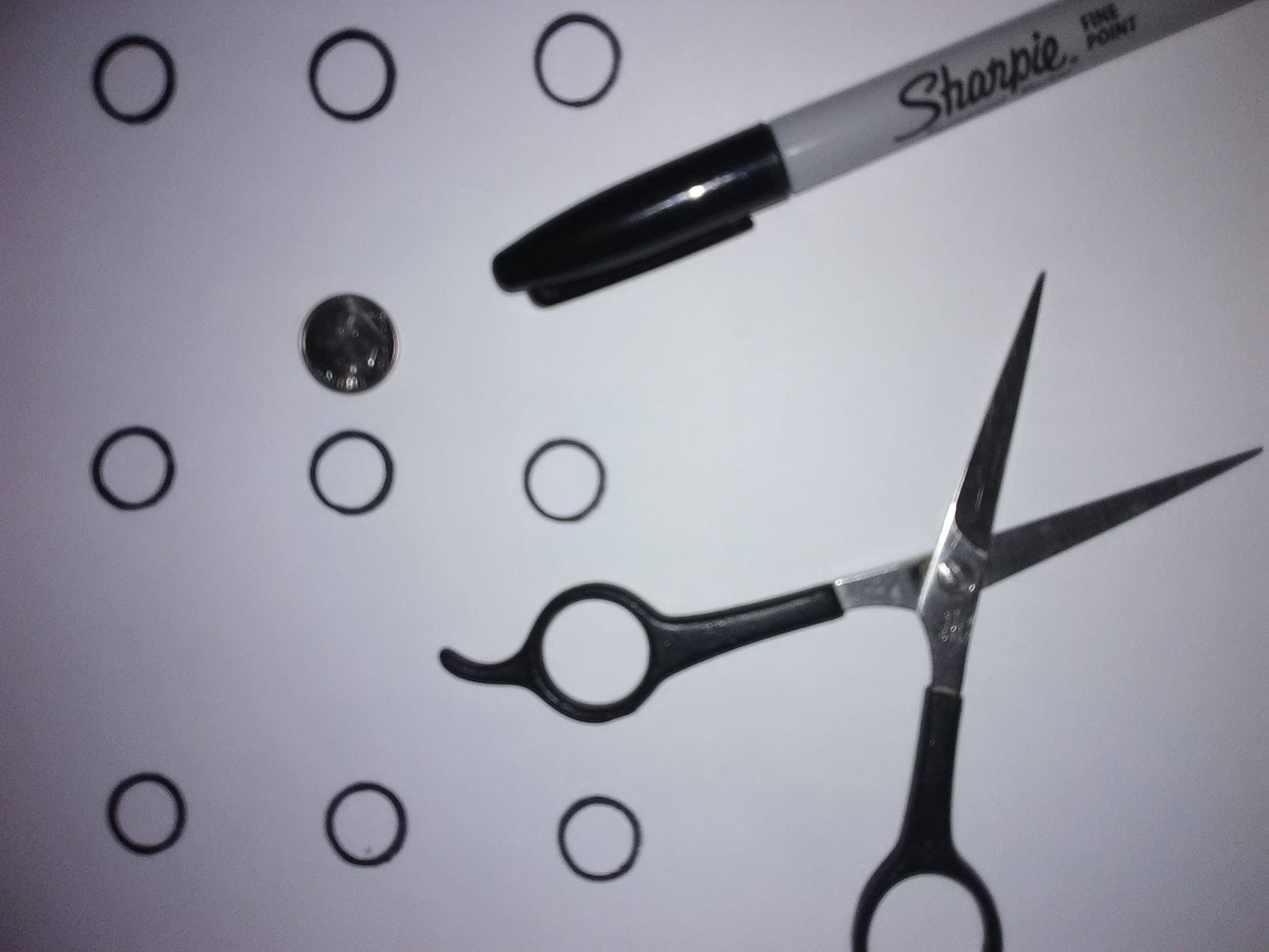

Only shoot pellets, mostly JSB, in .22, .25 and .30. My 50-yard target is a white sheet, marked with slightly smaller than dime-size circles, made using inner ring of barber scissors and a black sharpie. If my PCP and I can't hit inside six circles in a row, we don't go hunting. All my PCPs laugh at this challenge, myself, not so much. WM
