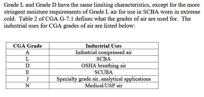

If you are having your tanks filled at a dive shop, you are most certainly getting Grade L air.
For breathing air, Grade D air must provided and meet the following requirements :
Have an oxygen content of 19.5% - 23.5%;
Have hydrocarbon content of 5 milligrams per cubic meter or less;
Contain carbon monoxide (CO) content of 10 parts per million (ppm) or less;
Have a carbon dioxide (CO2) content of 1,000 ppm or less;
And have a lack of noticeable odor.
However, Grade L used for SCBAs requires the additional moisture requirement of 24 ppm or less to prevent freezing of moisture content.
So, by using dive shop air, freezing and moisture should not present a problem.
