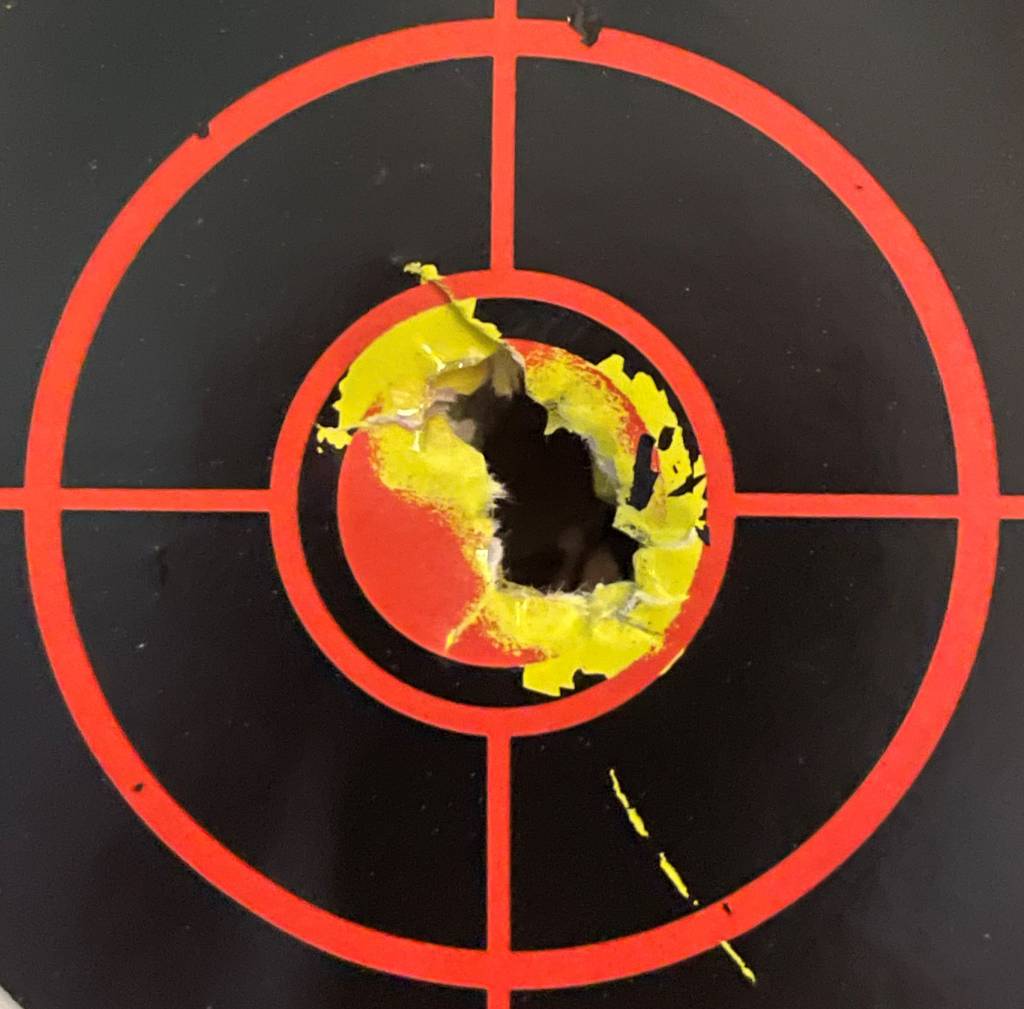

The 97 has a PG4 12lbs kit and Rowan straight trigger blade. I just added a SWFA 12x scope in BKL mounts and at the 25 yard indoor range accuracy was easy to achieve while rested at 25 yards.
HW97 .20 JSB 13.73 grs, 6 shots.

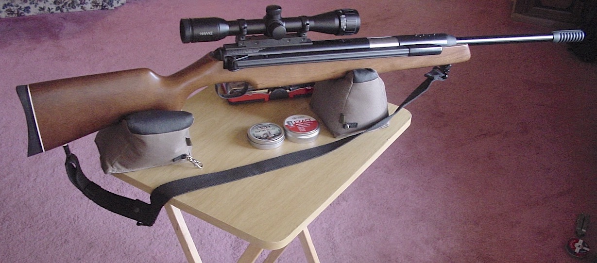

My least hold-sensitive springer is also my heaviest, the .177 Diana 48. It's a heavy rifle to begin with, and I added the all steel adjustable RWS "C" mount, and an old Dianawerk steel muzzle weight. Weighs in at around 11.5 lbs as pictured. I don't mind a heavy rifle, so it works for me. The ease of installing a sling is a plus, as it needs it.
Looks like a squirrel population control hammer.
