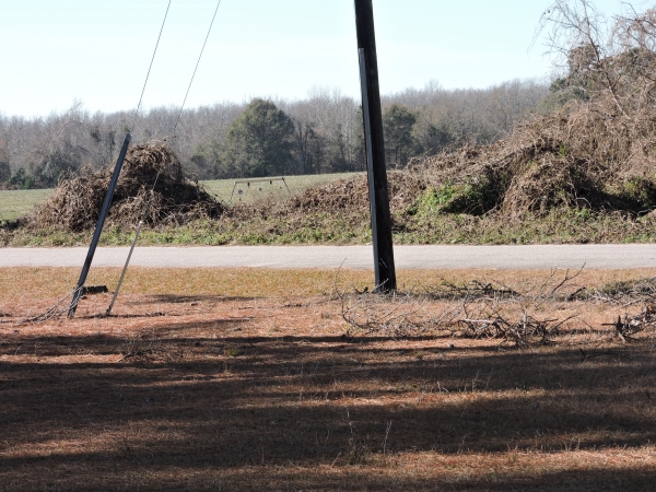

Way out in a pasture on the other side of a County Road next to my house, there's a power line exactly 109 yards from a picnic table where I have my morning coffee. It's a rock solid spot to shoot from and on still days I can't resist bringing along my MK1 .25 Wildcat to pop the pigeons and starlings that land on those wires or the power pole. Off of a bipod with a rear bag, when things are really going my way, it's not that hard to bring down 65 to 70% of the ones I shoot at. I've done better on a few days and I sure as hell have done a lot worse but I've learned that there's a small window of opportunity when it comes to super long air rifle shooting. When that window's not open, I'd just as soon save them the pain and suffering of a wing shot or a gut shot and focus on something a little closer.

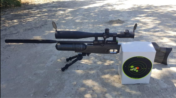

Cothran .308 100 yards with 110 gr hp from higharchunter. 1-20 twist tj, very consistent shooter.
Is this accurately?
I thought so then. Went out the next day for a better group though.

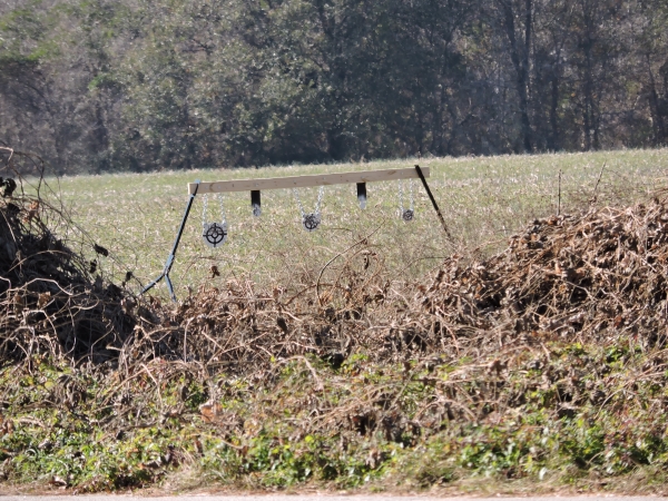

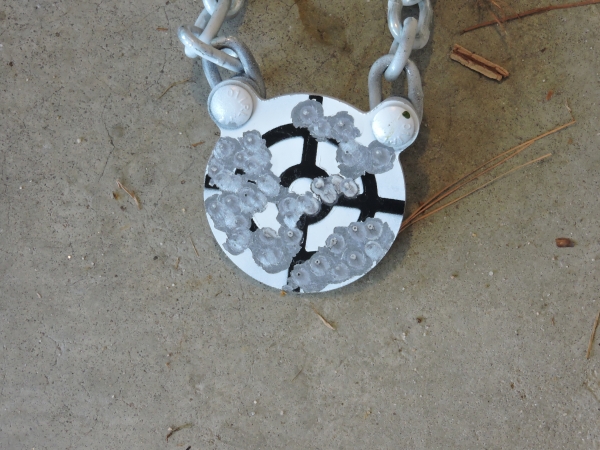

Sub MOA at 200 yards with a stock .25 cal. Cricket pleased me. I just wanted to see how far slugs could maintain stable flight and accuracy out of a stock PCP. Domes won't do that for me at 200 yards.

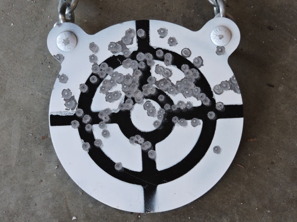

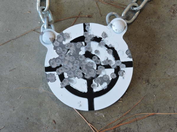

200 yards in some swirling gusts with a .22 caliber FX Crown shooting JSB 18.13 grain pellets on a 3" round steel plate. Didn't bother shooting for groups, the wind drift at that range would be ridiculous and there is no way it'd look like anything good. If you gave me ten shots I would have been able to dust a golf ball though.
Not quite sure what the whole shooting golf balls thing is about, but if that is a standard I guess I ought to get a 1-3/4" steel plate and see how far out I can ring it.
Generally though I just shoot at 100 yards and can print groups under 1MOA if the wind buggers off.
I don't mean for any of this to sound like bragging, certainly it all looks pretty feeble compared to some of the things posted above, but I hope it adds another datapoint for your question.
