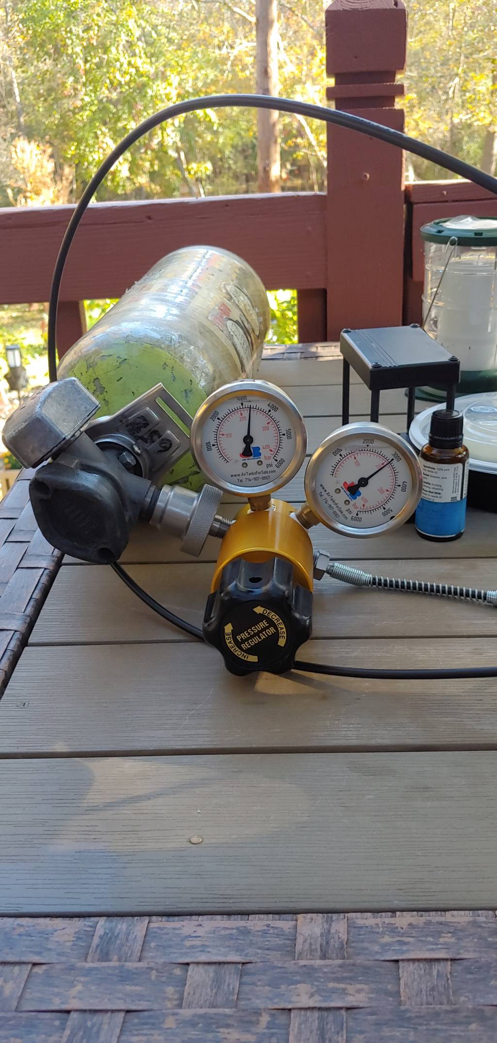

The unforeseen cost would be the regulator for $500 from airtanksforsale.com to have my scba bottle tethered to the rifle. Is tethering what most Texan shooters are doing? Or is there some type of work around. I have the typical Scott 4000 psi SCBA tank and refill my own tanks. I'm wondering how many shots per fill is not tethered?
@Rodjava. Great choice. Do some bbl prep work (firelap), slug the bbl and get a sizing die. Lube your slugs and get trigger time . A good reg that that will hold 5 fps is needed. My setup

I'm now researching the different SCBA tank regulators. There seems to be 2 different types at 2 different price points. One fellow member suggested that I won't need to tether at all. I would like to hear your experiences with either regulators if possible.
https://utahairguns.com/externally-adjustable-inline-pcp-regulator-with-integrated-fillset/
