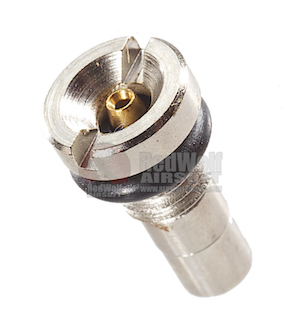

If it uses green gas, there will be a tiny nipple type valve down in the fill port that looks like this.
You may need to shine a light down into port to see it-
Scroll up to post #5 and zoom. It was hard to get a picture. I tried two good fitting screwdrivers to unscrew the fill port but it was gorilla tight and I didn't want to marr the slots so I quit. Did those green gas bottles make any real pressure? Seems like it would be kind of anemic. I even pulled the butt pad just in case it held a surprise but nothing.
I zoomed and looked. There's definitely something down in there, but I can't say for sure. The valves in various guns are usually 1/4" deep so they're hard to see. Green gas is capable of producing pressure and velocities similar to C02, depending on the gun.

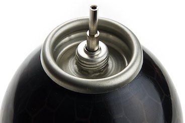

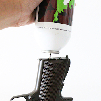

The way it works is fairly straightforward. Find the fill port and press the tip of the gas bottle into the port and hold it until gas starts to vent back out bottle tip, indicating the reservoir in the gun is full. The tip of the gas bottle and the fill valve in the gun are both spring loaded so when you push them together both valves open allowing the gas to fill the reservoir. Like re-filling a butane lighter.
Here's what a typical green gas bottle tip looks like, and a demo picture of a green gas powered pistol being filled-

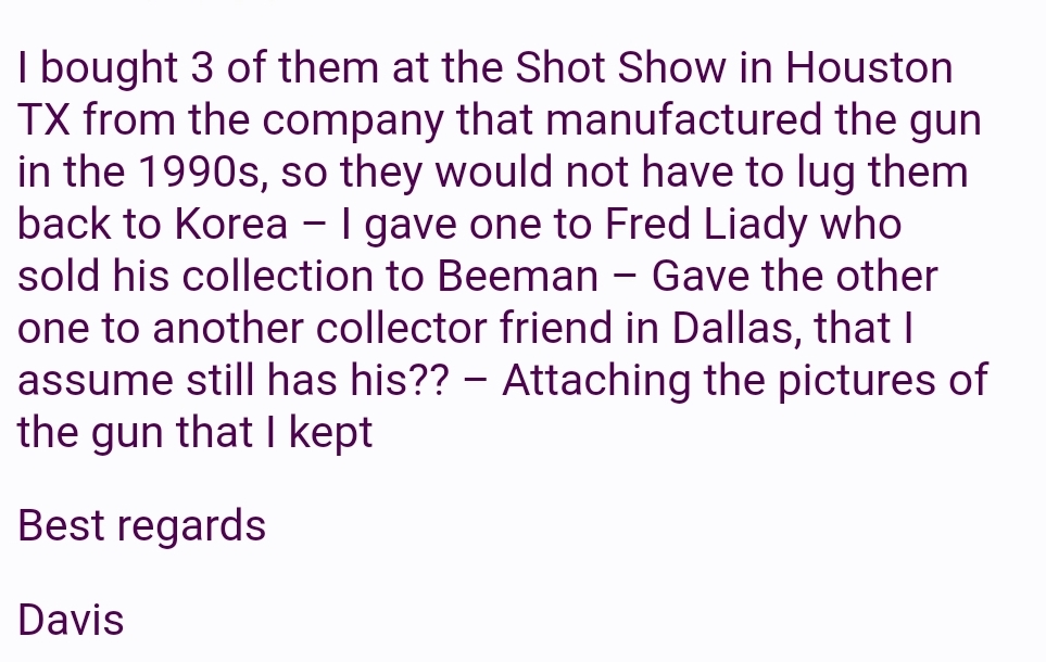

This from Davis..
(Oh, he also said it's a 3000psi pcp)
