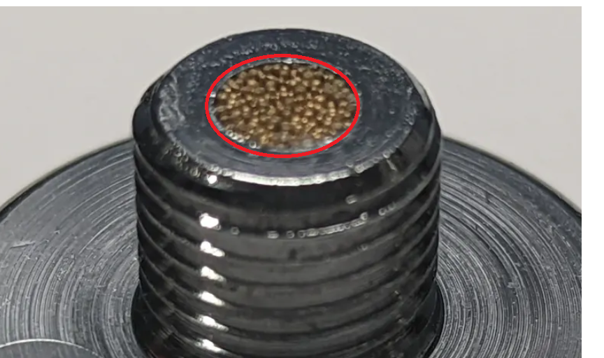

I’ve got air leaking thru my gx cs2 pump from the gauge area. There’s a gasket that goes there by I notice the brown part here isn’t in my guage. 1 how do I get that piece or am I going to need a new gauge?
That appears to be an integral snubber. It’s tiny pieces of (I think) sintered bronze packed in a cylindrical area. It dlows air down so that it doesn’t slam/shock the bourdon tube in your gage. They also act as a filter.
