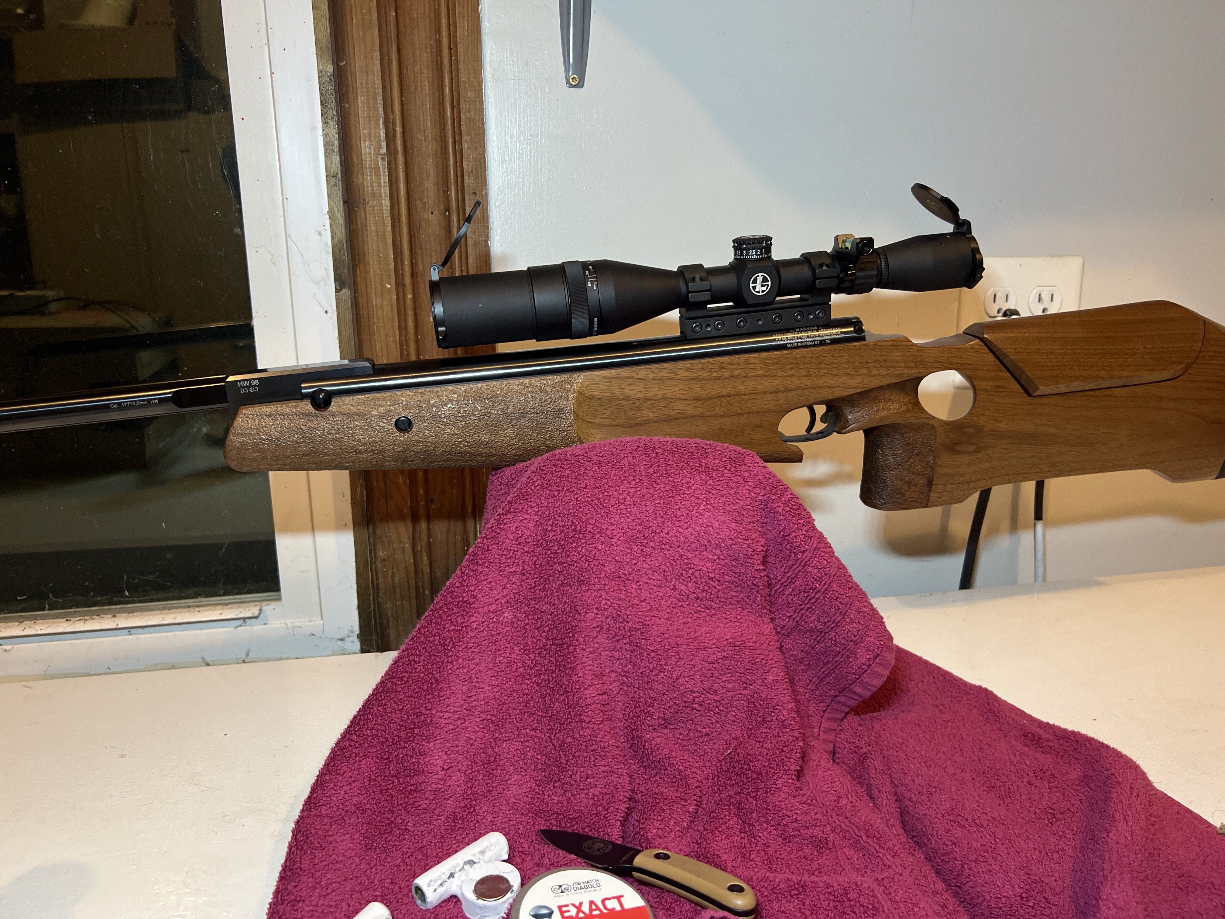

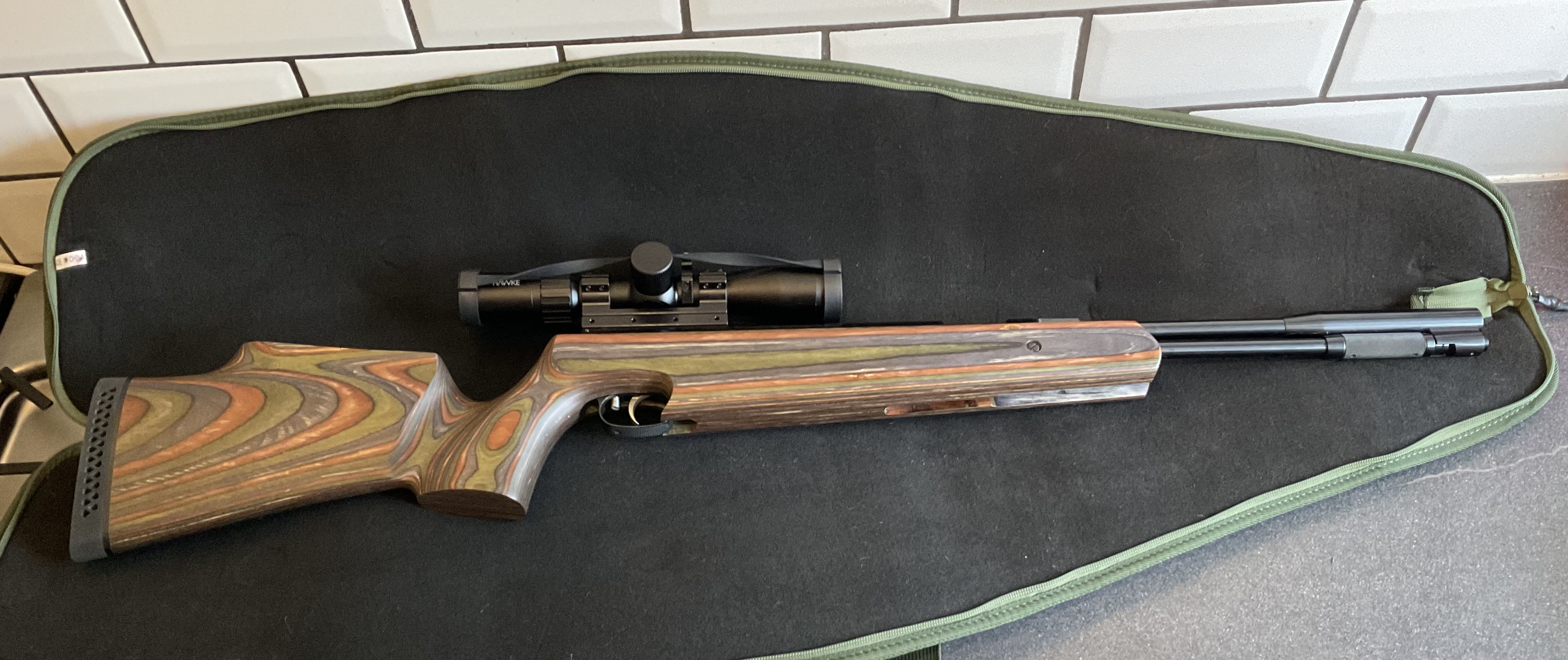

I found my one and only. If I had to have a one and only, that is. She’s a .177 Weihrauch HW98 doing 13.5 fpe with 8.44s. Vortek PG4 spring kit, Rowan setback trigger blade, and a Leupold 4-12 AO inside a BKL one piece mount(droop compensated) round her out nicely. She regularly shoots dime sized 5 shot groups at 30m and is ergonomical perfection for me.
