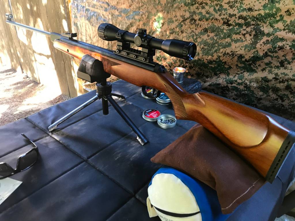

The number one slammer in my lineup is the Hatsan 135QE in .22 and .25 caliber. The 135 .22 caliber launches the 14.3 grain Crosman Premier Hollow Points over 1000fps. Very accurately also. Nothing else even comes close. Shown with a dot sight. Total weight is 9 lbs/14 oz.

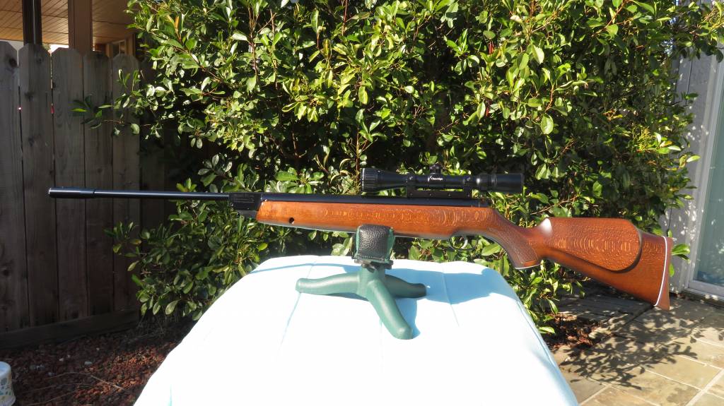

This is my Hatsan 135 in 30 caliber, that is with the 50.15 gr JSB's. This Hatsan is very accurate, best part has less recoil. Had this at the Pyramyd Air 2019 shoot. Tom Gaylord had more than a few good words to say about it. My Hatsan 135 in 25 Caliber with a 25.4 gr Air Arms is accurate and shooting over 800 FPS. I have a Hatsan 125 in 22 caliber with 14.3 crosman's shooting over 1000 FPS. The Hatsan's have been tuned by me with custom made parts and new barrels except for the 125. I had several people shoot my guns there and no complaints about recoil. That's my best compliment, to have a powerful air rifle that doesn't knock your teeth out from recoiling.

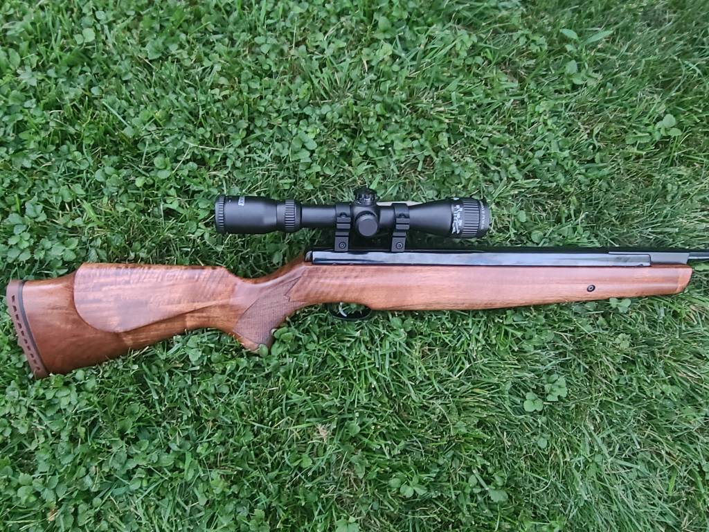

JW80 With the 25 caliber barrel installed. It was shooting just under 30 pounds with the 25 caliber king, I’m going to try the 34 grain for the first time this summer…Incredible accuracy.

With the removal of the two factory 3mm trigger adjustment screws and replacing them with ones approximately 1/16” longer, I have the triggers under two lbs. Could go even lighter but that trigger is holding back a lot of energy. That’s a beautiful rifle you have there and in .25 caliber no less.

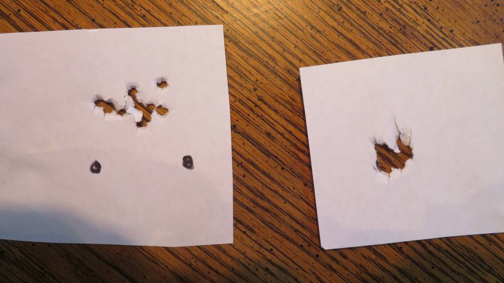

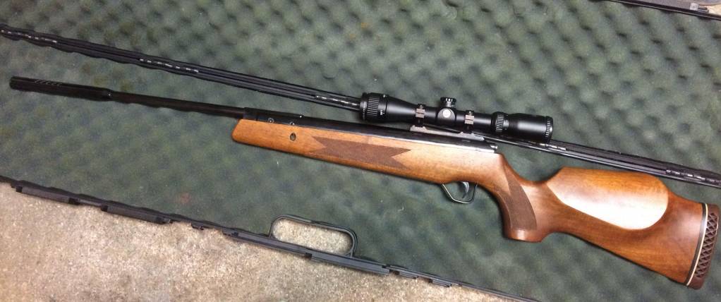

I had a Beeman Kodiak .25. An over bored barrel resulted in poor to mediocre accuracy depending on pellet but it was a hammer. Shot H&N FTT's at 810 fps for 29 fpe. Best group I could manage was 5/8 inch c.t.c at 23 yds. Most were worse.
Here are two 10 shot groups at 23 yards. The group on the left was fired using conventional spring gun wisdom, the group on the right was fired using a very tight grip with both hands and pulled hard into my shoulder. It was a real PITA gun!

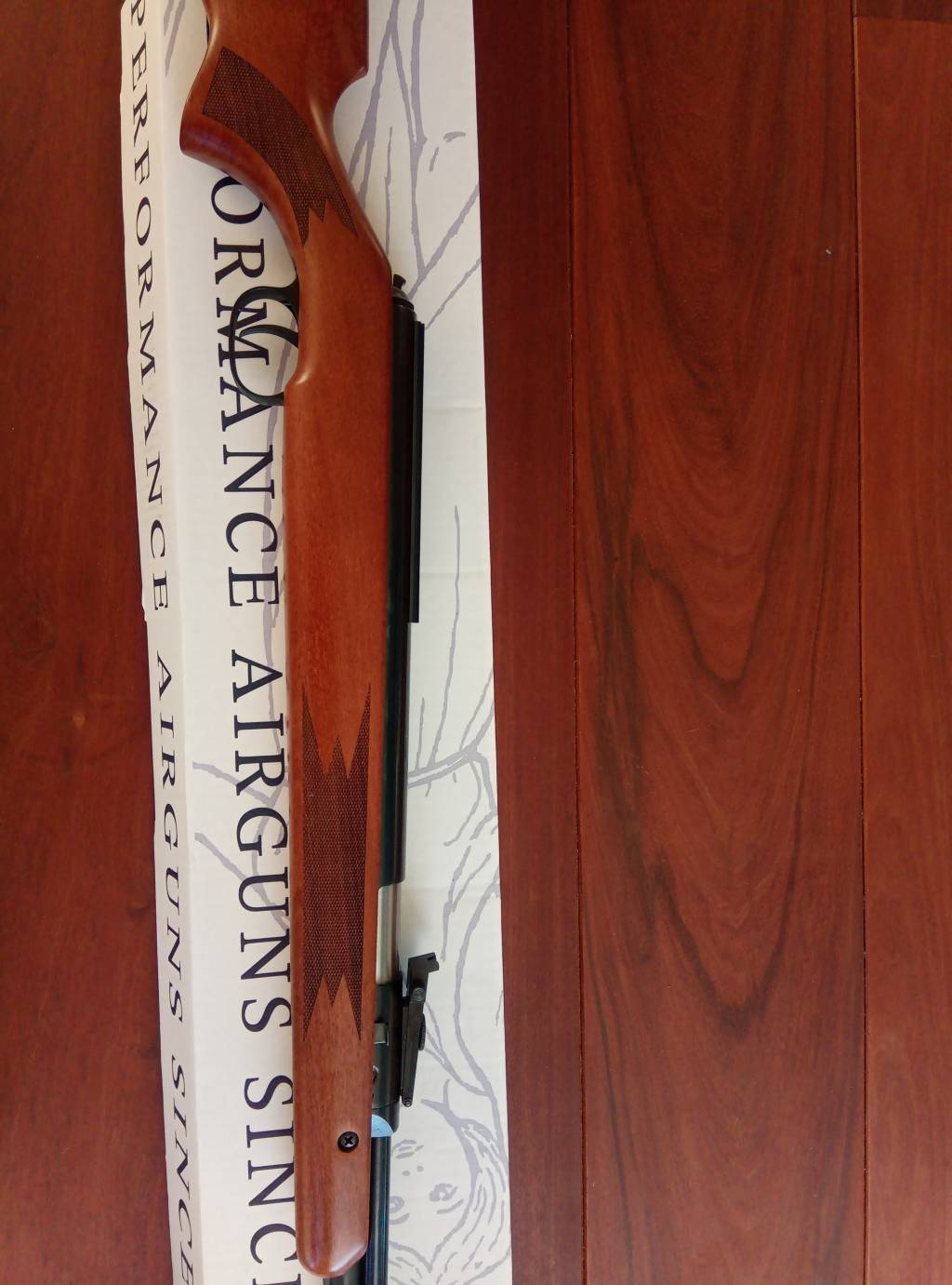

Definitely not the fastest but this boy really hits hard (135 Carnivore in .30 caliber, also the only springer I own at the moment) This is the original spring piston version, I've got some powerful break barrels but they're all running on gasrams, my favourite and winner in speed and accu is my Weihrauch HW90

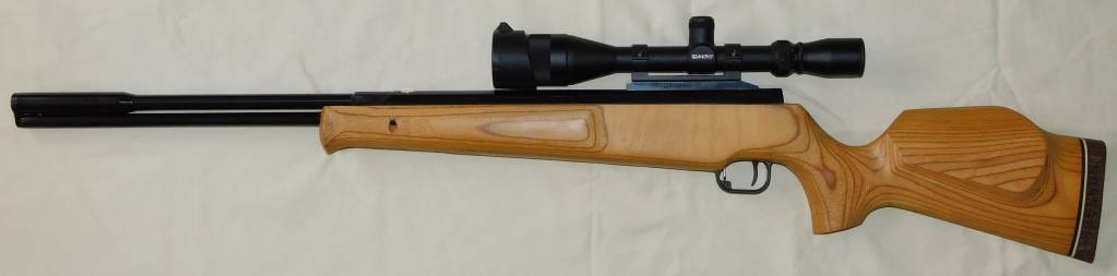

My HW90 with a 30mm Vortek Vacuseal, and the ram charged to 26 bar, sent a 9.56 grain .22 H&N FTT green downrange at 1305 fps (36.1 fpe). A Crosman Premiere flew downrange at a more 'sedate' 986 fps (30.9 fpe). And the sound curled my hair!
LOL - I almost blew the back out of my backstop. I had to change out the final 3/4" ply piece and more rubber mulch in it. The higher velocities go right through regular 3/4" plywood.
I recently swapped out the full length barrel for a HW95 carbine 410 mm barrel, both in .22. The carbine barrel delivers almost exactly the same performance. It cuts about 4 ounces off the gun weight, to under 9 lbs.
I have a .25 barrel. Should try that. This HW90 is really just a test-bed. I have not sorted out the accuracy issues, and the high power is not comfortable. It'll probably end up around 18 bar, 800 fps. But I like the Primary Arms red dot and the carbine barrel.
