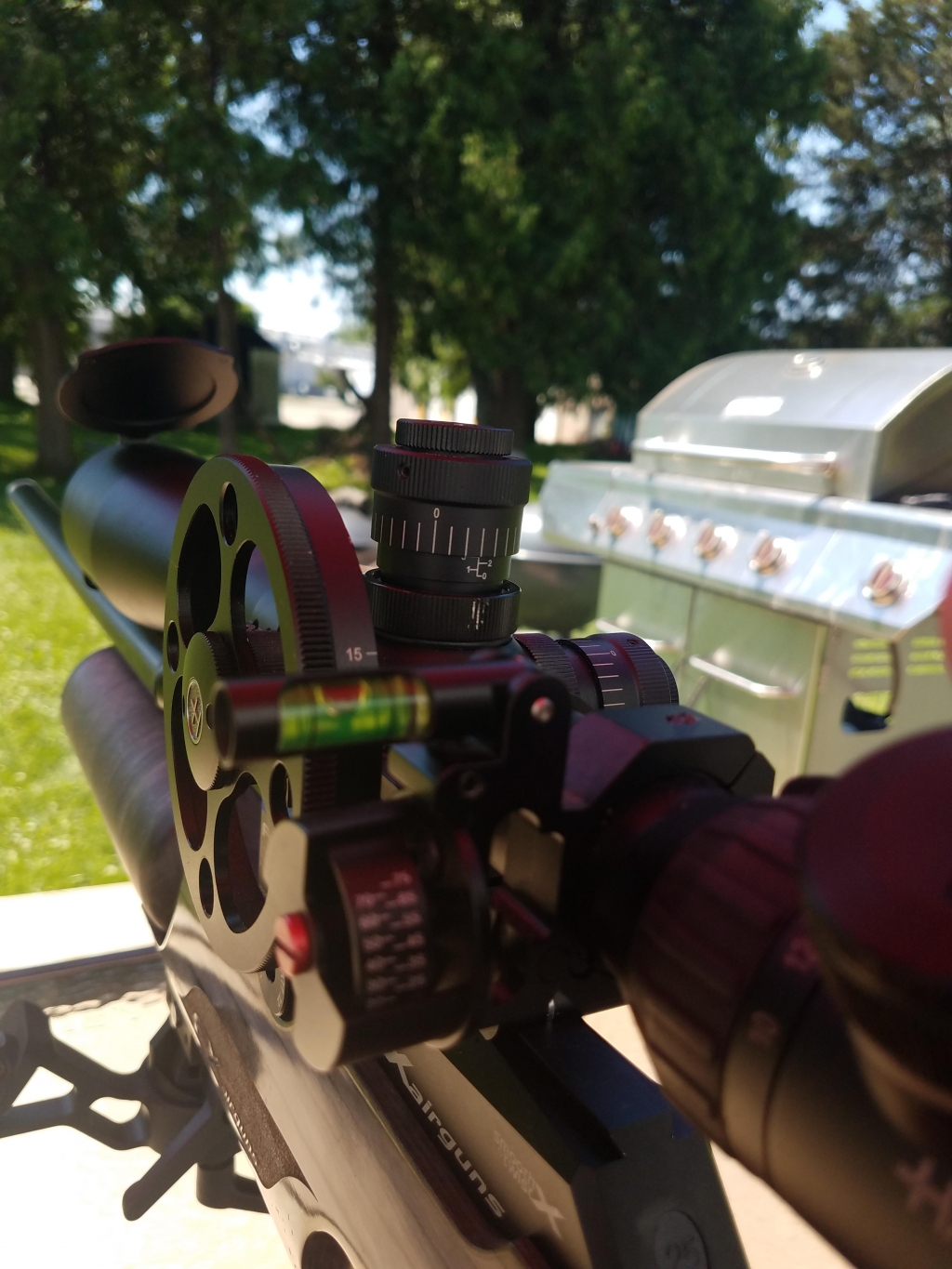

The wheeler anti can’t swing out is all I use, on all my Airguns and powder burners. Simple stuff.
Mr. Grimm, I know what your talking about. I had to fold in and snap back out a few times, till I found a happy medium of where it’ll level out “most” of the time. You ought to get another one and re try. Maybe you got one that just wasn’t put together right from the factory.

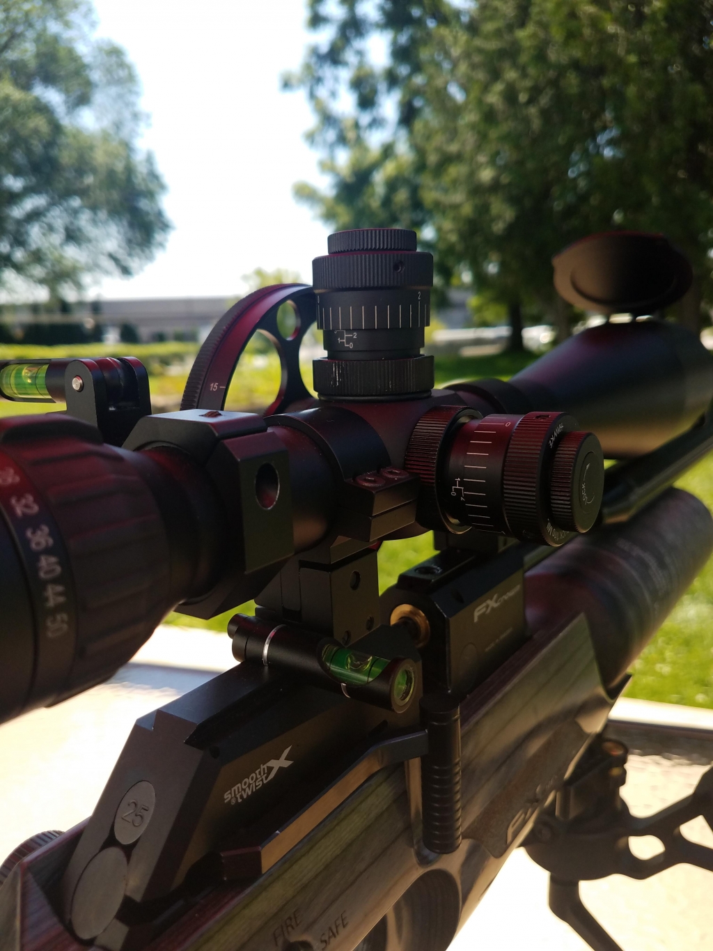

i recently bought the cheap picatinny style anti cant levels that you mount on your scope rail. I bought it not at all for using as an anti cant, but for checking to see the differences in level to the three items below during a scope mount session-
1. tops of the bottom halves of the scope rings
2. Top of elevation turret, or at the base of the turret(some scopes have an ample space flat landing at the top of the scope)
3. And lastly, to compare it to my anti can’t level when all set.
What I found so far on one gun, my Bully, goes in line with what Nervoustrigger has said all along, and that is to not trust your scope rail as a point of level @ side to side. My scope rail was way off when compared to items 1 thru 3.

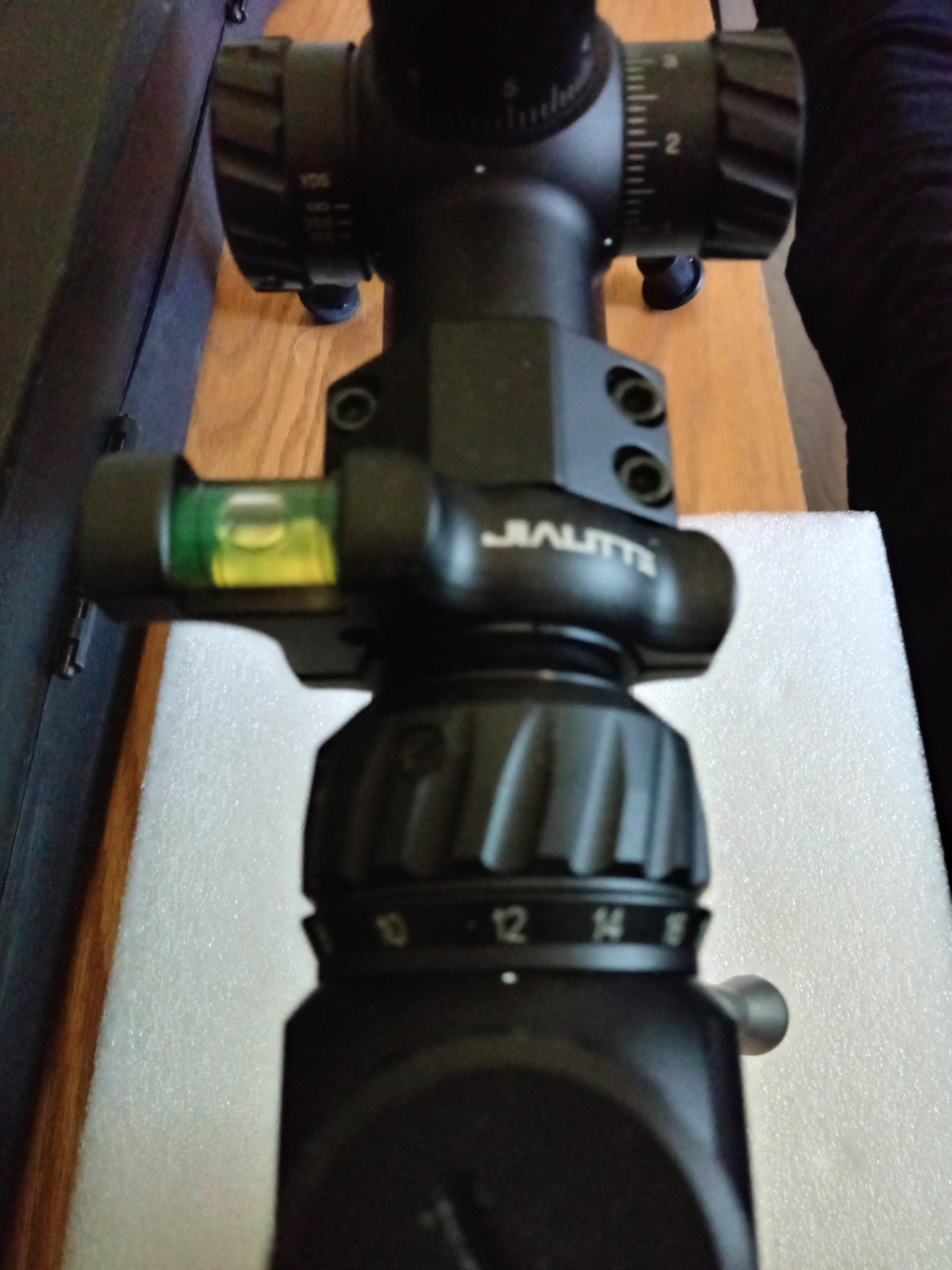

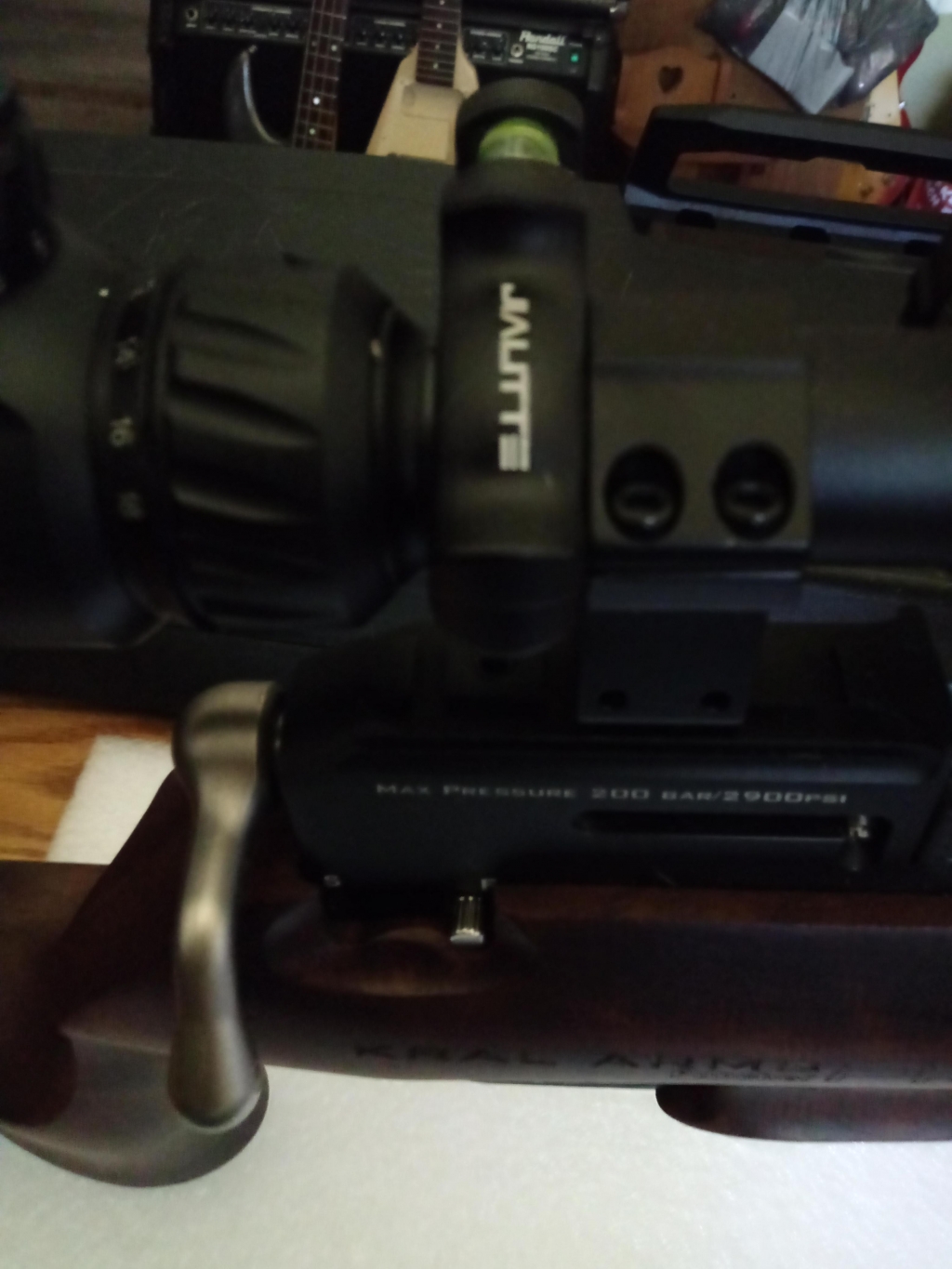

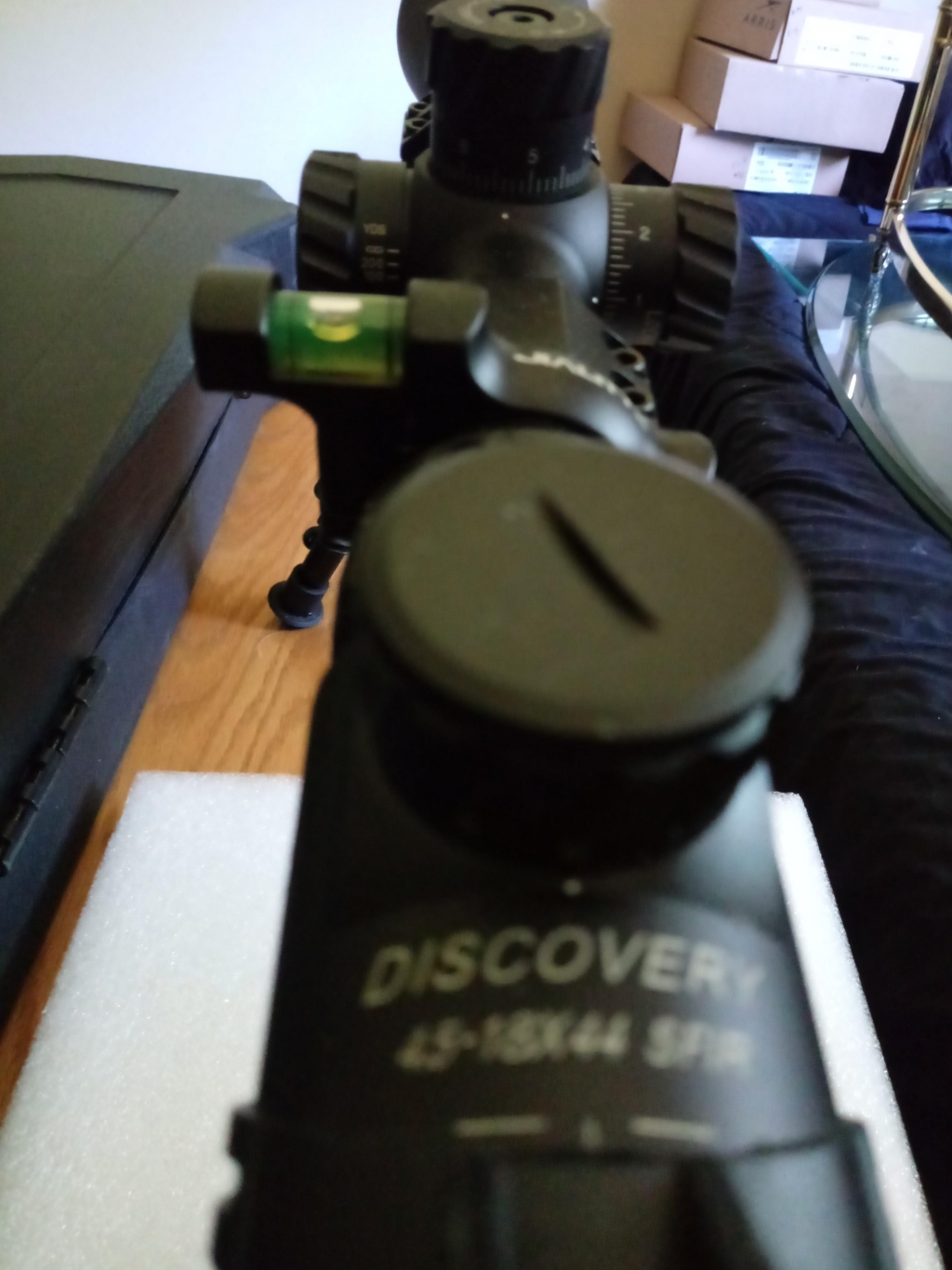

I just got this over the weekend on advice from @jwrabbit123 - aside from being extremely well made, the benefits to this one are up to 1 degree of can't detection (the level is curved) and the ability to add a tritium vile behind the level for illumination:
I've had several of these over the years and they always seemed to be a little more accurate than a simple bubble.
I put one on a gun about a week ago. Same recommendation. My crappy eyesight makes it hard to see in most lighting conditions though.
