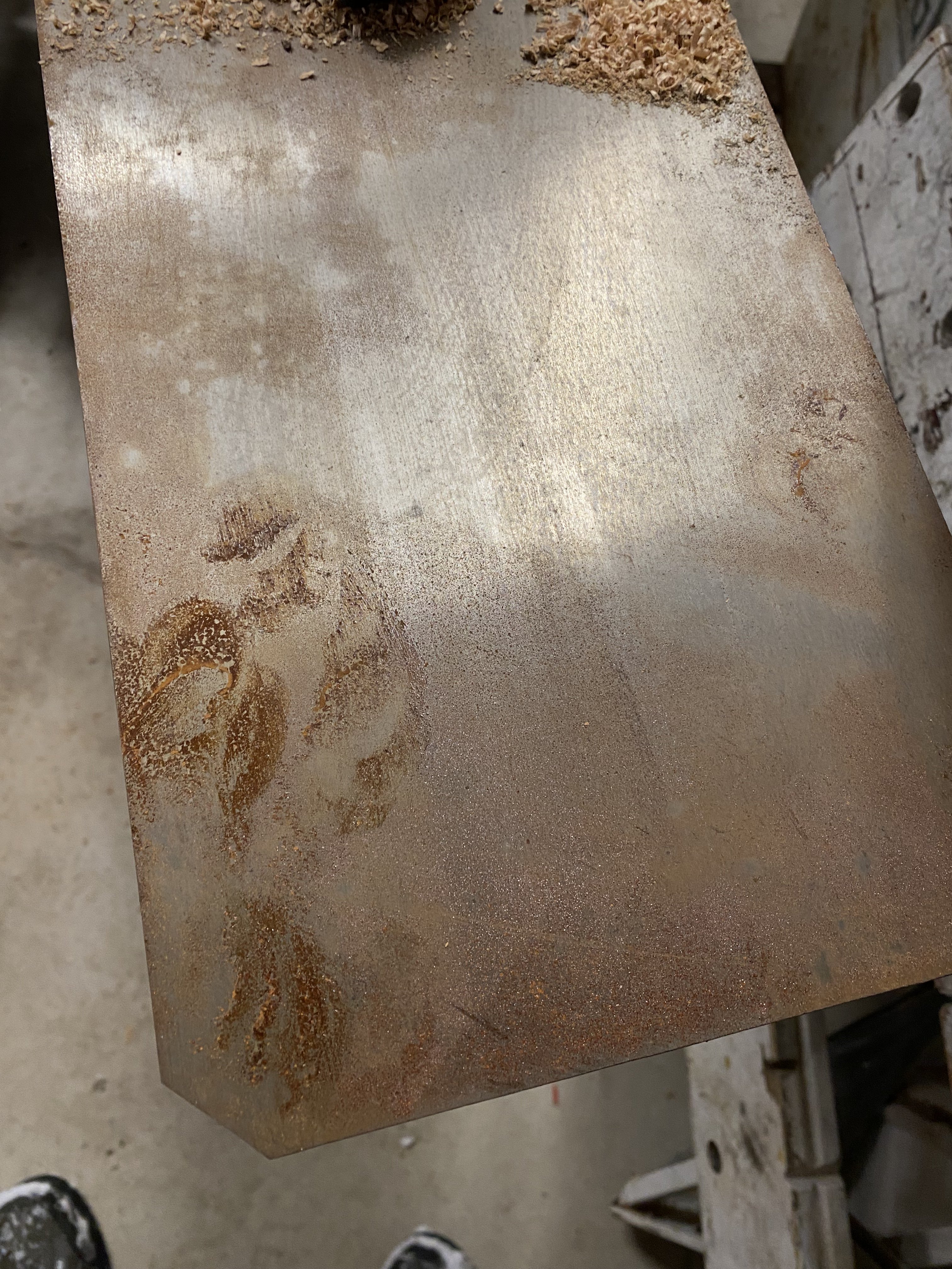

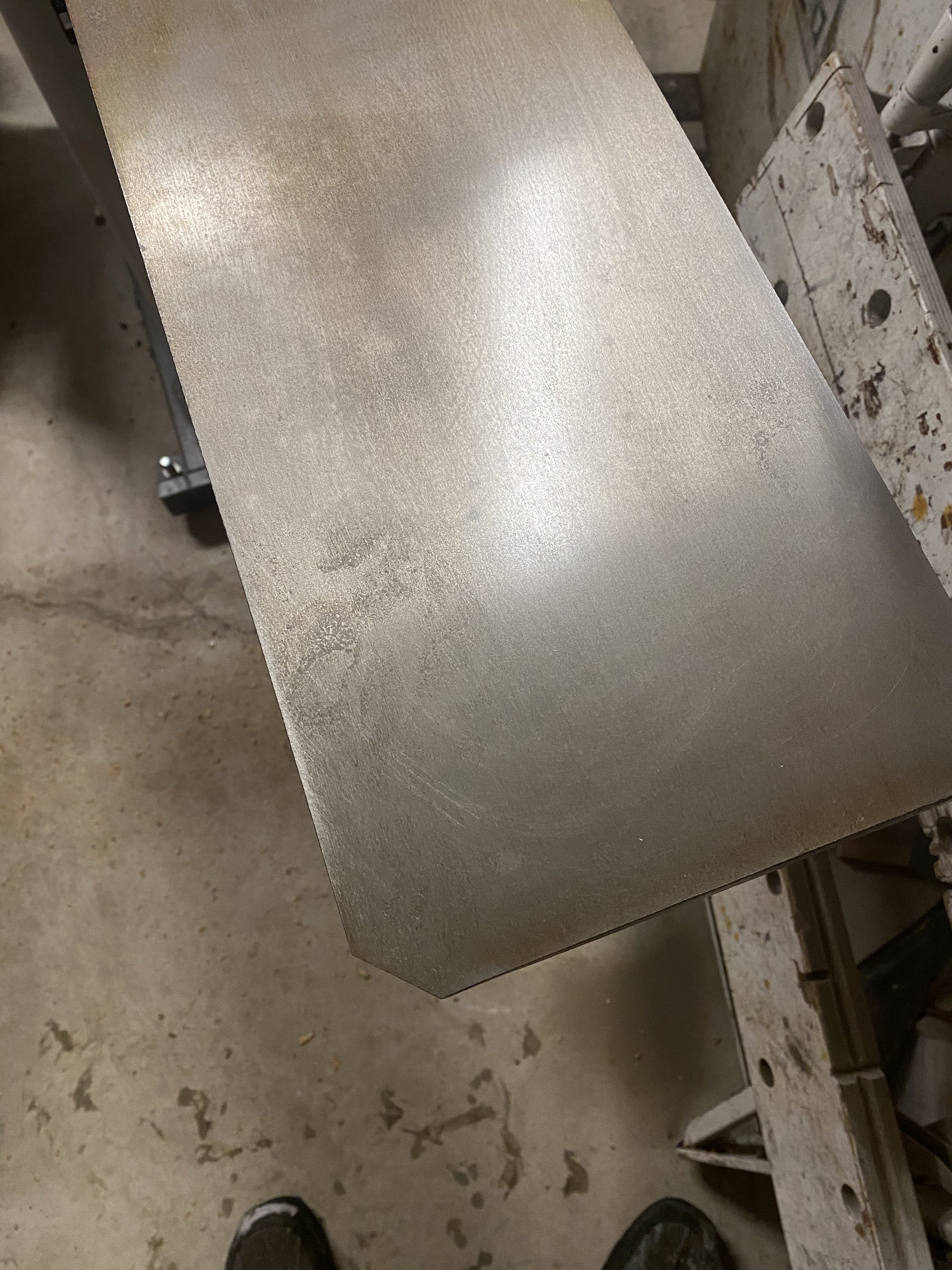

Used the Frog, and it smelled clean. When I first got it was in a plastic bag, when I broke the seal, bad. Using it was nice. I rubbed it on the surface of my jointer and it cleaned. This is before 0F79829D-6055-4CD9-9D92-1F99173EF319.jpeg Rubbed Frog in a second time removing more rust. I gave it a rub with this Griddle block. F972ECFB-9462-4F1F-9A71-7628A103E237.jpeg and then more Frog. 4-5 min. tops. C5BBD6E7-0F92-4E76-8AB5-3B1B4D5E24E8.jpeg. I’ll watch for any change for next week or two.
