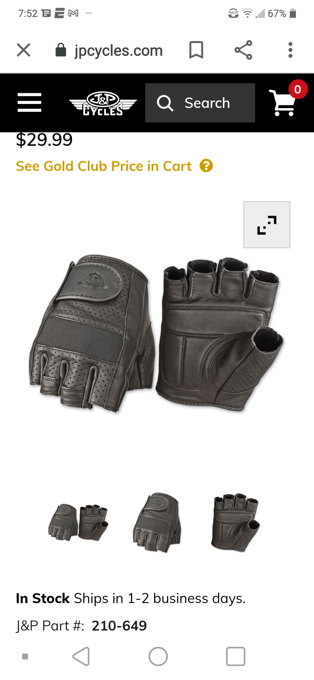

Thanks hawkeye and shambozzie. I'll try those out. I just ordered a bunch of different sizes and brands and will have some fun finding out what they like best. I got a zoraki blister on my thumb from pumping it too much! Hah - I'll have to stick to the 1701 for now. Appreciate the tip on the 8.4 jsb's. I'll give them a shot. I normally don't shoot a lot of groups either, but I want to make sure I can give these stupid squirrels a lead Q-TIP accurately in their earholes or eyeballs depending on the angle (especially with lower calibers)!
@Pizzaman2976. This is my cure for The Zoraki sore hand blues. Works for me.
