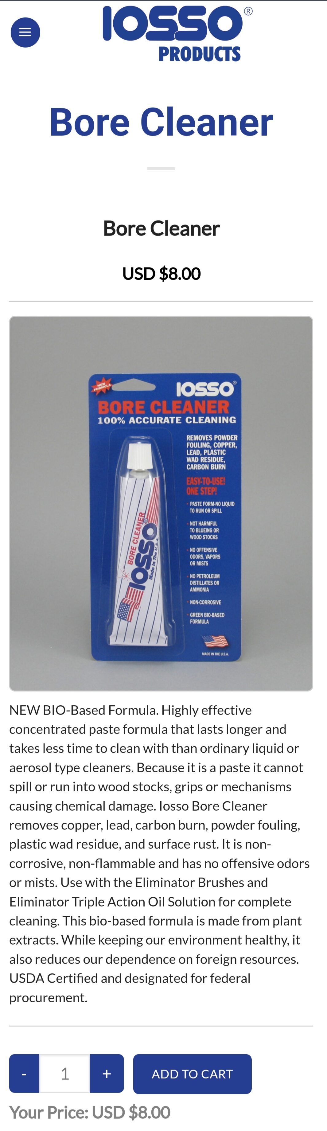

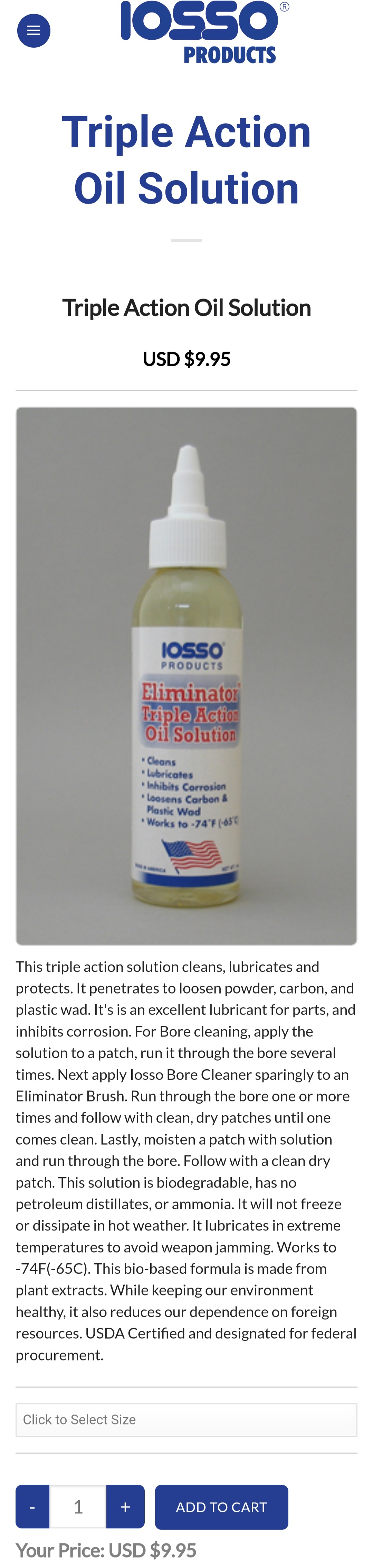

What lead removing solvent gave you the best success?
This what I have been using, little to no odor, cleans thoroughly and seems to keep the bore cleaner longer.
I believe it improved accuracy a little bit.
