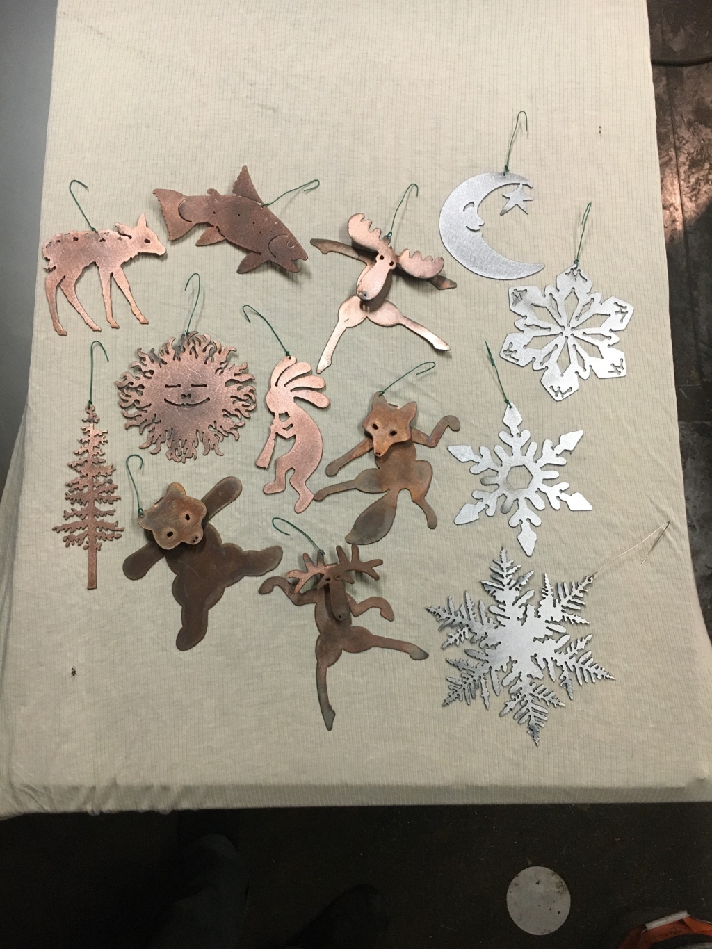

Plasma cam is pretty easy to use, I have no background in computers but I’ve been able to get by. It’s fun to turn your designs into reality. Not sure how much they cost these days, but if you go for it ask them about the upgrades. You for sure want advanced height control. It costs more but totally worth it. Hypertherm powermax is a great choice for the plasma cutter. Here’s some stuff I cut. You will be able to make targets with ease. They have a good system for support at Plasma cam too and you can call them for help. Totally amazing machines...go for it Nate!!

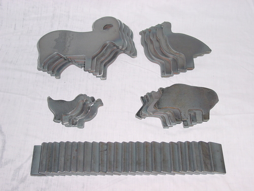

Hey guys, I want to produce targets so I'm looking at getting 100's of the same few pieces. Definitively, I can't do anything by hand. Water jet service or a Plasma CNC sounds good. I wonder how cheap I can get a CNC Plasma cutter. It has to be a clean edge. Like this:

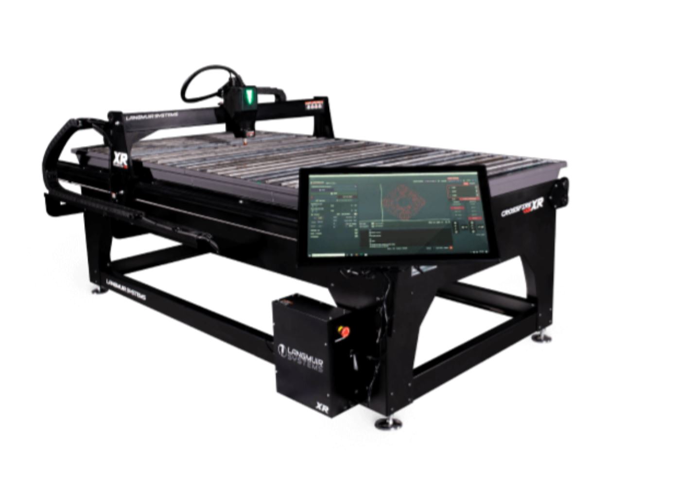

I bought this for $8k....still need to unbox it. https://www.langmuirsystems.com/xr?...j1pcshZztCBL6hgdvU1xhye0pqTSFQwRoCB7QQAvD_BwE

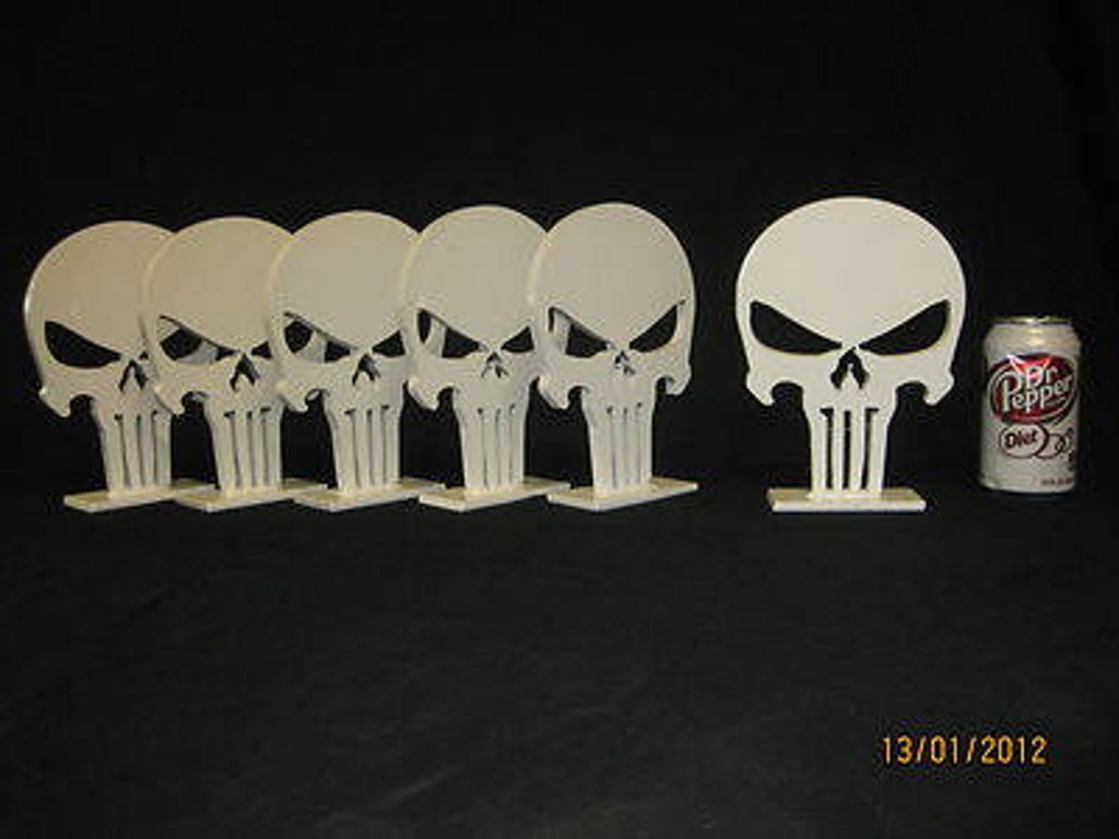

Hi, I was wondering if anyone could tell me what machine is used to cut small shapes out of hard 1/4 in steel. Like the pics below. Thanks -Nate
